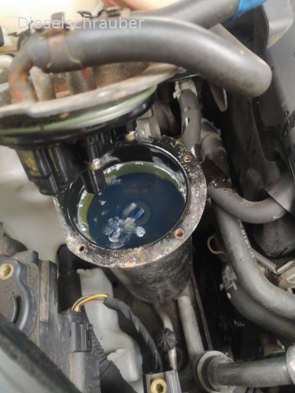

Post26-11-2022, 10:03    Subject: 2.0 TDI CBBB: Engine Stalling & No Start? Quote
Sure, here's the translation:
"For documentation purposes only."
An error has occurred again. This time, the vehicle drove normally to its destination and then failed to start when the driver tried to restart it.
Date: November 15, 2022.
Mileage: 325,130 km
Fuel level: approximately 20 liters below full.
Checked: Error memory in the control module (MSG) is empty; Diesel filter housing opened before attempting to start the engine - it was full but otherwise appeared normal.

Post26-11-2022, 19:48    Subject: 2.0 TDI CBBB: Engine Stalling & No Start? Quote
Hello.
Once the vehicle starts again, does it run normally, or do you see something like white smoke?
Create a log if the engine fails to start. Record the following values: measured air mass, RPM, and fuel injection quantity.
Translated on 07-08-2026, 16:00.

Post26-11-2022, 20:01    Subject: 2.0 TDI CBBB: Engine Stalling & No Start? Quote
I didn't pay close attention. The vehicle was parked on a small side road in the forest, where the air doesn't circulate as quickly. He didn't smoke heavily; otherwise, it would have been more noticeable. I will be more careful next time.
