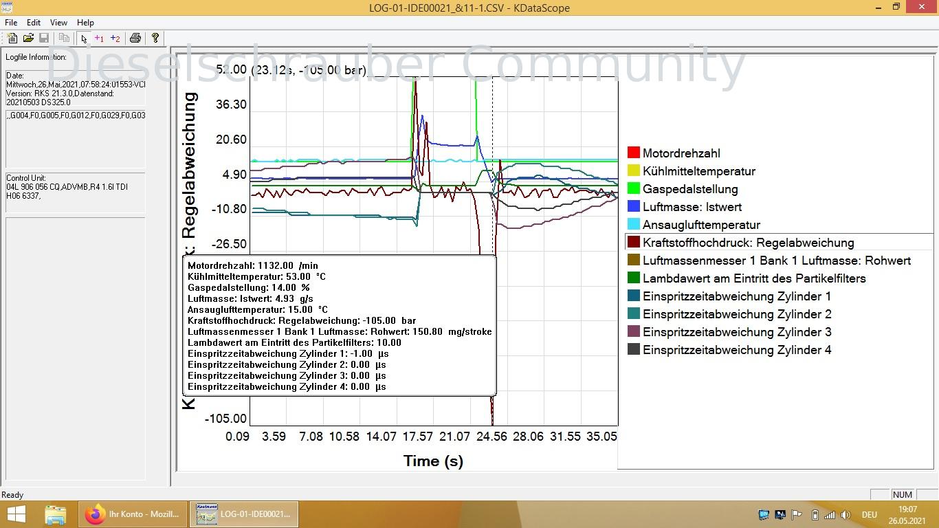

While the injection times vary, in the 2nd. Log seems relatively normal to me.
What immediately caught my attention was the deviation from the standard fuel pressure regulation.
Please check the wiring and connectors for the fuel pressure sensor and, while observing the log, pay close attention to the setpoint and actual value, and whether the jerking that occurs during a drop in the actual value is present.
Best regards, Rainer

Post26-05-2021, 18:31    Subject: Octavia 1.6 TDI CXXB has jerky movements, clunks, and intermittent failures. Quote
Thank you, Rainer. I will check it tomorrow.
However, in the 2nd log, it ran normally. It was already warmer at that point.
