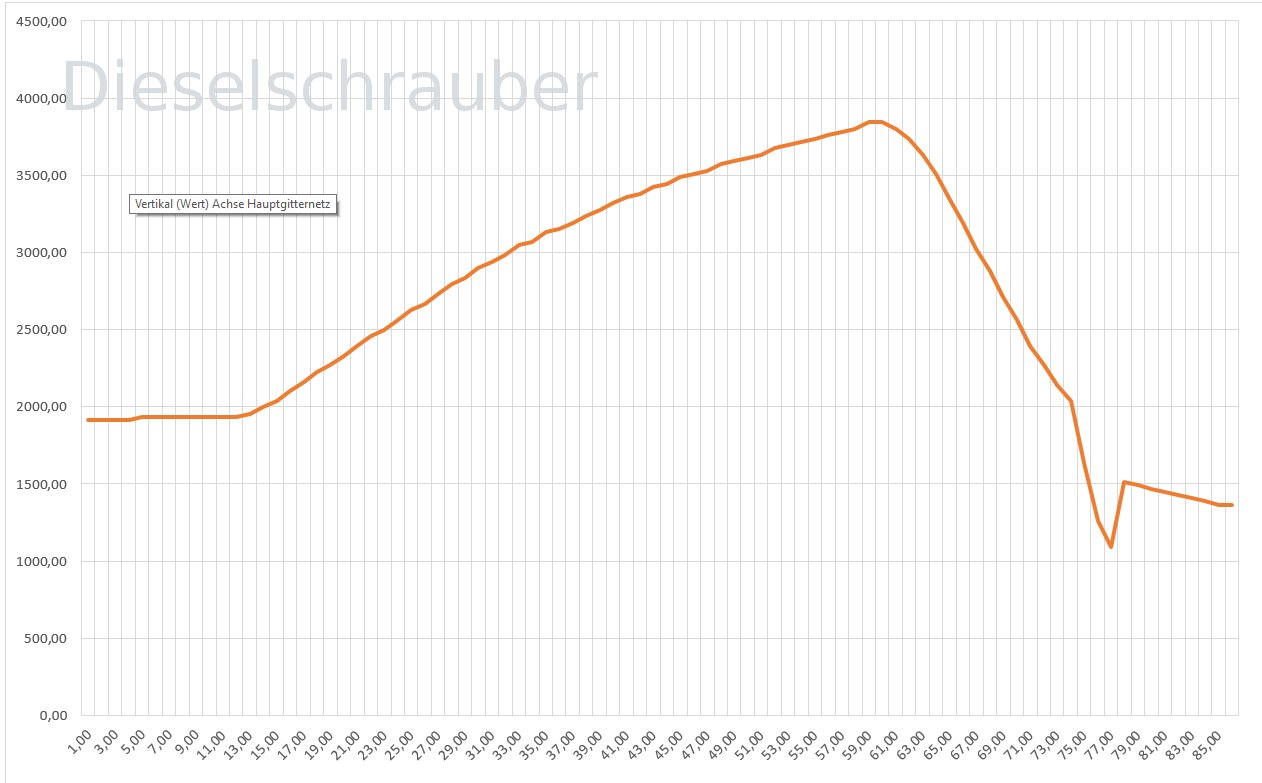

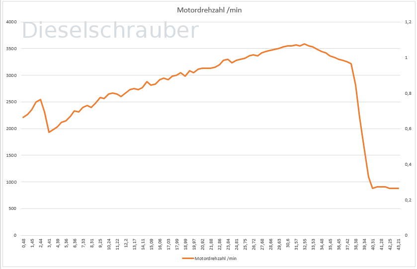

Hello
The engine's RPM fluctuates somewhat, which is different from previous measurements that I occasionally took. For comparison, I have attached two screenshots: one showing a greater fluctuation in RPM, and one from a previous measurement without any issues. Both in 4th gear at full throttle.
Last week, I also bled the air from the system, from the turbocharger inlet all the way to the engine block. For this, I removed the turbo hose from the filter to the turbo, and attached a printed adapter to the turbo inlet.
Then, using the pressure reducer, gradually reduce the pressure to the system to 0.5 bar. It squeaks in a few places (2-3), but unfortunately, the construction wasn't good enough to really pinpoint the leak.

ok, the RPM drops also occur at low RPMs and, surprisingly, even improve at higher RPMs.
In the event of a diesel shortage (filter, tank ventilation), this would not be the case.
Does the backup pump provide enough pressure? Can it be measured, there should be something about it in the RLF?
"While the intake air might be leaking, the boost control and the limiting amounts are normal."
What are the idle time requirements and operating hours for the PD elements?

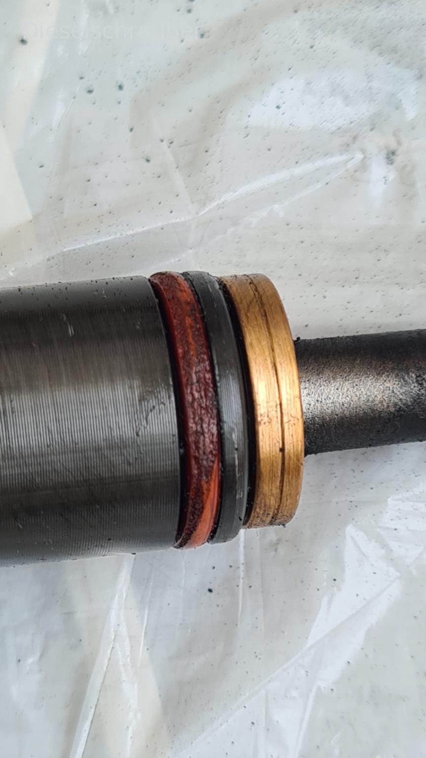

Hi everyone
I have found the error, thank you for the helpful advice and suggestions.
To Error:
I have re-examined the problem statement from the Dieselschrauber perspective and have looked at the timing and quantity discrepancies in the specific case.
In cylinder 3, the timing deviation exceeded -128. Then also put the other two cylinders in the higher minus range (between -20 to -115).
After some research online, I found a post where someone mentioned that the return flow ports in the PDEs might be clogged, and/or the seals of the PDEs might be clogged.
I then decided to try the PDEs icon_confused.gif. (It went surprisingly smoothly and easily)
You can see the results on the images, where two out of the three PDEs had seals in place.
I then replaced the seals (three O-rings), the brass disc, and the plunger (is that what it's called?).
Then, using a brass brush, I carefully cleaned the nozzles of the grime and then reassembled everything, lightly lubricating it with motor oil.
After a while, the engine finally started, and the measurements showed values for all three cylinders between -22 and -64.
The car is running smoothly again, without any jerks or problems.
I think I'll still replace the diesel filter, because the deviations aren't moving in the right direction.
