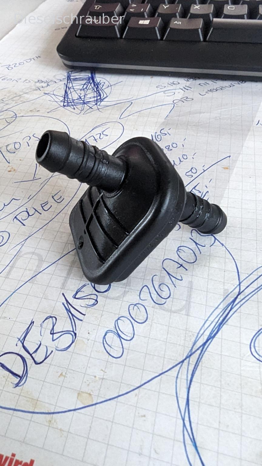

Post31-08-2023, 21:05    Subject: It's working again Quote
This afternoon, I found the problem. This component is located between the electric pump on the injection wall and the high-pressure pump, and it contains a metal filter. I can't find this part in the parts catalog, and it's not shown on the exploded diagrams for this vehicle. This part is also not installed on the comparison vehicle, which belongs to my wife. I removed the strainer/filter, inserted a 10mm pipe as a connector, and the car is running, and the pump is making its normal sound.
 P0087, Fuel Rail Pressure Too Low, Cayenne

Post01-09-2023, 7:55    Subject: P0087, Fuel Rail Pressure Too Low, Cayenne Quote
If this filter was clogged, it probably fulfilled its purpose.
If I understand correctly, this filter is located on the line coming from the tank, after the pump and before the injection wall, and before the actual fuel filter.
A part number is likely not imprinted. What does the Porsche parts department say?
Can the filter be cleaned?

Post01-09-2023, 15:22    Subject: P0087, Fuel Rail Pressure Too Low, Cayenne Quote
It looks more like it was installed later... or does it have a VW part number on it?

Post01-09-2023, 16:19    Subject: P0087, Fuel Rail Pressure Too Low, Cayenne Quote
Rüdi wrote:
It looks more like it was installed later.....or does it have a VW part number on it?
That's also interesting. Was that part installed while the machine was running, or was it inserted into an opening in the spray shroud?

Post02-09-2023, 8:53    Subject: P0087, Fuel Rail Pressure Too Low, Cayenne Quote
Ralph75 wrote:
Okay, I'm back again. The vehicle is still running in limp mode, but the P0087 error code is no longer present.
Regarding the questions above, the part that is mounted and flies is directly attached, without any brackets or similar components. It has a VW part number, 059130511a.
It's constructed like a filter for a range hood, with two metal grids positioned diagonally on top of each other.
I decided to install a MANN WK32/7 filter with the appropriate 10mm hose diameter. It works perfectly, no reports of fuel pressure issues.
