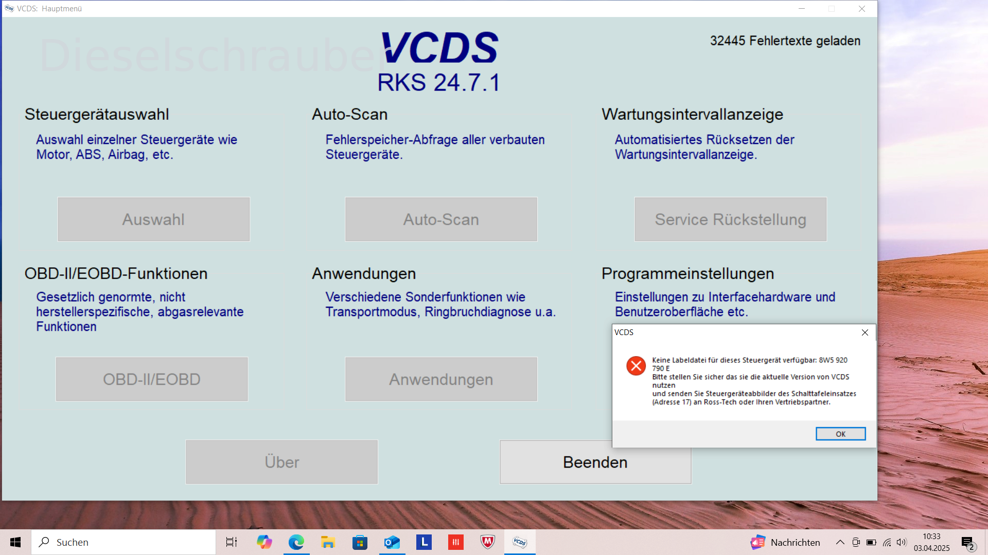

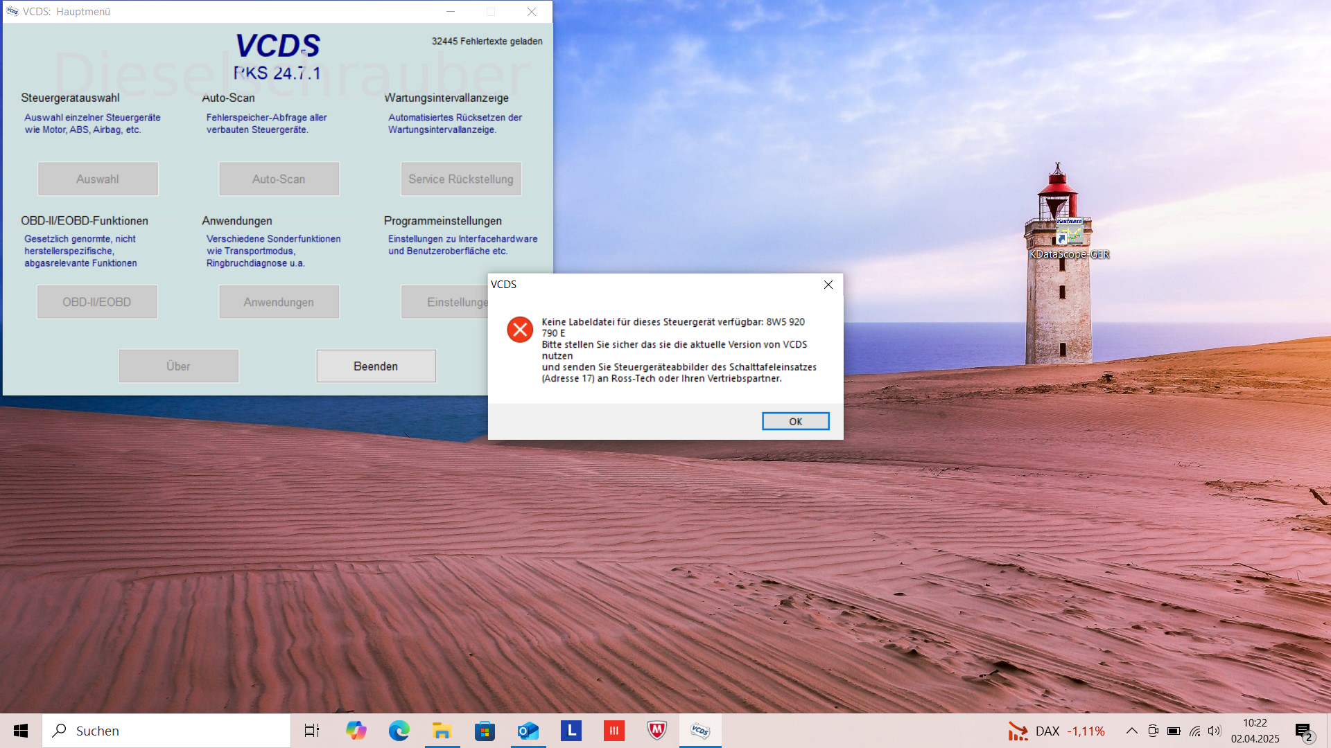

Can someone help me? I recently had the inspection service done on my Audi Q5, which was manufactured in 2019, and now I want to postpone the next one.
I specifically bought the VCDS HEX-V2 because, according to Mr. Kaufmann, the old device doesn't work with it.
If I try to postpone the inspection, I get the same message as with the old device: "No label file available for this control unit: 8W5 920 790E".
Please ensure you are using the latest version of VCDS. I have version 24.7.1.
I would appreciate it if I could get some help with this.

Post31-03-2025, 19:46    Subject: Reschedule inspection for Audi Q5 models from 2019 onwards Quote
Autoscan...
The support from the diagnostic protocol initially has little to do with resetting the system via the adjustment channels.
First, communication needs to work.
Then we can actually do something.
"It's crucial to understand the dialogues and instructions within the VCDS system and to act accordingly."

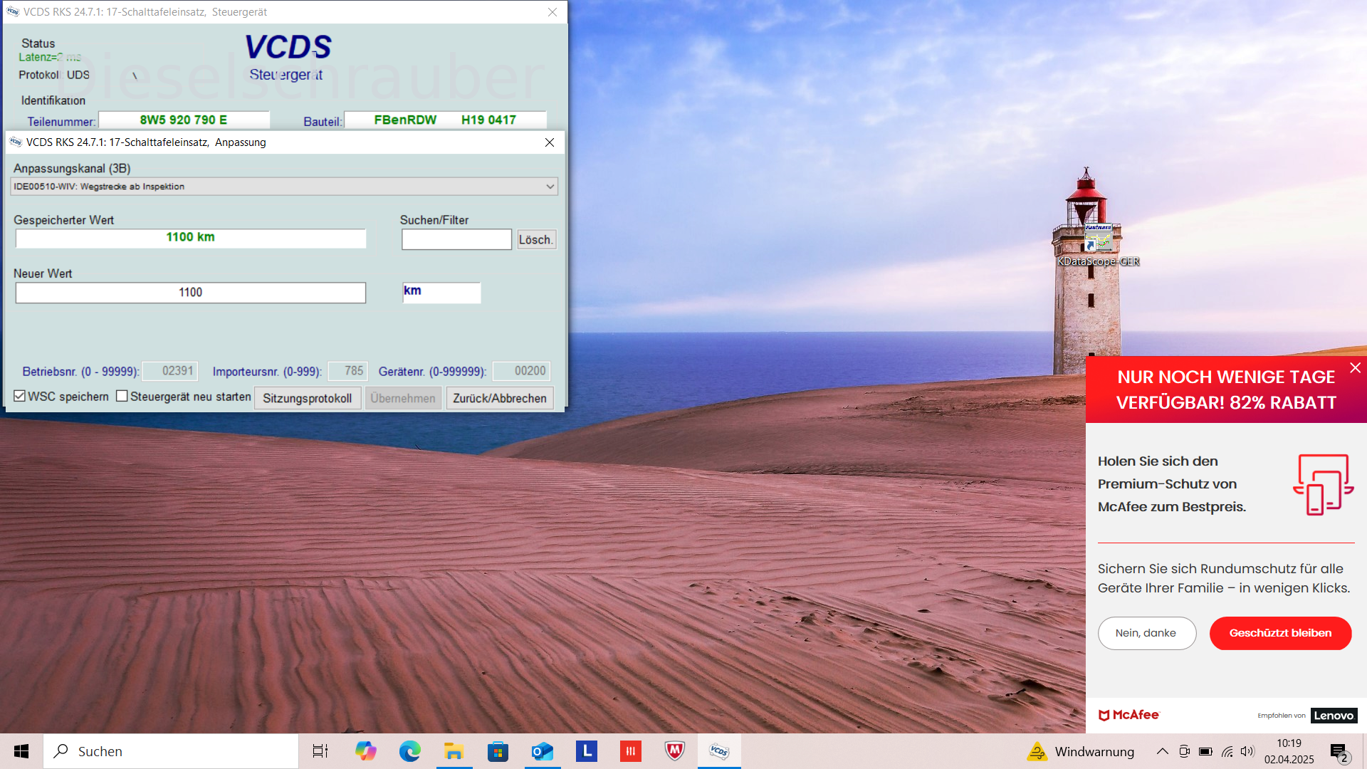

Post01-04-2025, 10:32    Subject: Reschedule inspection Quote

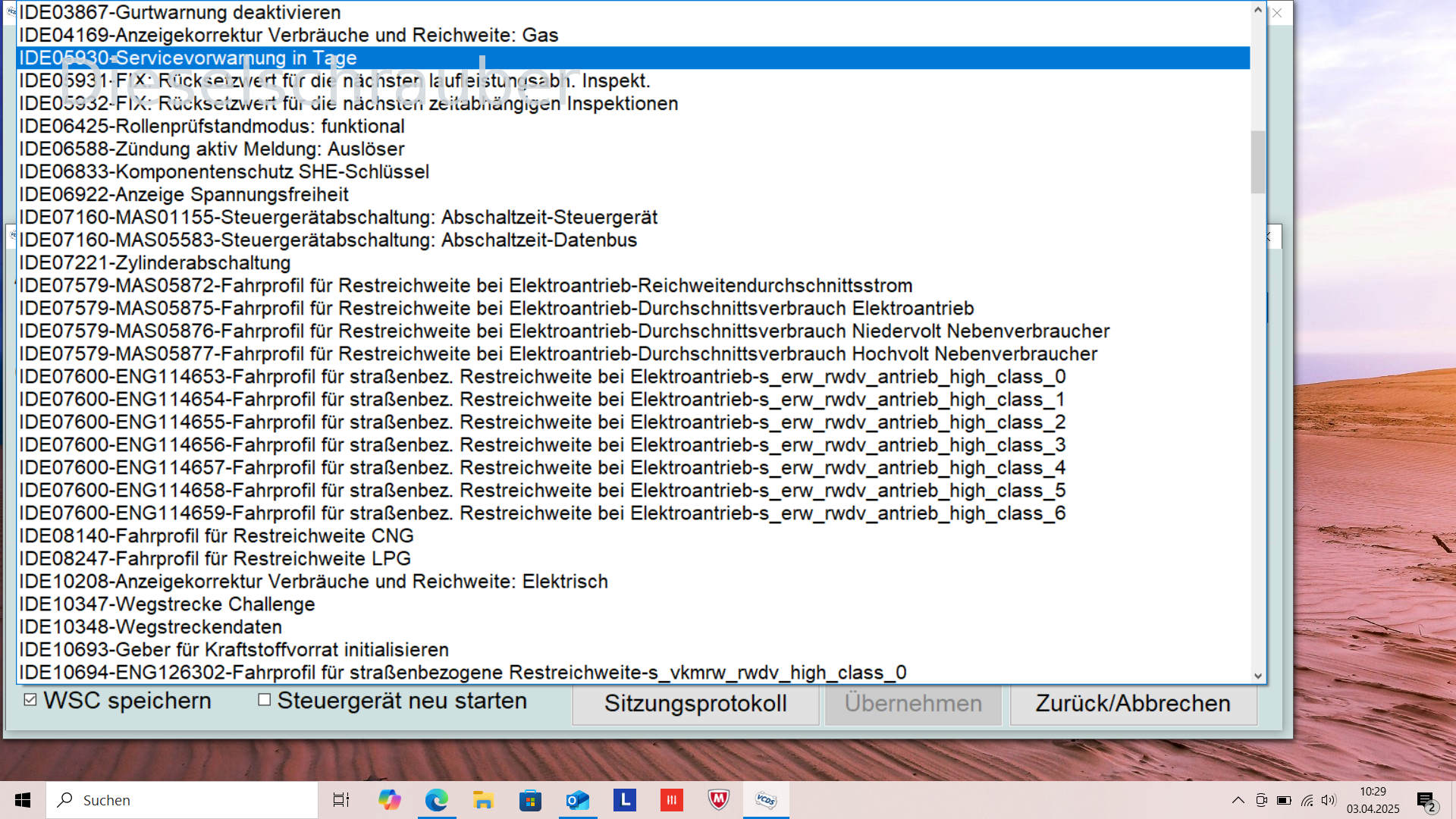

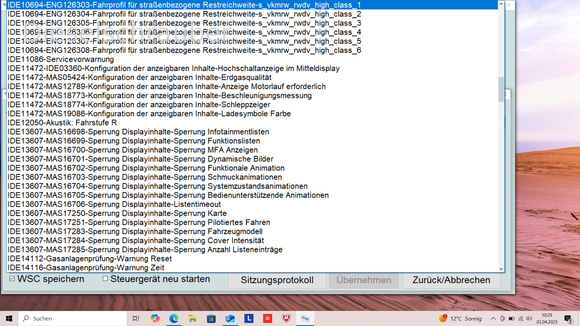

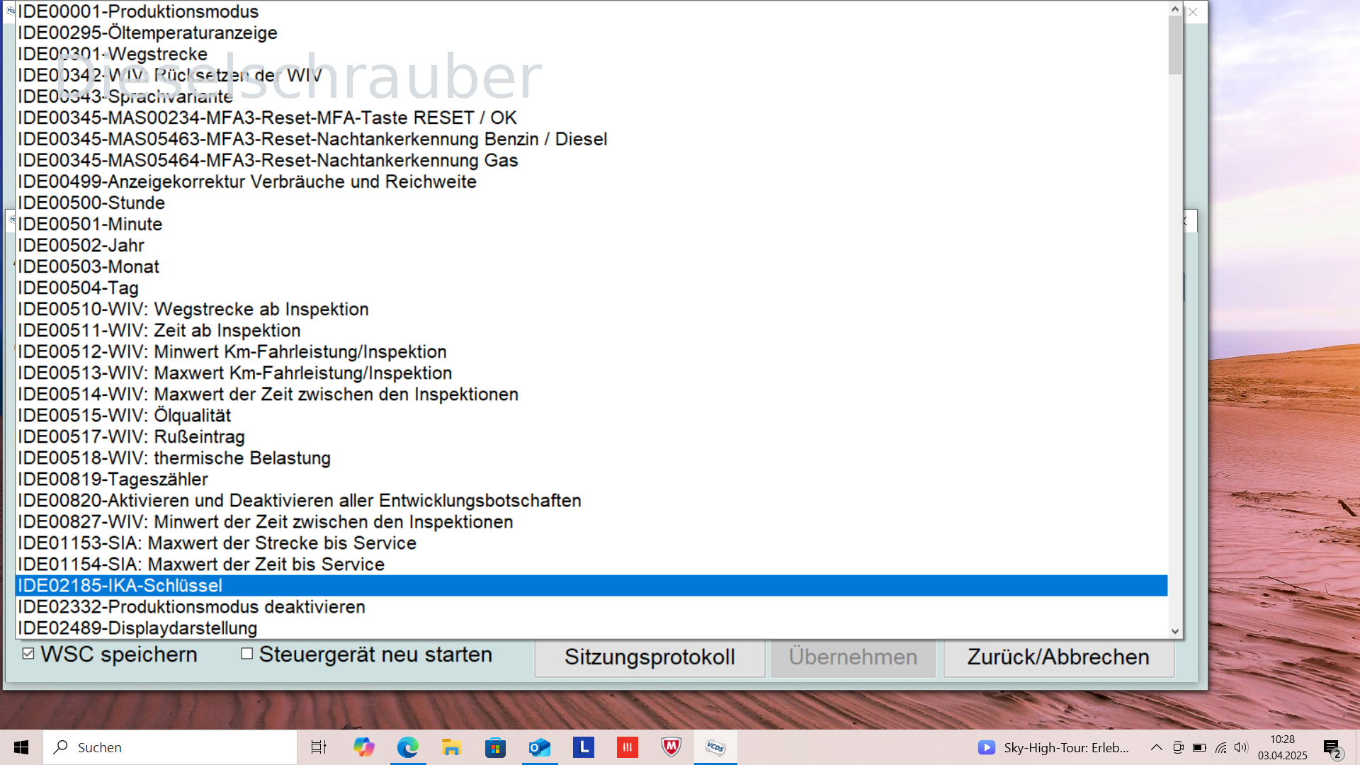

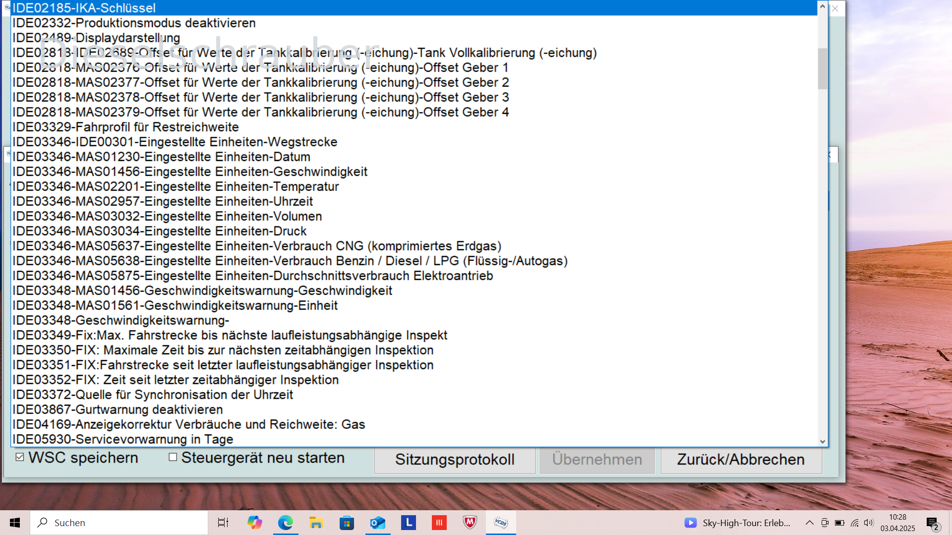

I would like to upload some pictures of the control unit and switch panel assembly to help with understanding, but unfortunately, I have no idea how to do that.
I can use VCDS to select the "Dashboard Insert" menu. Here, I can select adjustment parameters: distance traveled since the last inspection, time elapsed since the last inspection, minimum mileage per inspection, maximum mileage per inspection, and maximum time intervals between inspections.
Here are some values that are pre-set, but I'm not sure if I should or can change them, as I don't want to alter the default settings.
Posts: 18135
Post01-04-2025, 11:12    Subject: Reschedule inspection for Audi Q5 models from 2019 onwards Quote
Screenshot.
Posts: 18135
Post01-04-2025, 11:17    Subject: Subject: Reschedule inspection Quote
Gallo wrote:
I would like to upload some pictures of the control unit switch panel insert to help with understanding, but unfortunately, I have no idea how that works.
Here are some values that are pre-set, but I'm not sure if I should or can change them without altering the default settings.
Don't adjust anything. Depending on the car, it can be very simple if you don't mix everything up randomly.

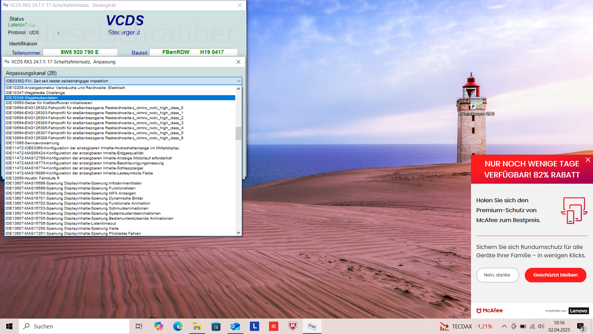

Here's a Screenshot of the control panel module.
I took several pictures and uploaded them, but I can't see them here. I probably made another mistake.

Posts: 18135
Post02-04-2025, 11:12    Subject: Reschedule inspection for Audi Q5 models from 2019 onwards Quote
See the corresponding IDEs from my links. First, reset WIV , then:
vag-driver wrote:
Everything is fine now.
With version 16.8.2, I was able to adjust the oil quality settings, and now the MFA (Multi-Function Display) shows "--- km" and "--- days." The 16.8.1 setting had already indicated good oil quality, which is why I couldn't change that value.
In short, here's the procedure for setting the parameters:
1. WIV time elapsed since inspection.
2. WIV route after inspection.
3. WIV oil quality > good oil quality.
Possibly add...
4. FIX: Distance traveled since the last inspection based on mileage: 0 km.
5. FIX: Time since last time-based inspection: 0 d
 File size:  18.05 KB
 Viewed:  162 times

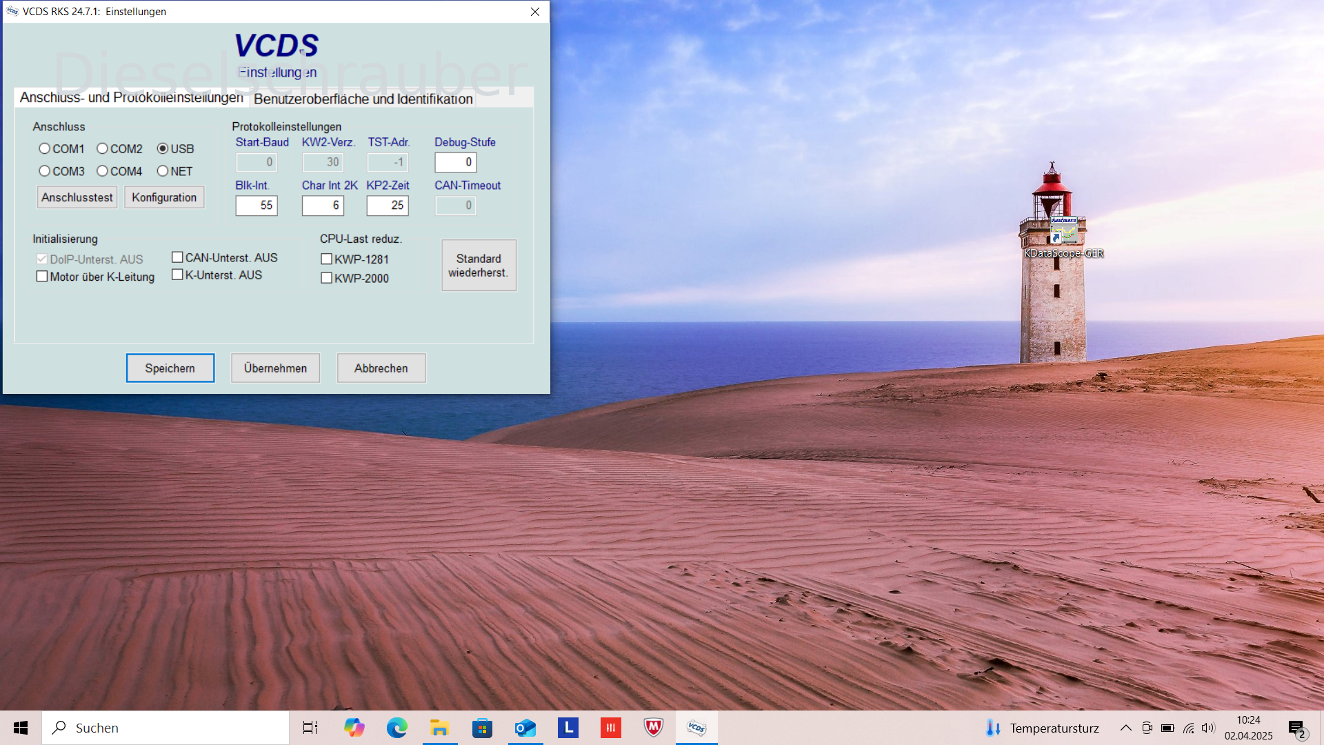

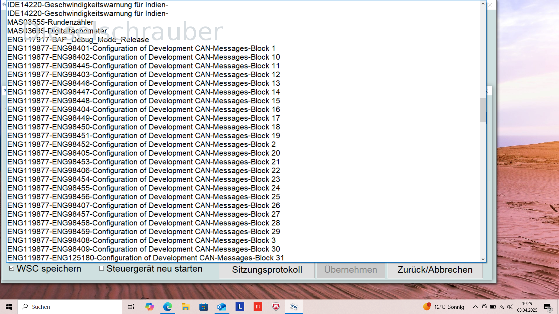

I can't see anything in the screenshots. Why? The display uses only a small portion of the screen, and therefore has a very low resolution. Simply adjust the window size in the VCDS user interface, and if that's not enough, you can use a screen capture tool to copy the desired section.
I would like to see the Screenshot with the list of adjustment channels. Alternatively, a copy of the control unit.
Before you make any changes, what type of service did you perform, and does your model support flexible service intervals?
And don't tell me anything about young and old.
Posts: 18135
Post02-04-2025, 14:26    Subject: Reschedule inspection for Audi Q5 models from 2019 onwards Quote
I would like to see the Screenshot with the list of customization channels.
It's actually incomplete and only a somewhat relevant part of the entire list, so you haven't missed anything.

Now, with your help, I finally managed to make the window bigger.
Here are the details again. I'm not yet sure where I might need to overwrite the data.

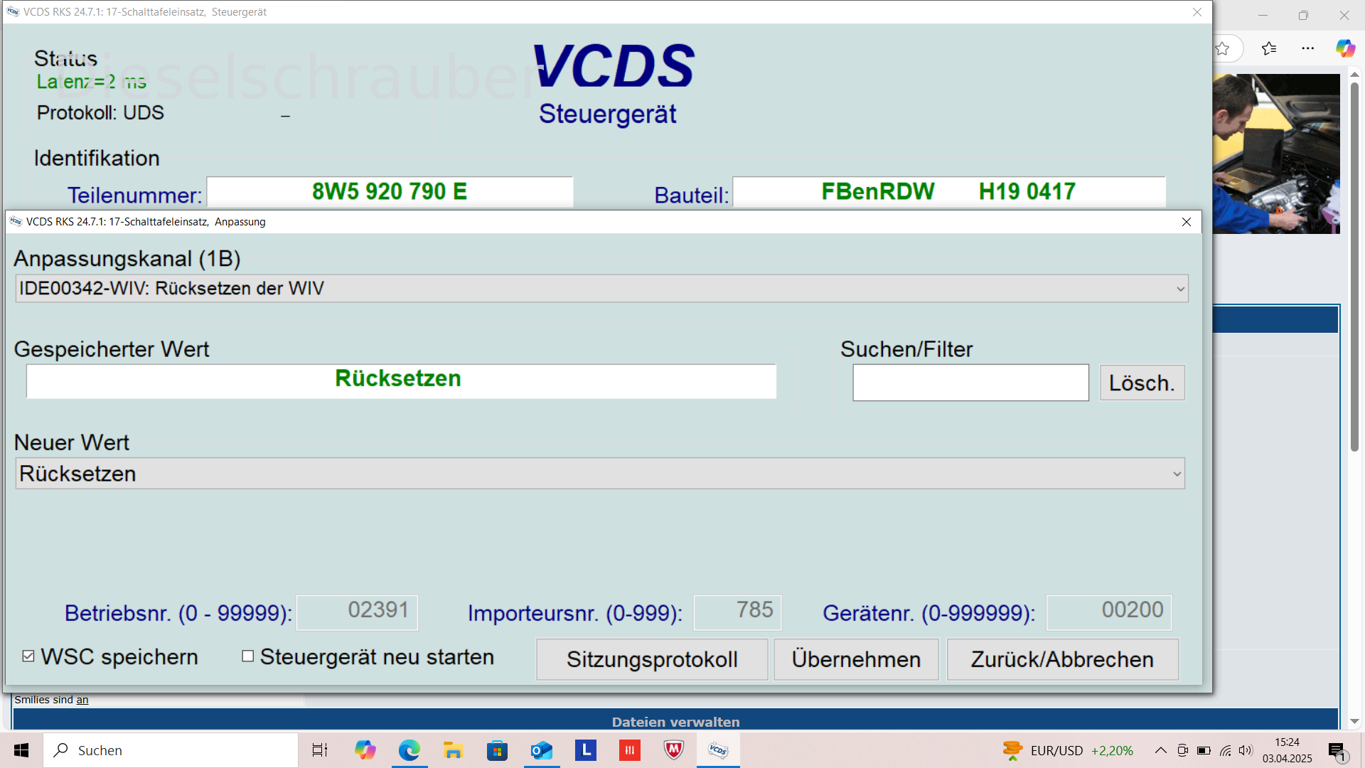

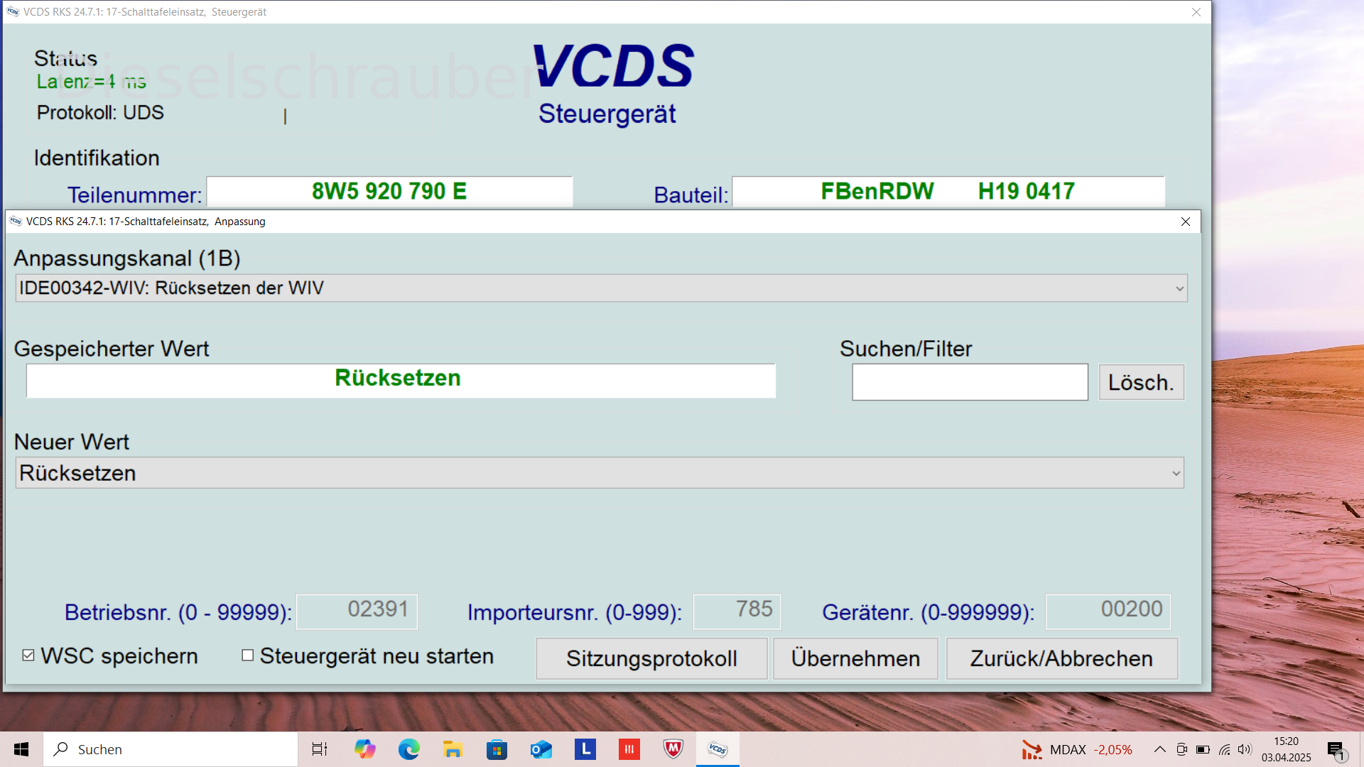

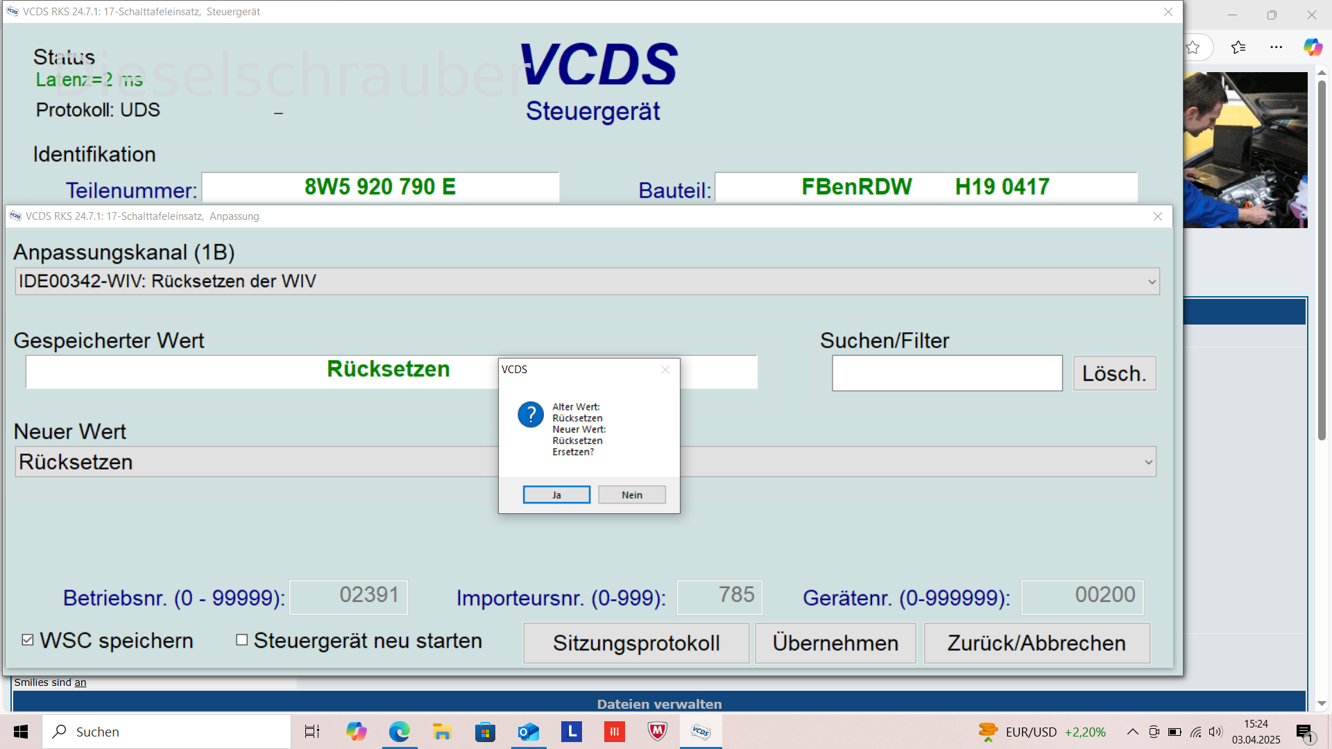

Post03-04-2025, 10:16    Subject: Reschedule inspection for Audi Q5 models from 2019 onwards Quote
Your friend is IDE00342, resetting the WIV.

Post03-04-2025, 14:31    Subject: Reschedule inspection Quote
Yes, if I do that and enter "reset," and then click "apply," do I need to enter a value?

Post03-04-2025, 14:35    Subject: Reschedule inspection Quote
I know I'm being annoying, but where do I need to enter a new value to reset the control unit?
