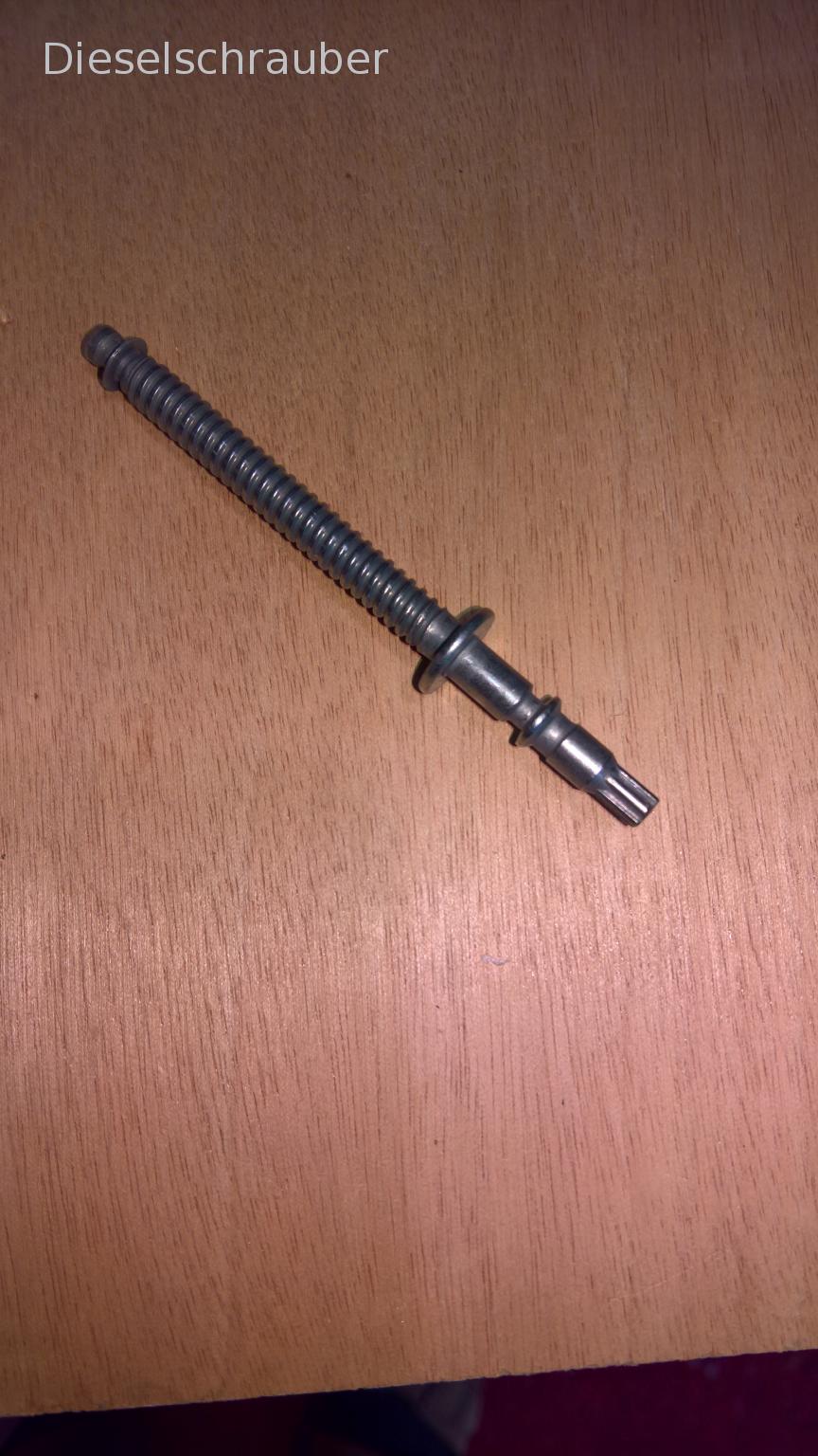

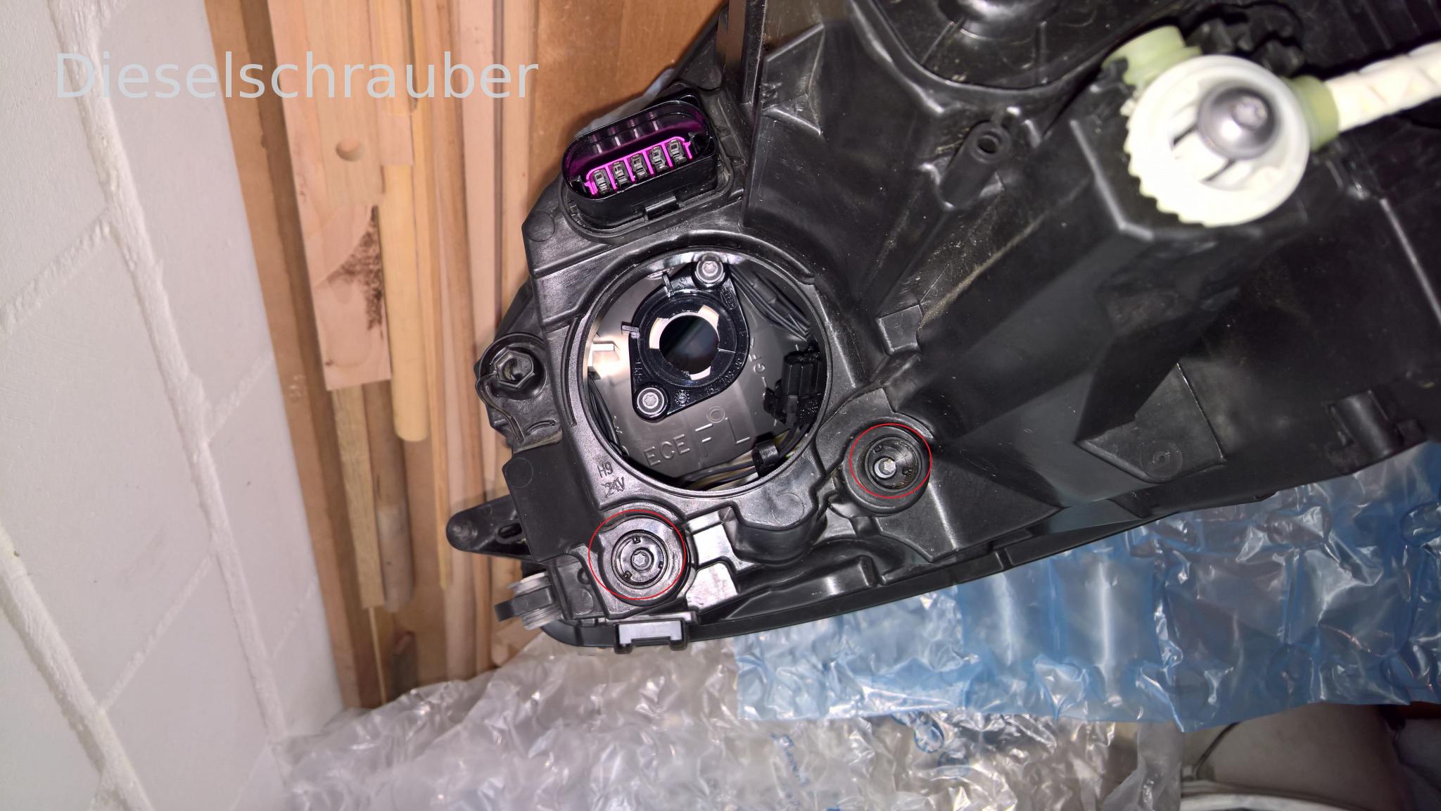

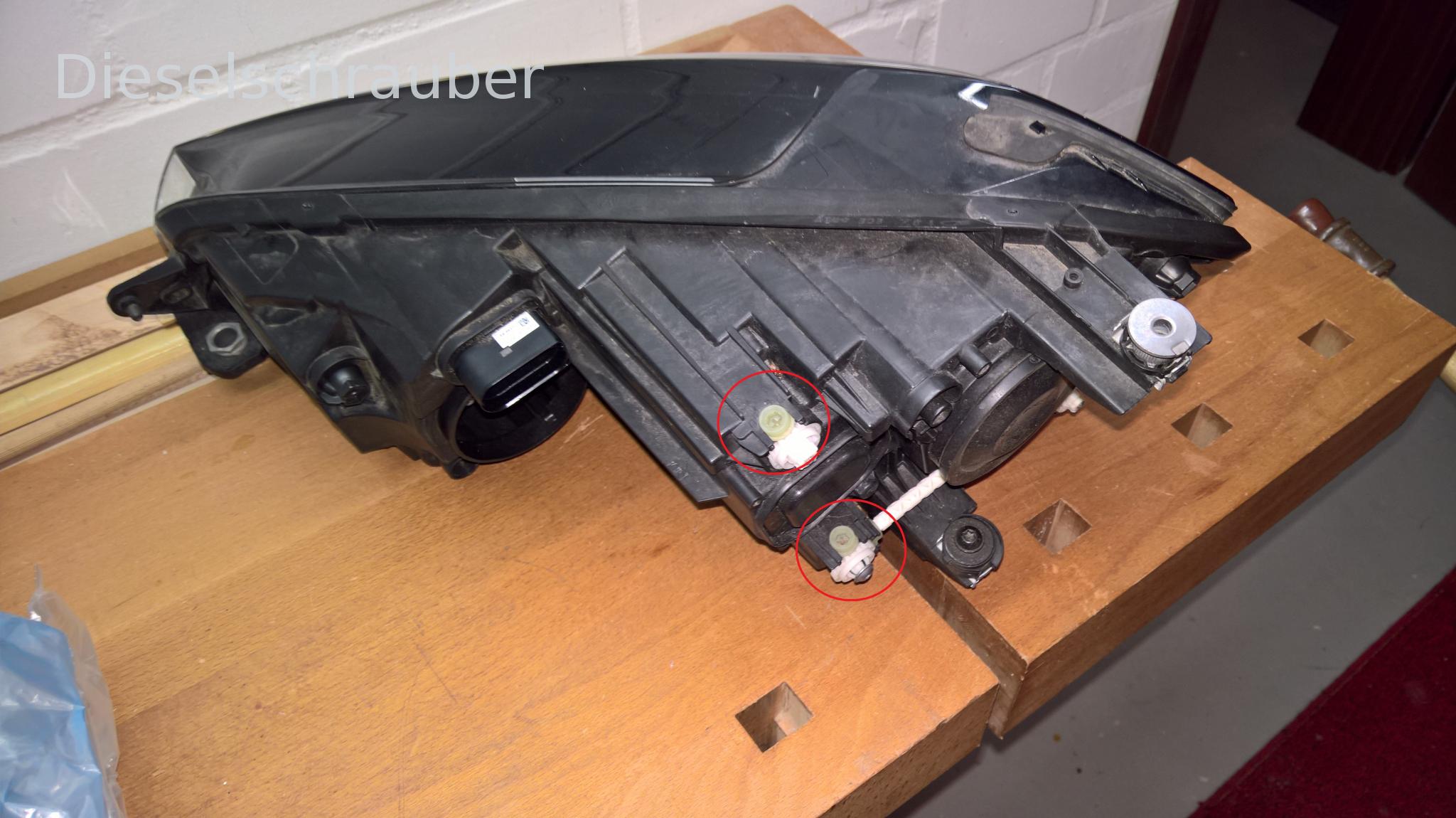

According to the specifications, it can also be completely adjusted laterally and in height (adjustment screws marked in image 1). At the bottom of the housing, in the area of the fog light, there are two more screws (marked in image 2) that act on the headlight reflector with a ball joint. With my headlight, this should allow for height adjustment. They can be turned with a Torx or Allen key. You can see the screw itself in image 3.
Maybe it will work for you too.
- Sorry, the order of the uploaded images is reversed. But you can see that, right?
