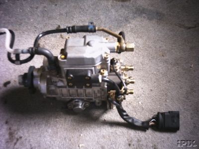

Here's a picture of the pump's condition. Unfortunately, it's completely missing the mounting flange and the drive wheel. So, it will probably be difficult to restore the original settings, right? Can the Bosch service department help with this? If so, what is the cost of such an action?
The VP37 variant offered has the VW/AUDI part number 038 130 107 D B00, and according to my research, it is compatible with my AGR engine. Does anyone have any contradictory documents that prove the opposite?

As far as I can tell from the photo, this is a pump with a factory-set feedback (FB) configuration, because it has a flange on the drive shaft where the timing pulley is attached. If the flange hasn't been loosened, which is likely the case, there is no problem. Because for the initial alignment, the pump is secured using a locating pin through the flange and the pump housing, thereby correctly positioning the pump shaft.
Your words make me very optimistic. In fact, I managed to acquire this great piece today at a sensational price of 199 EUR, which is quite a bargain considering how much a new pump costs from Audi/VW. This one has only 31,000 km on the odometer, so it's practically brand new (hopefully).

Externally, it looks very good, almost like new. The basic configuration appears to be unchanged, as the sealing wax is still present on the central nut.
However, I still have some concerns about its internal components. Has anyone ever tried to manually rotate the pump shaft with the pump fully extended? I could only rotate the shaft about 20 degrees until it reached a kind of locking point, and then nothing more would move without excessive force. Is that normal?
I need to add that the timing pulley is not attached. So, I only had the pump flange with a relatively small diameter. It seems to me that the resistance is quite significant.
Who can help me with their experiences on this? I haven't dared to use a wrench to twist the shaft yet.

donalexo wrote:
I could only rotate the wave about 20° until a kind of resting point, after which nothing more can be achieved without brute force. Is that normal?
Hi donalexo,
I believe that every quarter (or half icon_confused.gif) rotation needs to be adjusted on the ESP wheel before proceeding, and this is normal.

Today, I gave my new VP37 a more thorough inspection.
Because: every time the impeller comes into contact with the rollers of the roller ring, it initially requires a lot of force. Then, the impeller snaps onto the outgoing side of the rollers, and this often creates a twisting force that accelerates the pump shaft. Possibly, the ring wrench or spanner might hit your fingers if you're not careful. I want to say that the amount of force required when it rotates is very variable. If it were different, then there would be something wrong with the pump.
Try it and report here whether it is as I described.
You were absolutely right, Gustav. The raised profile of the impeller causes brutal torque spikes. Today, I dared to rotate the pump several revolutions using a ring spanner. It's quite noticeable that the pump piston is pre-tensioned by a very stiff spring.
now you can imagine what a timing belt does!
@BertilViewing profile: Bertil: That's truly incredible. I actually wanted to extend my next ZR (water pump) replacement interval to 90,000 km, but considering the circumstances... icon_question.gif icon_question.gif
The pump must be well-filled for proper storage. If diesel is used as the filling material, you should flush the pump approximately every 6-9 months. This is quite simple: Drive the pump with a powerful drill using an adapter, which is readily available in hardware stores, with a 6-sided connection for the drill chuck and a 4-sided connection for the socket, and a socket (19 mm?), rotating it as fast as the drill can manage.
What are some alternatives to diesel fuel? Is there a more suitable fluid that would eliminate the need for frequent flushing?
I'm afraid my drill won't be able to power the pump icon_sad.gif.
If my memory serves me correctly, the hoses are even attached to the pump in the photo, which makes flushing much easier.
That is correct icon_biggrin.gif. What would you recommend on the printing side? Should I seal the connections of the pressure lines with plugs?
It's a good feeling to have a spare pump in the basement that's practically brand new. However, the worst part is the urge to tinker, which would make you want to completely disassemble the pump!
Thank you for your helpful tips!
Regards,
Alex.
P.S. Does anyone have the exact dimensions for a suitable pump alignment pin?

Post07-07-2003, 20:35    Subject: Baseline adjustment of VP37 with drive wheel removed Quote
Hi Alex,
For TD/TDI engines (1z, AFN), the diameter should be 15.45 mm. However, it doesn't have to be that precise; a correctly sized socket will also work. The pin is intended to ensure that the number of teeth between the crankshaft and the ESP wheel is correct, meaning... In this area, inaccuracies in the nozzle have no significance because the fine-tuning is achieved through the initial feed rate setting.
