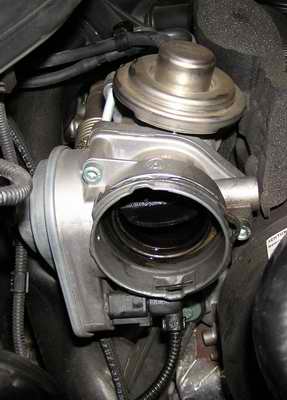

Post25-11-2003, 13:22    Subject: AGR Valve: Engine Stall When Deactivated Quote
Hey everyone.
May I chime in here and ask for a photo of the (allegedly) electric storage compartment door?
I've only seen pneumatic ones so far, and the catalog also shows that all of them (both the air-operated and the water-cooled EGRs) use the same valve-type EGR unit.
Thank you.

Joined: 04/15/2002
Posts: 5628
Post25-11-2003, 15:48    Subject: AGR Valve: Engine Stall When Deactivated Quote
dieselmartin wrote:
... (both the air-cooled and water-cooled EGR systems should have the same valve-type EGR unit)...
They don't. The pneumatic system, which normally controls the shut-off valve, regulates the water cooling of the EGR system; the shut-off valve itself is controlled electrically.
 Vorne die Abstellklappe mit dem Stecker für den Antriebsmotor (unten).
 File size:  21.4 KB
 Viewed:  19704 times
