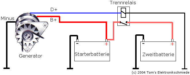

I would like to have some extra power available when needed, especially separate from the main electrical system. (The multimedia port hums when I use my laptop as a DVD player and power it with the inverter).
The idea was to have a corrosion-resistant box that would house the battery and a disconnecting relay, allowing the battery to be charged via the socket in the trunk without being connected to the ignition system.
Can this power outlet in the trunk handle the charging current of a conventional car battery?

How is it protected? Usually, a cigarette lighter typically has a fuse of no more than 10 amps. Therefore, I consider it risky to use it without additional measures. It would probably be best to add a charge regulator or build a small electronic circuit for current limiting.

If you only connect the battery via the ignition (relay), it will also participate in the preheating and starting process. This would overload the socket and the wiring.
A large diode in the power line would prevent that; however, it would also reduce the charging voltage to an unacceptable level icon_rolleyes.gif. Perhaps there are ready-made solutions from the RV world (?)

WoMo World is latching onto the D+ of Lima.
http://www.kerschhofer.net/t3/2batterie.htm

Powering the auxiliary battery through the cigarette lighter socket will only work well as long as the auxiliary battery is not significantly discharged.
If you connect these batteries directly, a very large equalization current will flow immediately after they are connected due to the significant voltage difference between them. This will likely damage the wiring of the cigarette lighter socket or cause the fuse to blow.
My tried-and-tested suggestion:
'At least 16mm² wiring should be run into the trunk, and a charging circuit should be implemented using a 75A relay connected to terminal 61.'
It works flawlessly in all measurement vehicles with an auxiliary battery, even if those batteries are occasionally completely drained.

In the original design, the second battery is directly connected in parallel to increase the overall capacity. A separation is not implemented due to cost-saving measures.
[End of speculation]
"How thick are the wires leading to the rear cigarette lighter socket, and what kind of fuse does it use? The wire resistance can cause a significant voltage drop at these current levels, which means that the actual current flowing may not be as high as expected."
R = specificResistance * length / area, where specificResistance ≈ 0.0175 Ohm*mm²/m.
Hypothetical example: 30A fuse, 1.5mm² wire gauge, 7 meters cable length (plus and minus, so effectively 14 meters) --> R=0.16 ohms. At 30A, this results in a voltage drop of approximately 5V.
"In that case, the fuse would hold even when starting. Just try it out; you're unlikely to damage anything more than the fuse itself. As long as the wires are long and thin, it should work. Although my example is already quite extreme in terms of values."

The idea was to have a corrosion-resistant box that housed the battery and a disconnecting relay, allowing the battery to be charged via the socket in the trunk without being connected to the ignition system.

Two lead-acid batteries connected in parallel will discharge each other due to equalization currents until they are both empty. Therefore, I actually assume that they should be disconnected.

Hello, I installed a second battery in the trunk of my car during my final year of high school due to my auxiliary heater.
It is very important to use a non-sealed battery if it will be located inside the vehicle; otherwise, you could risk being exposed to harmful gases!
The second battery is powered by the positive terminal of the starter battery, and is connected via a relay that is switched by the D+ terminal of the alternator.
The mass is located at the rear of the body.
That is to say, both batteries only operate in parallel and are charged simultaneously when a charging current is actually being generated.
When the ignition is off or the engine has not yet started, the batteries are disconnected.
I installed 10mm² cables as the main supply lines because, as already correctly stated, the problem isn't the charging current itself, but rather the current that flows when both batteries try to equalize their state of charge.
It's been working perfectly for about 8 months now with a 45Ah gel battery in the trunk.

You can find good information here about charging technology and disconnecting batteries. However, it works perfectly fine for me with just a single isolating relay.
http://www.microcharge.de/trenndioden.html
Calculating the required capacity is quite simple: multiply the power consumption of the connected devices by the operating time and then factor in a value between 1.3 and 1.8 (depending on the battery type).
Example: 2 hours of auxiliary heating (power consumption 10A) = 20Ah x e.g., a factor of 1.8 = A battery capacity of 36Ah is sufficient.
