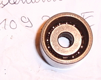

Great quality... I really should have gone with the VW parts or those cheap AHDEU ones instead.
The bearing of the idler pulley in my Conti kit has disintegrated.  After 50,000 km, it was more than worn out.
Now I can look around and figure out where and how to get one of those things, since driving isn't an option anymore.

dieselschrauber Administrator
Joined: 04/12/2002 Posts: 18113 Karma: +800 / -0 Location: St.Gallen 2018 Volkswagen T6
17-11-2004, 0:16 Subject: Timing Belt Replacement Tips & Intake Manifold Sludge |
Quote |
Hi.
"@Marco: It looks like all the pellets are still inside, but the guide cage and cover disc have crumbled. Hopefully, nothing else has fallen in besides a small piece of plastic from the guide cage."
@ donalexo : Heading home from work. Drove past a junction about 500 meters from my place. An old Opel was next to me. *Sound of squealing tires*: "Screech-screech-squeal-screech-screech."
My head: "Not another one"  .
The Opel is driving away - the noise remains.
Nothing was noticed before or this morning. However, during the last timing belt inspection, I noticed that the roller had a "rough" feel. It wasn't smooth like you would expect from a ball bearing, but it also didn't rattle or seize.
Damn, today I wanted to finish the flooring in the attic. Again, nothing got done. Because of that, I have to quickly get a new roll tomorrow before work and install it  .
The cause, in my opinion: rust in the bearing plus a lack of lubricant (probably homeopathic amounts were used again during the production of this premium product).

@Rainer:
If it offers any comfort:
Here's what a tensioner roller for a G IV 1.4 gasoline engine might look like after 50,650 kilometers:

Man, this is all such junk  .
