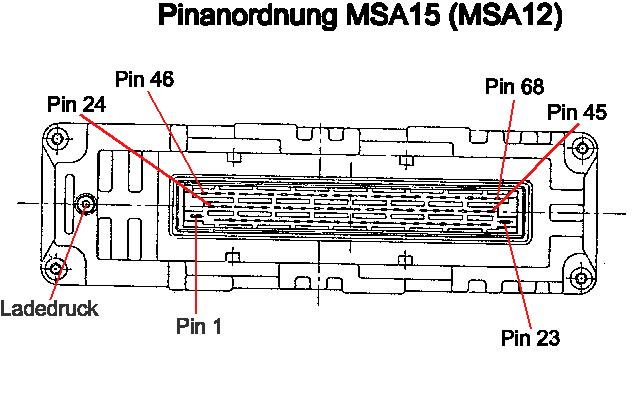

Okay, so the 021BF unit (like all intact MSA15 units) should 'normally' work with a slightly damp finger.
Minimal adapter for desktop use:
Pin 1: Ground.
Pin 23: 12V.
Pin 61: K-line.
The VAG-COM version doesn't really matter; even the old 078 works fine. Special settings.
are (actually) not necessary.
Best regards,
Rudi

Post11-05-2005, 7:35    Subject: 1Z No Response: Troubleshooting & Solutions Quote
I have a custom-built optocoupler adapter and the old 081.
So far, I haven't encountered any problems with any of the STGs (although they were always VPs).
But maybe I can convince Volkswagen to just type in "11463" somehow.
Translated on 23-08-2026, 2:11.
