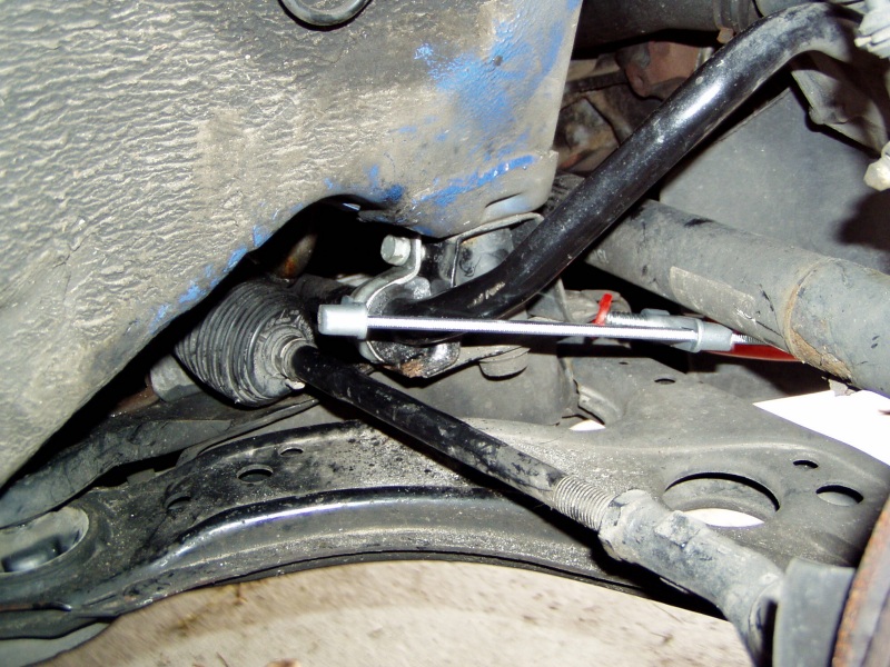

Post08-01-2005, 18:20    Subject: Problem changing the rubber bellows on the G4 Quote

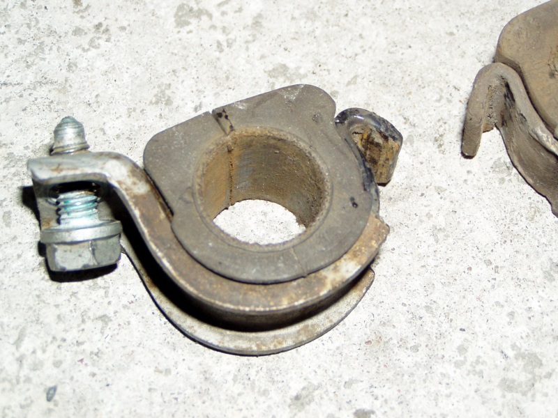

For those who can't stand the clunking noise in the front axle anymore and want to replace the stabilizer bar mounts themselves, here's a short report with pictures.
The following information applies to the A3 platform, Golf 4, Skoda Octavia, and Seat Leon models.
You should completely (and securely!!!) jack up the front of the vehicle, ensuring that both front wheels are fully extended. Only in this position will the access to the mounting screws on the support brackets not be obstructed by the tie rods, and the stabilizer bar will be free from tension.
Then you should remove the wheels and definitely disconnect the connection between the stabilizer bar and the tie rod (using a 16mm wrench); this is very helpful icon_biggrin.gif.
Nun kann man das Rad, an dem gerade arbeitet, komplett nach außen einschlagen, damit sich die Spustange samt Faltenbalgkomplett nach hinten verdrückt. So hat man max. Arbeitsspielraum. Mit einer normalen 1/2"-Knarre und 13er Nuss kommt man nun einigermaßen gut an die M8x18 Befestigungsschraube des Haltebügels heran. Nachdem die Schraube entfernt wurde kann man nun am losen Stabiende selbigen etwas nach oben drücken, um die Halteschelle auszuhaken. DeThe rubber band can be easily removed after the tab has been taken off.
I lightly greased the new rubber and the inside of the steel bracket to make things easier. To attach the rubber, it's helpful to push the stabilizer bar slightly upwards and backwards at the same time, so you can slip the part over it and position it correctly.
Then comes the more difficult part: assembling the mounting bracket.
With the stabilizer bar pressed upwards, slide the new retaining bracket over the rubber (attention: design change, new stabilizer rubbers must always be installed with new, matching mounting brackets). Then push the stabilizer bar downwards and forwards, while pressing the bracket as far and firmly as possible over the rubber with the other hand (a little grease between the parts is very helpful icon_wink.gif here).
It quickly becomes apparent that the new rubber bushings have a significant amount of pre-tension. Even when pressed firmly, there is still a gap between the flap and the thread that cannot be bridged with a screw.
I specifically purchased a very small C-clamp with a maximum clamping length of 150mm for this purpose. I then placed the clamp between the bracket and the edge of the motor housing, compressing the rubber as much as possible.
Even in this case, it is still very difficult to properly align the screw with the original one without damaging the threads.
Deshalb habe ich kurzerhand eine gut 5mm längere Schraube (M8x25) aus meinem Fundus genommen und diese angesetzt. Damit war es kein Problem, zuerst einige Gewindegänge ohne Vorspannung einzuschrauben, bevor Kraft aufgebaut wird. Beim Ansetzen der Schraube muss man natürlich darauf achten, dass die Richtung in beiden Ebenen senkrecht zum Gewinde liegt. Durch den Einsatz der Schraubzwinge kann es passieren, dass die Haltelasche leicht nach außen gezogen wird. D"Ann must be corrected firmly." icon_wink.gif
Once the screw had properly engaged, the rest was easy. Tighten until the strap is flush, then use a torque wrench to tighten it to 25 Nm. Then reattach the tie rod. A self-locking nut M10 is installed here and should be replaced (tightening torque 30 Nm). Of course, I didn't have a suitable nut on hand, so I secured the old one using threadlocker (Loctite).
Then put the wheel back on and move on to the next page.
If you know how, the whole process can be completed in about 1 hour. However, I initially had colossal problems, which meant I had to spend at least 4 hours on it icon_redface.gif.
To save other DIY enthusiasts from wasting their time, I decided to write this short report about my experience.
Attached you will find some pictures of the event.
Regards,
Alex.
 Hier sieht man die kleine Schraubzwinge zwischen Haltebügel und Aggregateträger, um das Gummilager vorzuspannen.

 Hier das alte, ausgediente Gummilager samt Halteschelle
