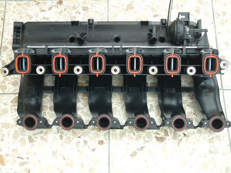

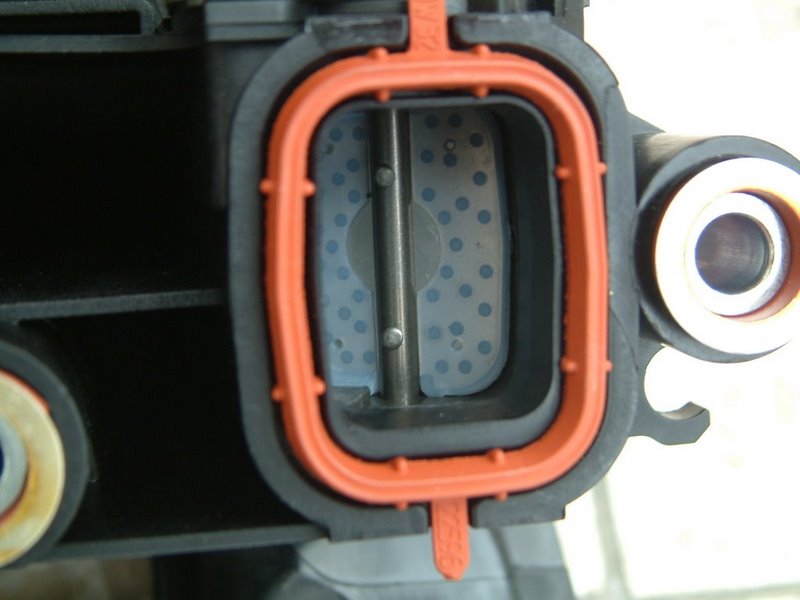

Post10-02-2009, 14:21    Subject: Removing Swirl Valves: Experience and Tips Quote
Just so we're on the same page, I mean these flaps!
Best regards, Tom.

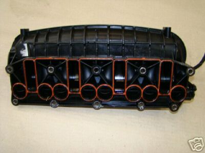

Joined: 03/13/2003
Posts: 10121
Location: in der Werkstatt
Post10-02-2009, 14:34    Subject: Removing Swirl Valves: Experience and Tips Quote
Are these all inlet channels?
If so, they are similar to the fill and swirl channels I have.
Your top six filling channels can either be fully open or fully closed – at least, that's what the rudimentary vacuum sensor suggests.
Just like with me:
The BMR engine has eight intake ports, four swirl ports, and four filling ports. The four filling ports can be closed.
 File size:  19.01 KB
 Viewed:  48554 times
