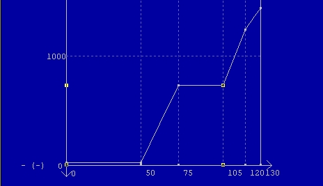

Post24-02-2011, 22:26    Subject: Quote
ulf wrote:
...But the pointer can be permanently(!) stopped at any position by adjusting the potentiometer. Only between approximately 75 and 105°C is the position of the potentiometer irrelevant.
Make sense when you look at the characteristics.
X is the temperature (target value, not measured) and Y is the desired value for the
Stepper motor control.
 Schrittmotoransteuerung Kühlmitteltemperaturanzeige Kombiinstrument.
 File size:  32.07 KB
 Viewed:  3910 times
