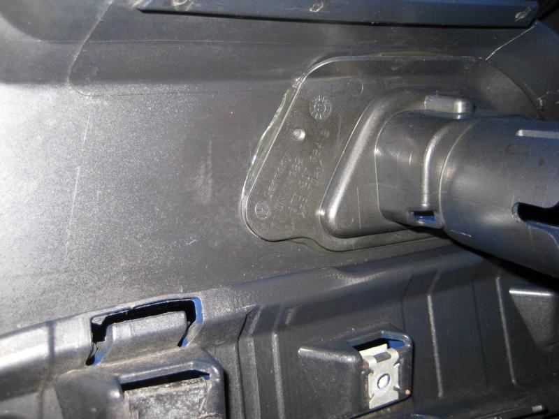

Post25-03-2013, 9:15    Subject: SRA glued onto the Touran Quote
... and the adhesive is now loose.
Is that a double-sided adhesive pad, or is there real glue in between?
 Befestigung der Scheibenreinigungsanlage beim Touran.
 File size:  138.34 KB
 Viewed:  5629 times

Post25-03-2013, 9:39    Subject: SRA glued onto the Touran Quote
On the Golf 6, this part is soldered in place. I had one just last week where it also broke off.
Make sure to apply the adhesive properly.

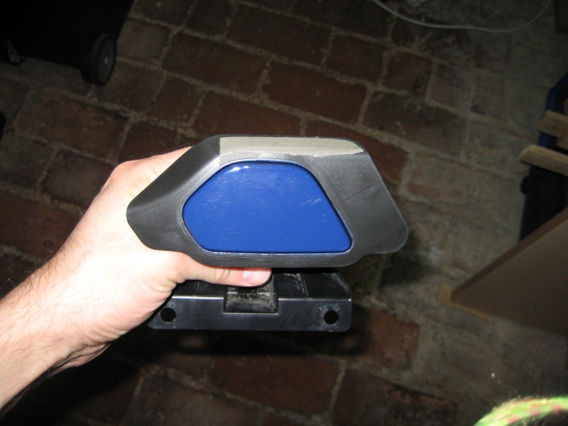

Post25-03-2013, 20:07    Subject: SRA glued onto the Touran Quote
Then I'll probably have to completely detach the part first, because it seems like there's an adhesive pad in between.
(Daylight is a great thing if you want to see something like that icon_eek.gif).
 File size:  69.23 KB
 Viewed:  2868 times

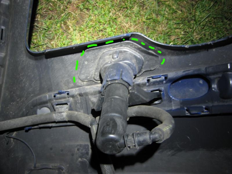

Post26-03-2013, 21:20    Subject: SRA glued onto the Touran Quote
Sure.
Sticky pad that no longer sticks.
I need a good adhesive for attaching front spoilers!
 File size:  240.24 KB
 Viewed:  2531 times

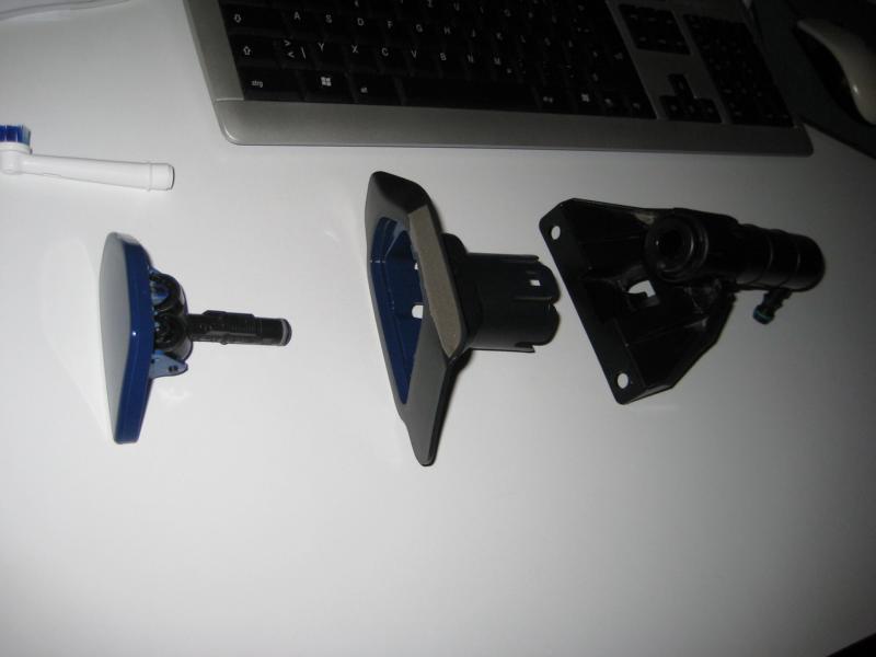

Post26-03-2013, 22:58    Subject: SRA glued onto the Touran Quote
I just realized that the parking sensors on the Passat are also only glued to the bumpers.
Unfortunately, these adhesive pads are a perfect fit, likely due to the perfectly round cutout.
The 1.6-liter gasoline engine has something stuck to the intake manifold with tape.
I could probably come up with something using that.
I don't have body adhesive in 5-gram portions, and a complete cartridge seems like a bit too much icon_wink.gif.
At least I disassembled the SRA once.
Using a bicycle spoke to push the piston out, I snapped it back into place and disengaged the nozzle. Otherwise, you can't get the SRA (likely referring to a headlight or similar component) out of the front bumper bracket... It's solved differently than on the G5, where everything can be nicely disassembled.
Now I have the bracket separately and can glue it in place without applying too much force.
 File size:  34.86 KB
 Viewed:  2051 times
Translated on 10-07-2026, 14:09.

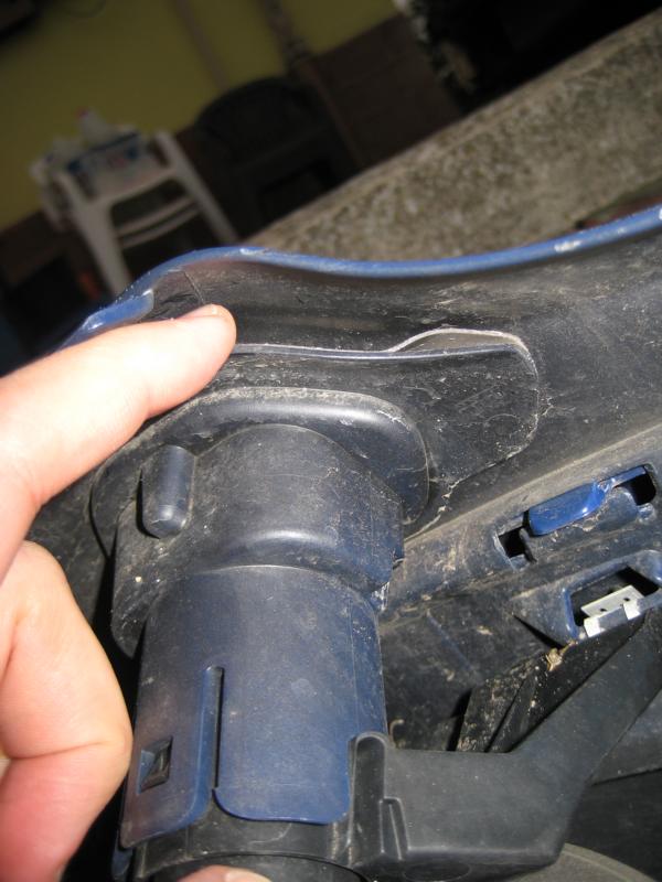

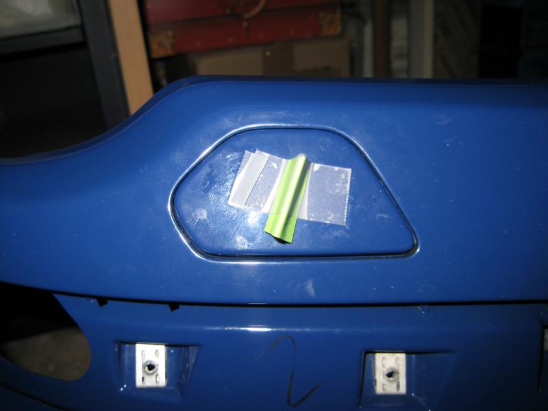

Post02-04-2013, 15:21    Subject: SRA glued onto the Touran Quote
OK.
I got everything originally icon_wink.gif.
Primer, 2K adhesive...
The current PDC sensors are no longer attached with pads, but rather with adhesive.
Tonight, we're going to have a wild time.
Translated on 10-07-2026, 14:13.

Post02-04-2013, 22:02    Subject: SRA glued onto the Touran Quote
Okay.
For the first attempt, it's not bad at all icon_smile.gif.
 File size:  70.92 KB
 Viewed:  1833 times
 File size:  43.74 KB
 Viewed:  1615 times
