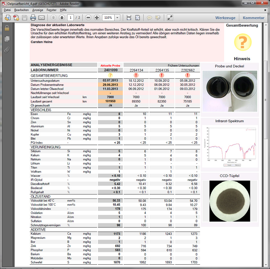

After I had first resealed the PD elements, and after...
After approximately 3500 km, I noticed that the engine oil level was still rising and increasing significantly. I then replaced the tandem pump.
Now, after driving 7000 km since the tandem pump replacement, here is the lab report for your review.
5.42% diesel fuel detected in the engine oil after 7000 km, which isn't exactly a good sign.
It's really very little, but at least it's half of what it was in the last analysis.
And as you can see, the percentage of diesel continuously increased. If I hadn't done anything, I would probably have about 12% diesel content now.
"as stated in the lab report."
In this way, I was able to stop the negative trend and move towards a...
Lower a reasonably sensible level.
Considering what the CASTROL laboratory wrote to me, I can probably be satisfied now.

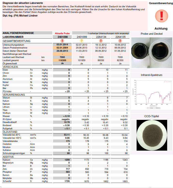

Well, there was also the hope that replacing the tandem pump (after the PD elements had already been re-sealed) might have made a difference...
Here are the results of the latest lab analysis, after the usual 7,000 km (I didn't have an analysis done during the previous oil change).
Over 10% diesel content.
But, as mentioned above, I don't care whether CASTROL and VW believe that this is normal for these engines - I don't want to drive around with more than 0.4 liters of diesel fuel mixed in with the engine oil.
