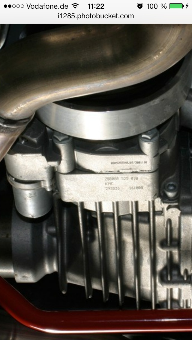

Today, I had a 2006 Audi S3 8P in my shop, and I was going to change the Haldex oil and filter.
According to Audi, there should be a drain screw at the bottom and a fill screw on the side.
However, neither of those was present. The filter could have been replaced with a cover on the side, with the designation SW 24.
The filling volume should be 0.8 liters.
Can someone tell me how to make a change here?
It's not like the previous version, where the oil is pressed in.

It seems it is indeed the 4th generation.
I found a picture that matches the clutch for the S3.

The Haldex coupling oil will be completely replaced via the axle oil, starting with generation 4.
There is a filter that is installed on the Haldex system, and it is also very easy to replace using an Allen key.
