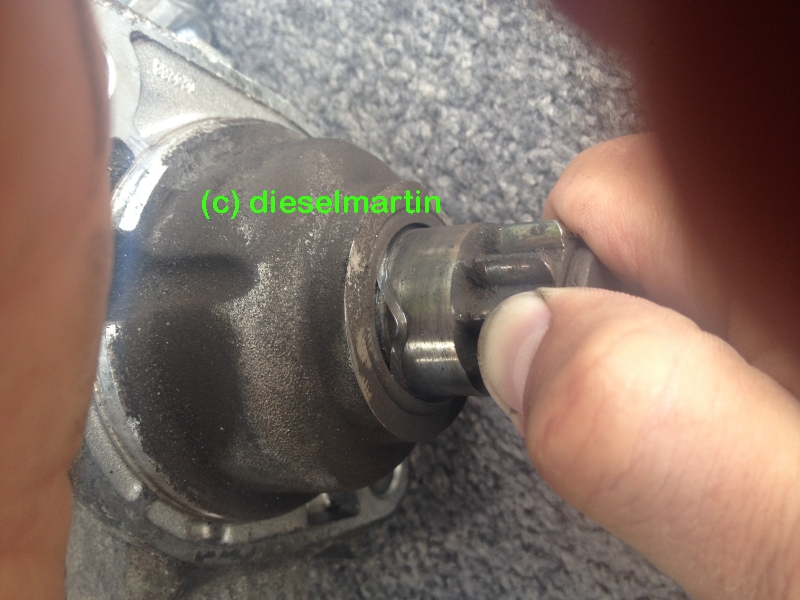

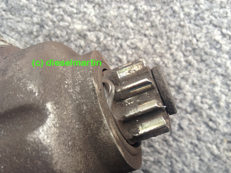

Post10-07-2014, 18:35    Subject: Starter Motor Touran BRU Quote
Meanwhile, the starter motor stopped working altogether.
Just a "click" from the magnetic switch.
The shaft has approximately 2mm of play laterally.
It probably isn't worth trying to fix it, is it?
