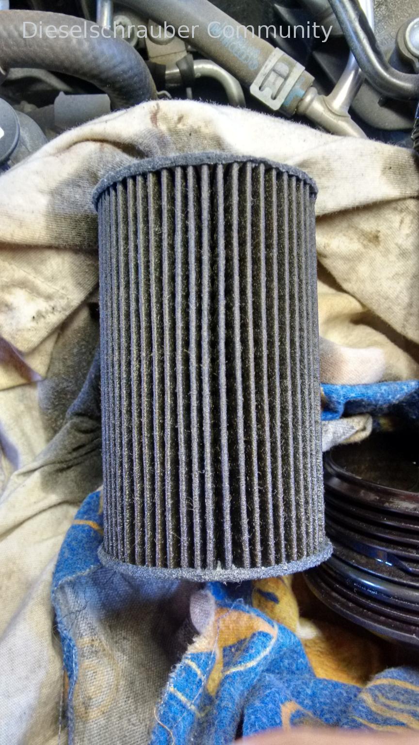

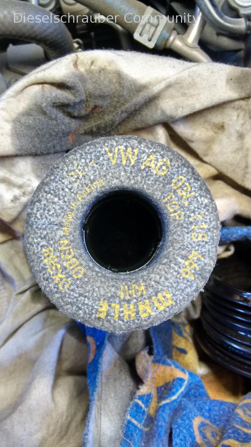

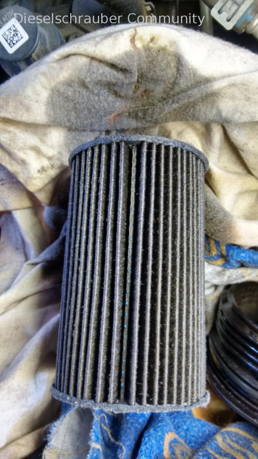

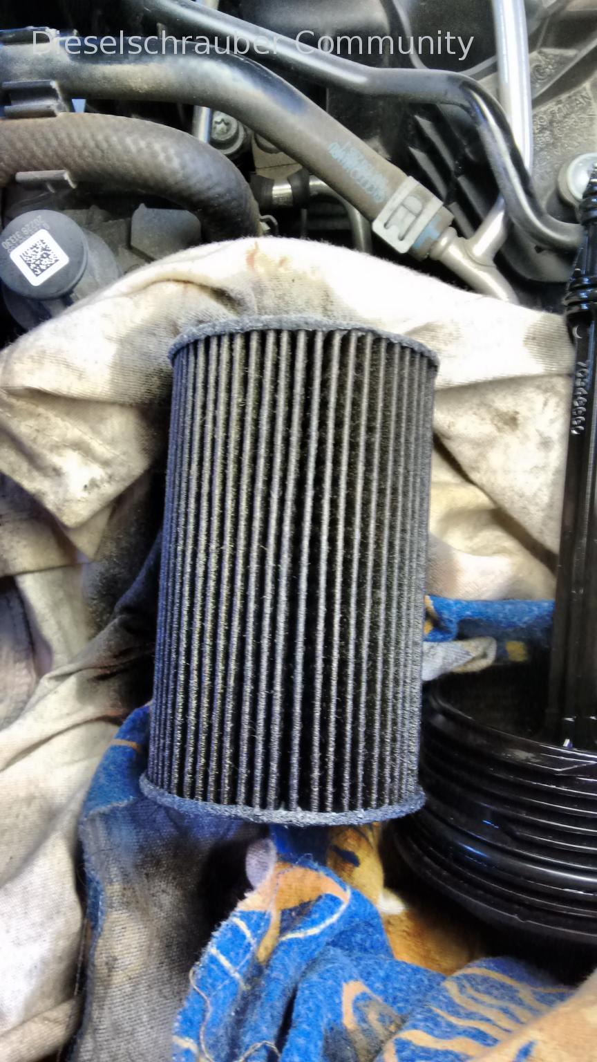

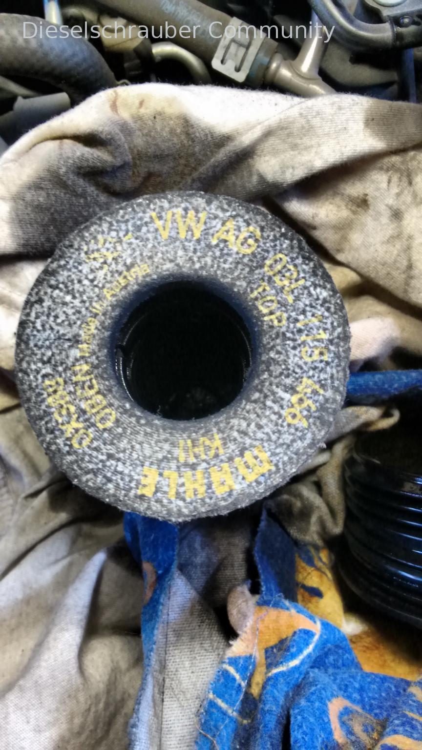

Post01-08-2015, 18:37    Subject: Oil Change: How to Check & Understand. Quote
I took a look at the oil filter today, what do you think?
1000 km or 30,000 km mileage?
Around the oil filter, everything looked untouched; there wasn't a single oil splatter, and nothing had been wiped clean.

Post01-08-2015, 18:51    Subject: Oil Change: How to Check & Understand. Quote
Thank you! Based on their "level of wisdom," I would say they haven't been here for very long. icon_smile.gif
Of course, without any guarantee.
