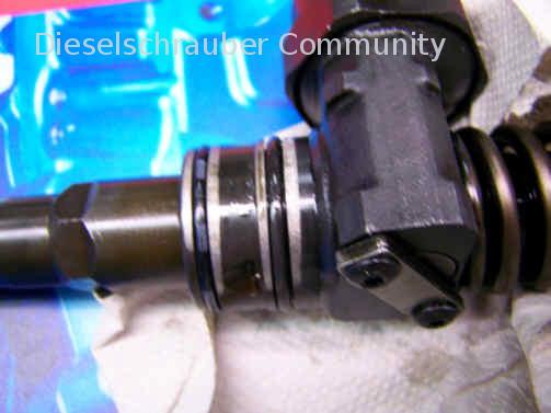

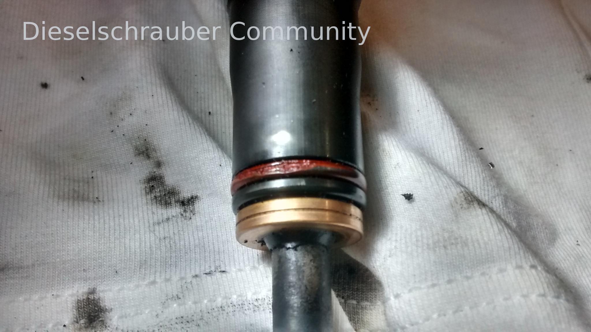

Progress report: I have now removed the PD elements (using a self-made removal tool with the original clamping block).
In some cases, the gray coating on these parts is no longer present, but there is no missing material.
In addition, this brown sealing element has crumbled. Let's see, now new sealing sets, including ball bearings and a pan, will be installed.

 Beschädigte Dichtung am PDE #3

Okay, here's a progress report:
No more smoke, and fuel consumption has decreased by approximately 1 liter per 100 kilometers!
"However, it often goes into limp mode (due to the DPF), and forced regeneration no longer really works (it immediately goes back into limp mode, and only regenerates up to about 15% load)."

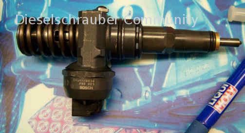

best regards
That's perfectly normal for that type of part. The pictures show an injector after 190,000 km and one that was only installed a week ago, having run for about 500 km. You can already see the problem starting on the side facing the tandem pump.
 Pumpe Düse Einheit nach 500 km.Seite zur Tandempumpe hin.
 File size:  17.72 KB
 Viewed:  640 times
 Alte PDE nach 190tkm.Selbe Seite.
 File size:  18.78 KB
 Viewed:  646 times
Passat Variant BGW 2005
Translated on 11-10-2026, 4:33.
