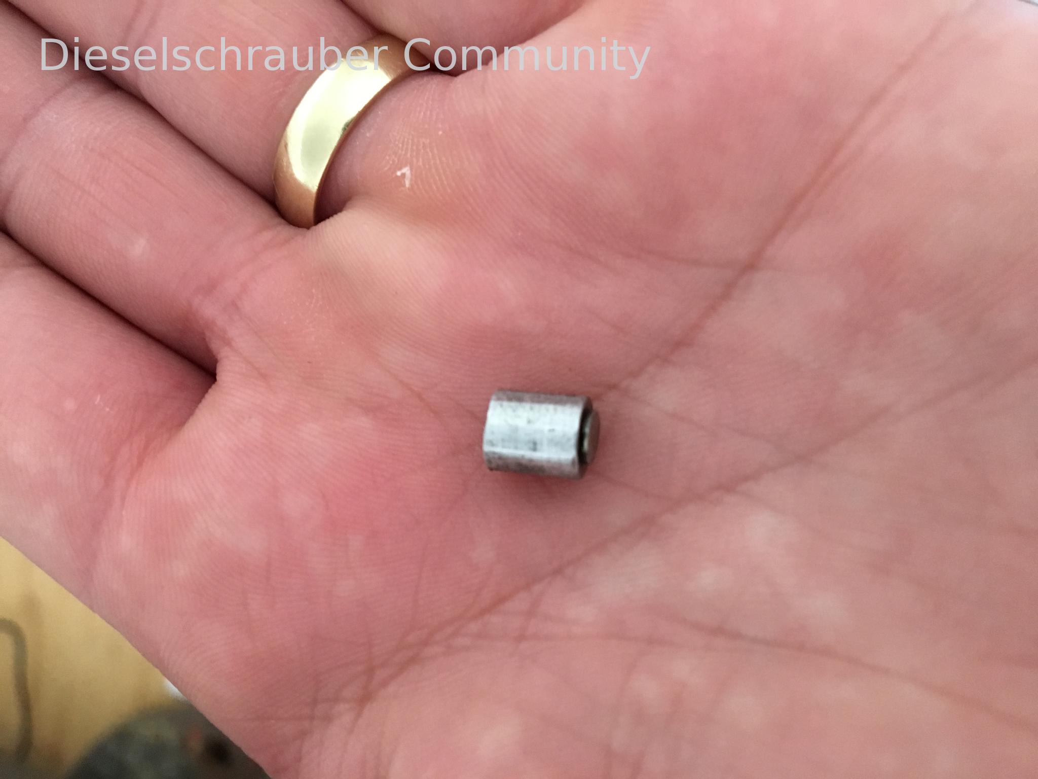

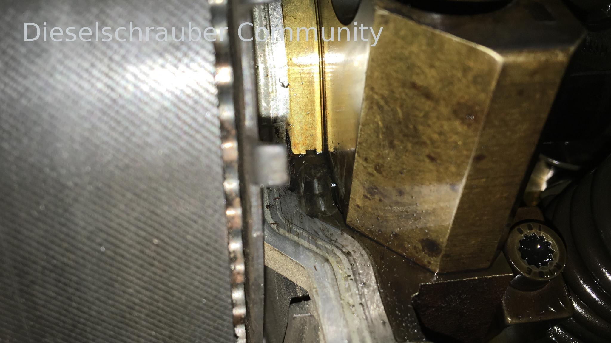

When I removed the valve cover, I found a small, round, metallic piece behind the valve cover gasket, next to the curved area where the camshaft passes through. It was lying there inconspicuously.
I'll try to upload some pictures of the place where the part was located and of the part itself. If it doesn't work right away, please bear with me.
P.S. My mechanic colleague suggested it might be a part of the hydraulic lifter, but I'm somehow doubtful about that, and I hope it's not.

This is the plunger cylinder of a hydraulic lifter.
If the engine hasn't recently had a lifter disassembled, then the part likely came from a previous "repair" (which, at best, only involved replacing the lifters).

A broken pestle would have made quite a mess of the "salad" above the ZK. You don't need to search extensively to find it.
The only advice: if the valve lifters have reached 250,000 km, then replace them. The first signs of wear are pitting (small indentations on the camshaft lobe surface).

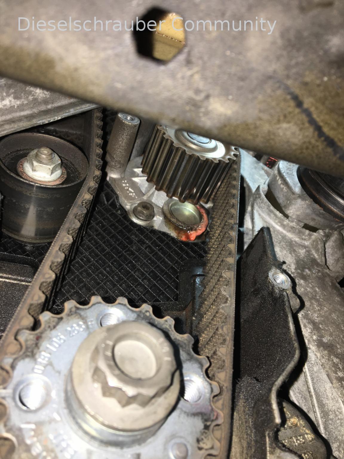

The problem was that the expansion tank was building up pressure very quickly, causing the coolant warning light to come on and forcing coolant into the hoses. Even when the engine was cool, there was still pressure in the expansion tank, and the fluid would be pushed back out; there was always a loss of about 100-150 ml.
The CO test in the coolant was negative, but VW said it was definitely the head gasket, and the cost would be 1300 euros.
The Wapu is also broken (see picture), I only noticed that now.
I've already disassembled everything except for the timing chain bolts.
Now I don't know either, I thought if I'm already this far, then I might as well replace the timing belt and chain (ZKD) too, and then I might have peace of mind for the next 250,000 km. icon_wink.gif

The warning light for low coolant usually only comes on when the coolant level is too low.
No matter how many potential leaks you can rule out on the block and the hoses, your approach remains the only option.

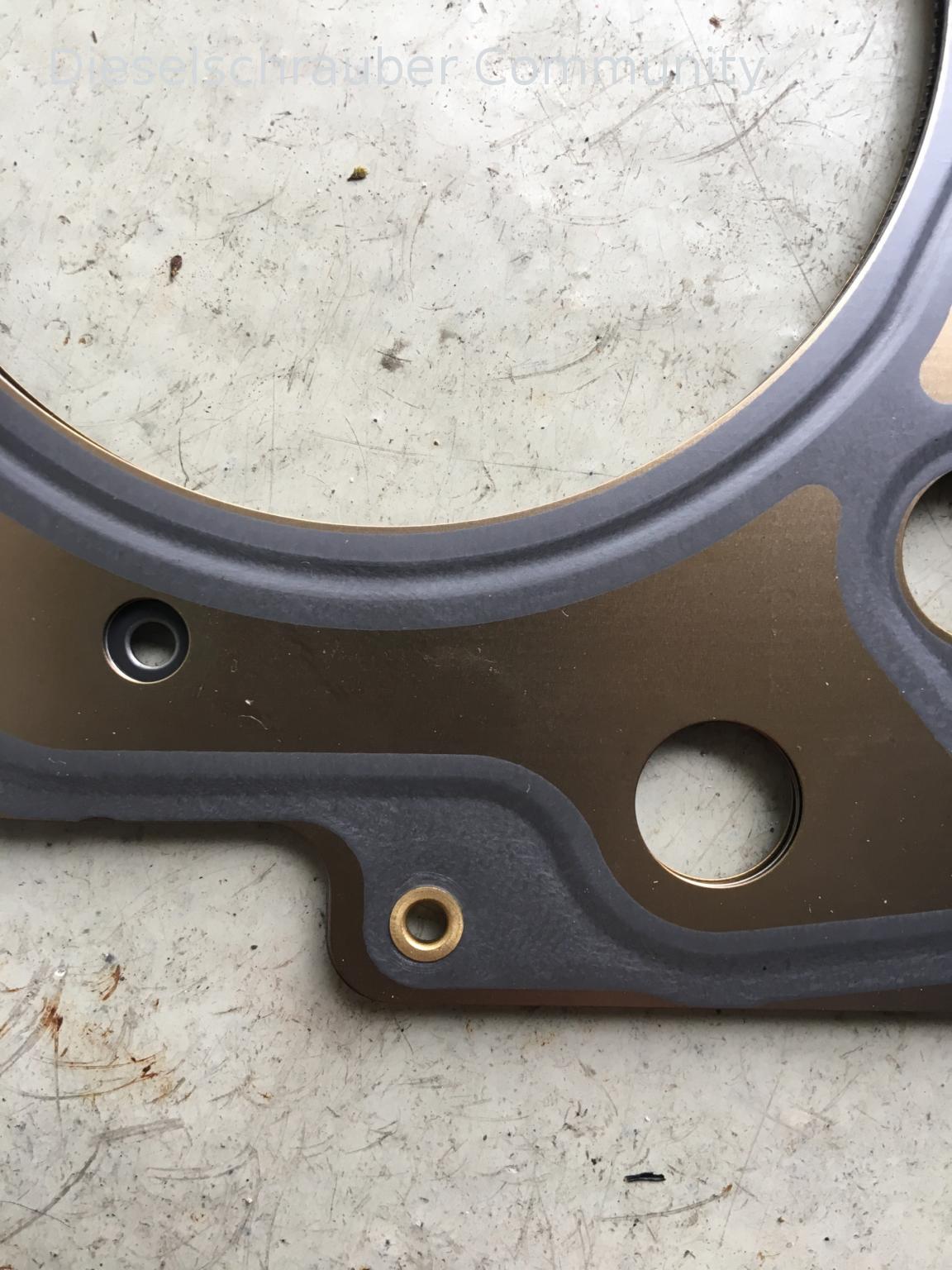

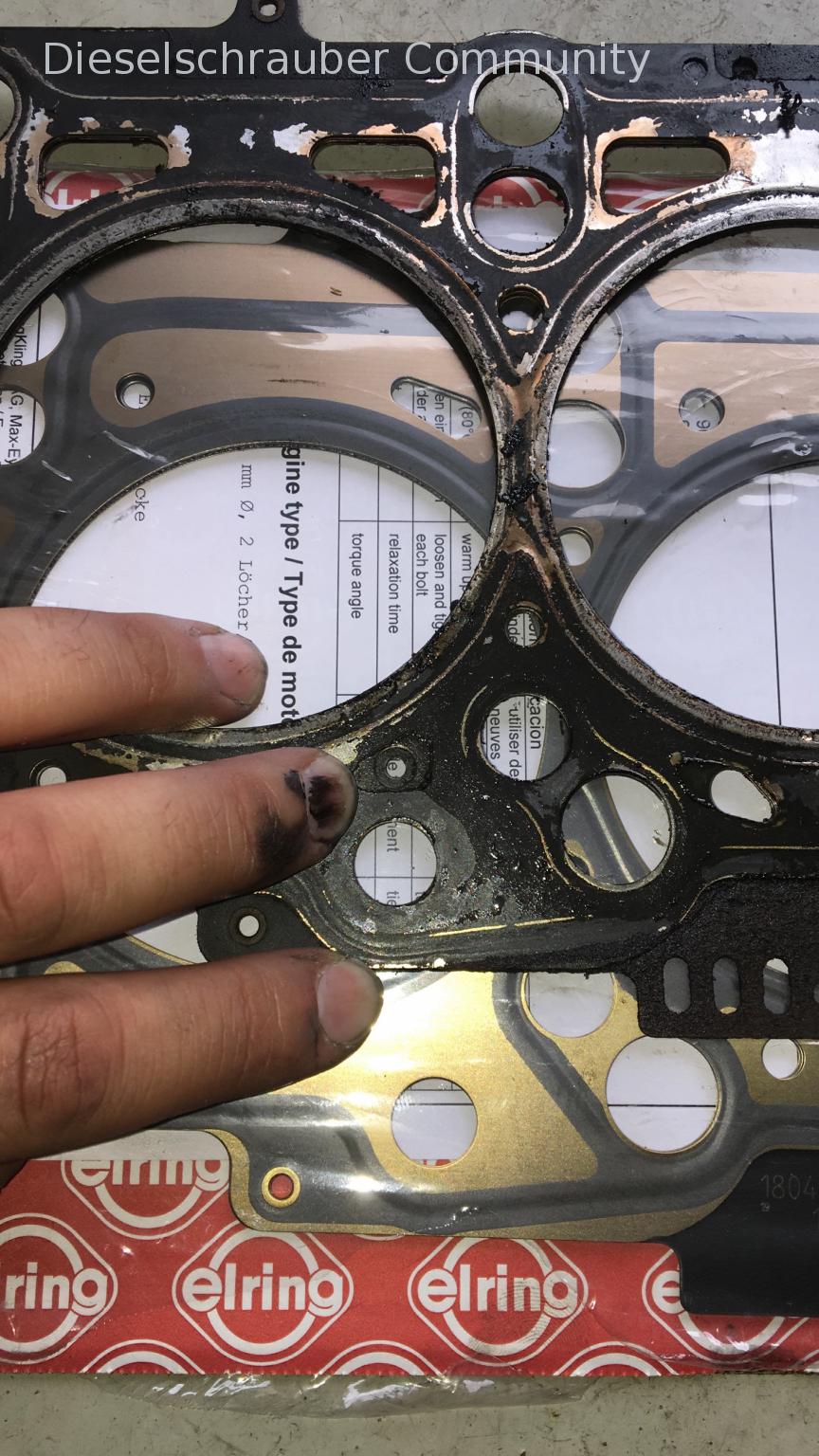

I have a question about the new ZKD.
The new one has one less hole than the old one. See the picture where my fingers are.
Does that bother you?

I almost think it might still fit because there's another hole next to it, and that leads to the same channel.

Turn the gasket icon_wink.gif upside down and place it on the engine, then you'll see if the hole is needed. }
