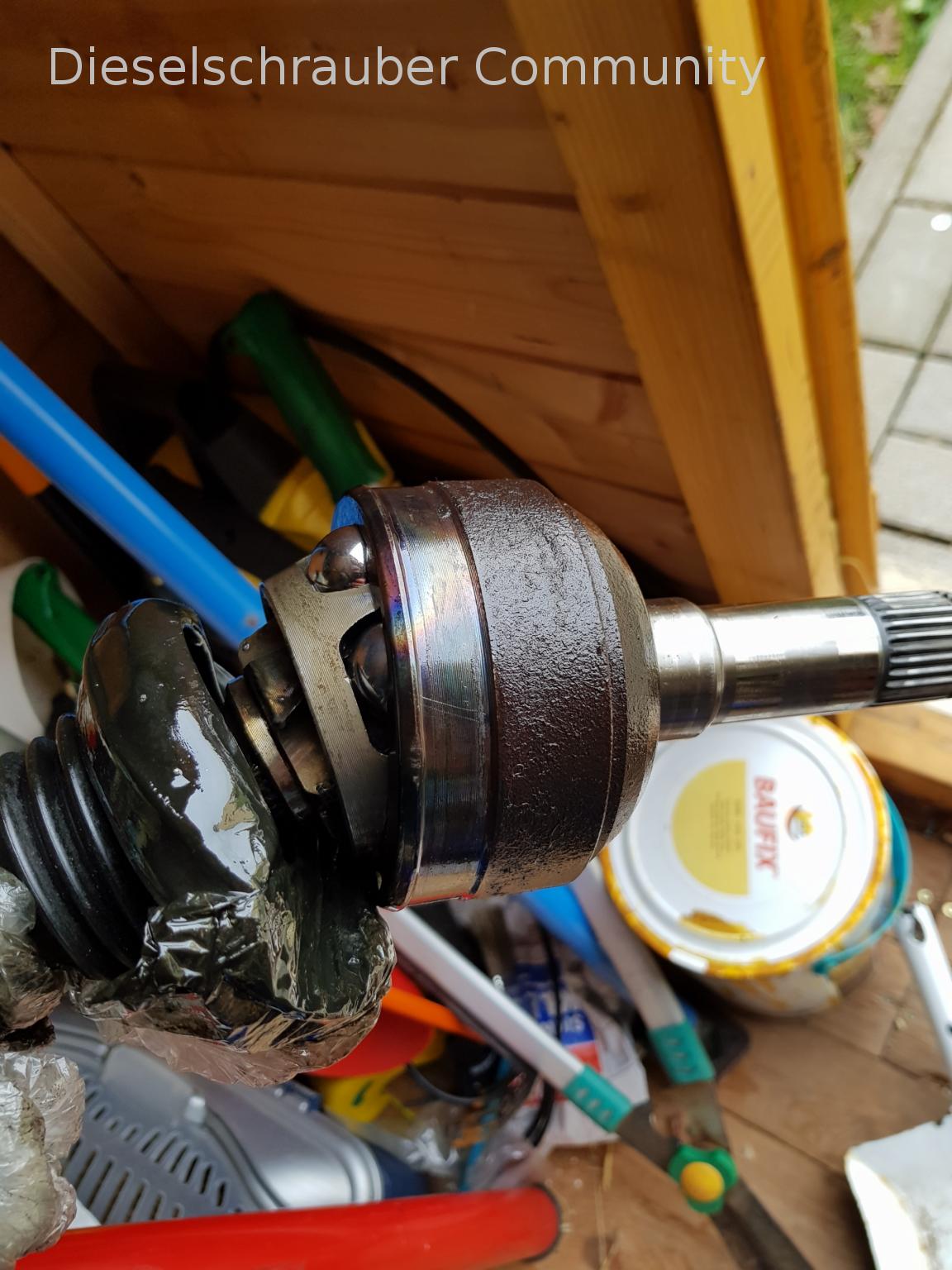

Golf 4, at 120,000 km: slight shaking and vibration. By 150,000 km, the shaking and vibration became progressively worse.
Then I disassembled the internal constant velocity joints. A picture is worth a thousand words.

I have to say that 90% of the kilometers driven are always with 4 people and luggage. I can imagine that my driving style, always utilizing the full torque, and the total weight of approximately 2 tons are not beneficial for the bearings. I suspect that the bearings, like in the photo above, always engage at the same point, then become misaligned under load, and cause an out-of-round condition in the shaft?

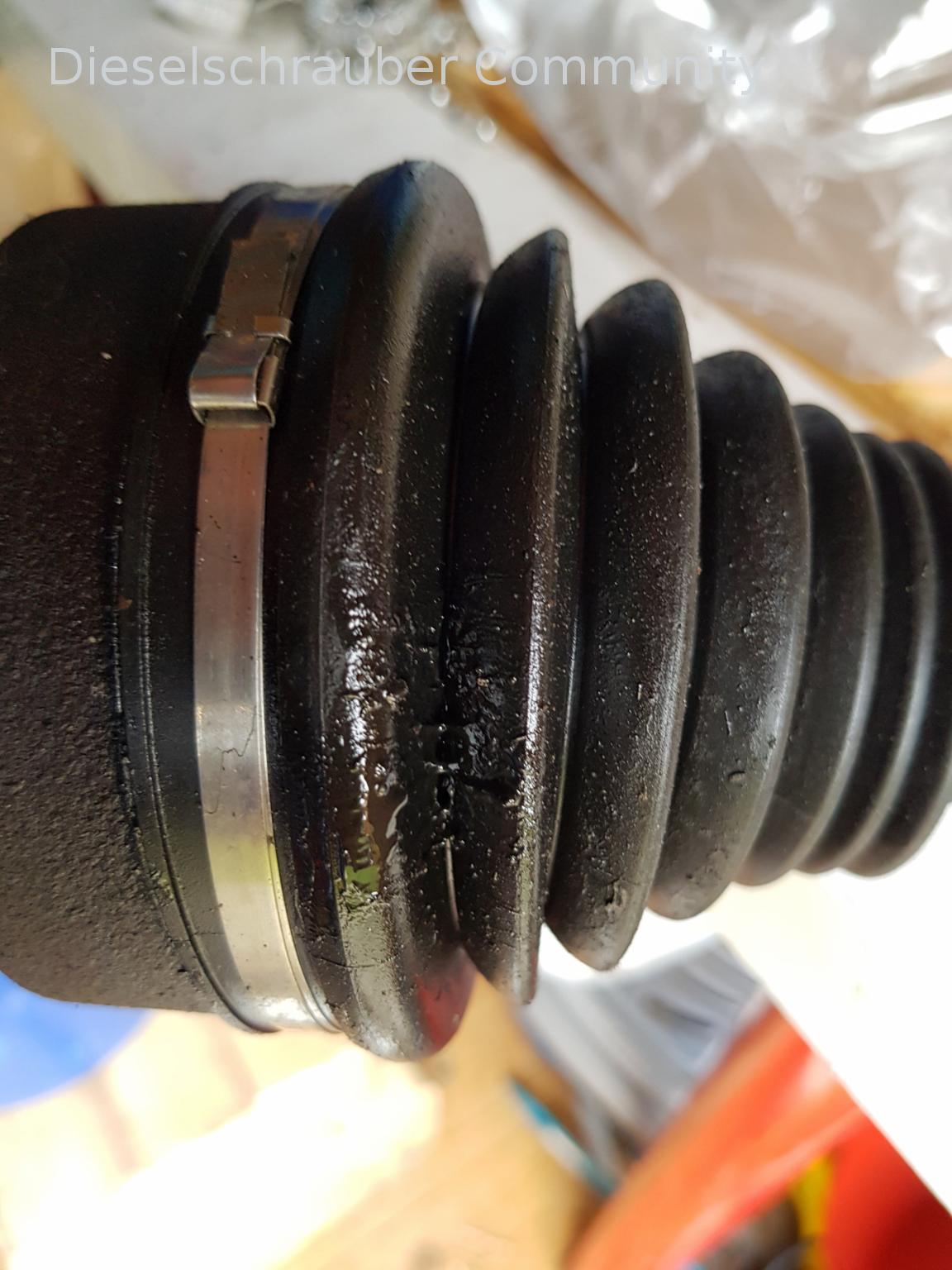

I once opened the suspicious hose clamp, but besides the coolant, I didn't see anything else and I didn't want to take it apart any further. What was noticeable was that only a cheap, loose hose clamp was attached to the flange; perhaps someone in the workshop also took a look.
