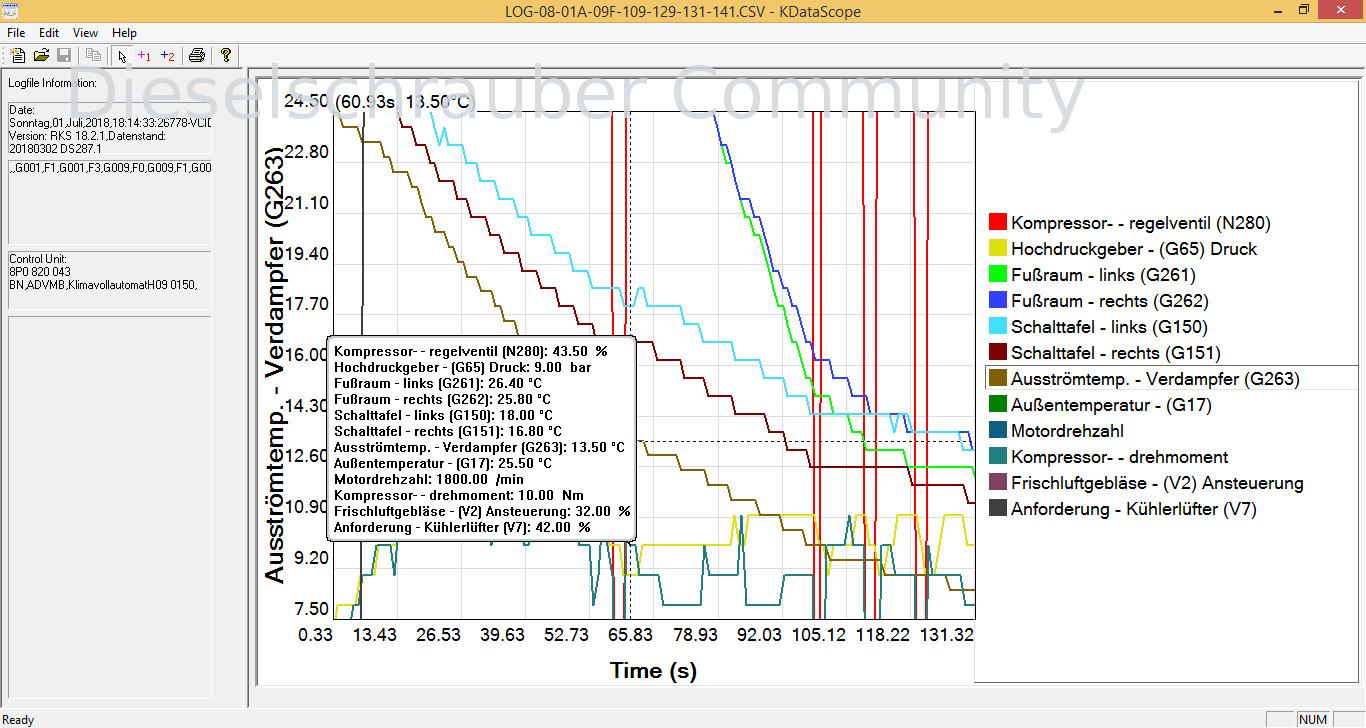

Post01-07-2018, 18:05    Subject: Quote
Hello Brezelmann,
Attached is the climate control log from my wife's A3. The car wasn't parked directly in the sun, but it was still warm inside. The outlet temperature at the evaporator decreased quite rapidly.
 Ausströmtemperatur am Verdampfer nach 1 min bei 25-28°C Aussentemperatur und Sonne.
 File size:  278.84 KB
 Viewed:  188 times
LOG-08-01A-09F-109-129-131-141.CSV
 Log Klimaanlage Audi A3

Post03-07-2018, 16:31    Subject: Quote
Hello!
Okay, I've carefully reviewed Rainer's log. I'm surprised that, despite the high outside temperature, he's able to achieve an interior temperature with an evaporator temperature of 8.5°C and relatively relaxed control of the ventilation system? Apparently, there isn't even an effort to further reduce the vaporization temperature.
My system is trying to regulate and maintain the evaporator temperature at approximately 2°C, given the current outdoor temperatures.
Regards,
Brezelmann.
P.S.: I replaced the dryer and blew out the expansion valve. A replacement valve (once and never again!) didn't fit, so I had to put the old one back in. Since then, the cooling performance has been significantly better! R134a was almost completely present; in fact, it was still within the filling tolerance!

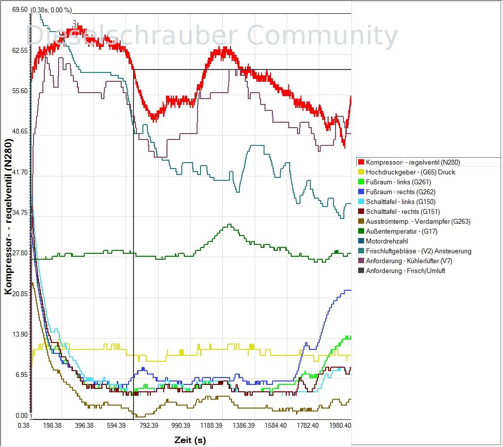

Post04-07-2018, 15:35    Subject: Quote
Hi!
Here's the log from today. The vehicle was parked in direct sunlight for hours and, as a result, was very hot. The evaporator temperature quickly rises to 2.5°C despite solar radiation and high fan speed.
I would therefore attribute the initial malfunction either to the dryer and/or to the expansion valve.
Maybe these logs will be helpful to someone else as well...
Regards,
brezelmann01
