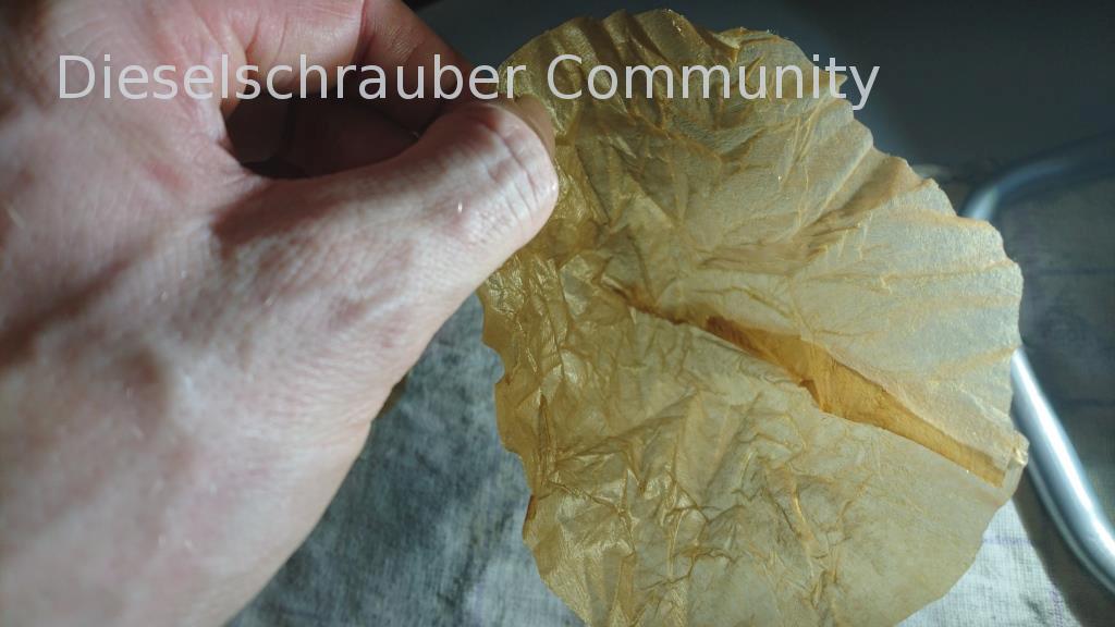

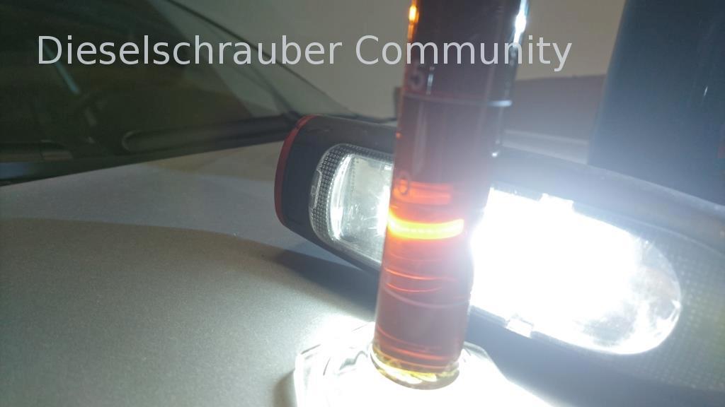

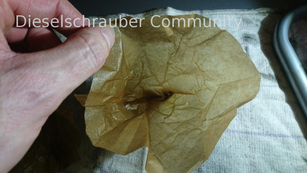

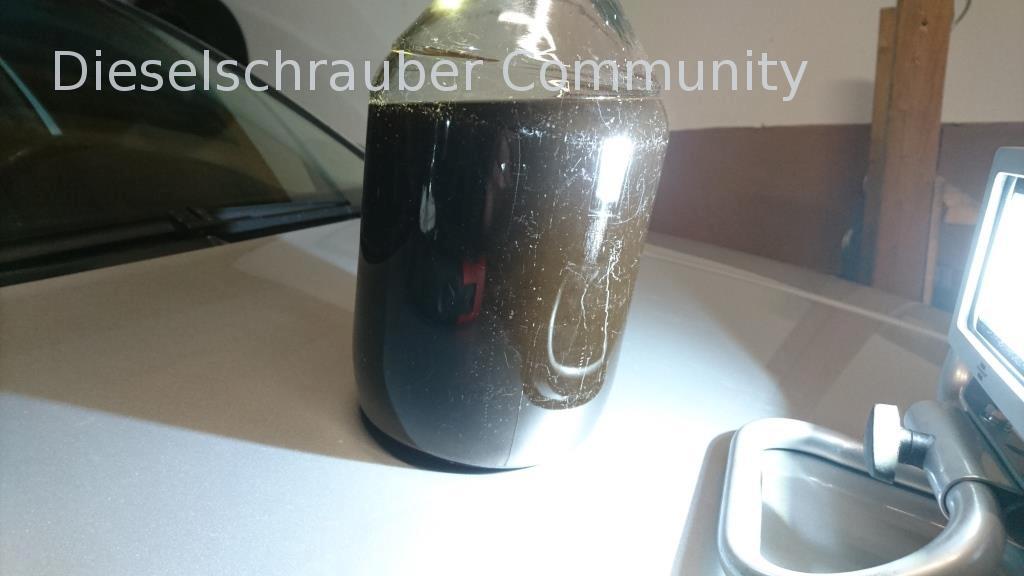

Good morning everyone.
Yesterday, I finally got around to examining the transmission oil. I checked again and realized that I had changed the oil about 63,000 km ago.
The oil is very dark, but it doesn't smell burnt or unusual. Upon closer inspection, you can see that it's clear and there are no metal shavings or debris floating in it. I still filtered the entire fluid, and even then, there was absolutely no residue on the filter. I would say that the oil is fine. What I'm hearing might be normal operating noises from the transmission.
Regards,
Reuselkopp.

Hi!
Well, that actually looks surprisingly good.
There isn't the smallest particle to be seen.
I initially thought that it might just be normal sounds from the treadmill.
To be honest, I haven't heard enough to form an opinion or comment on it.
When I think about my Golf, the transmission also rattles quite a bit when idling, especially if you're standing next to it.
But that's been the case for over 100,000 kilometers.
