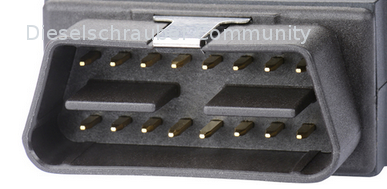

"It doesn't fit; the OBD-2 connector is different: the ridge in the middle has a slot." Putting it away is so impossible. icon_wink.gif

vwSchrauber
Joined: 09/18/2008
Posts: 1262
Post10-04-2020, 10:44    Subject: VCDS Interface for 24V systems Quote
Thank you very much!
Ideally, I would have connected terminals 30 and 31, as well as CAN L+H, to the interface using stranded wire and individual pin connectors. Regarding OBD access on a Doosan dump truck (Scania DC13, Euro3).
Luckily, I didn't do it icon_lol.gif.
