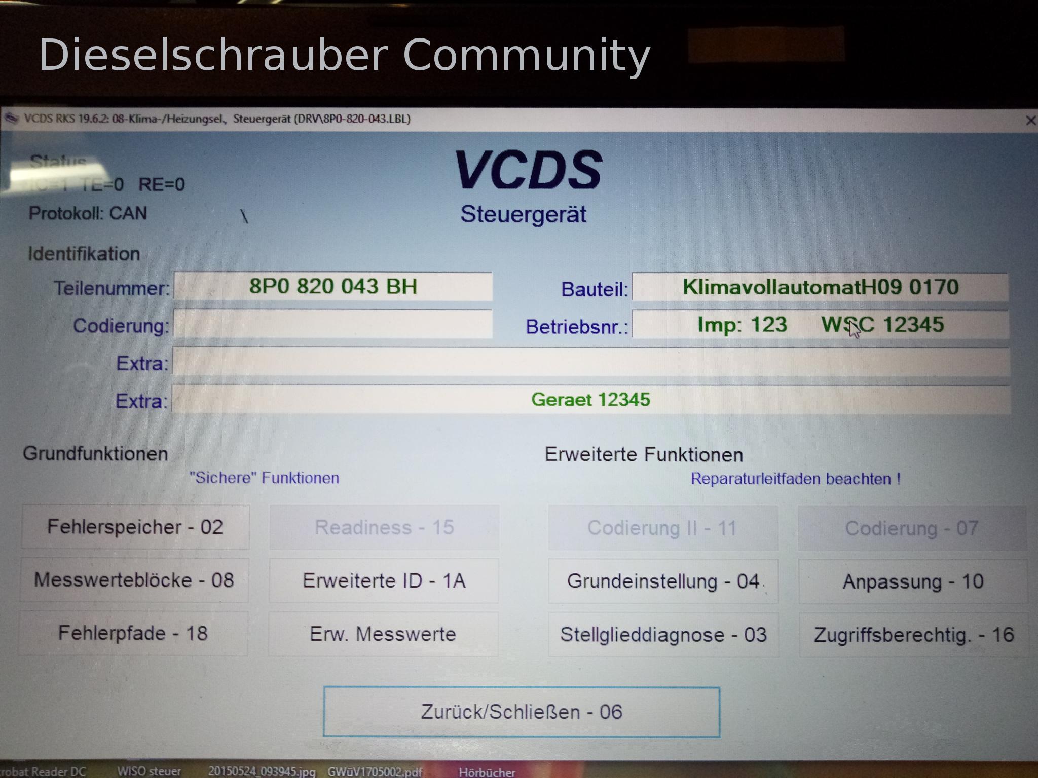

Now, however, I'm in a situation that I'm struggling with:
When I had my A3, I had Audi perform a software update of the climate control system from version 100 to 170. This was done to address a problem with the seat heating not working properly. From Audi, there is also a TPI.
After the update, you can also change the temperatures of stages 4, 5, and 6 in APKs 24, 25, and 26. So far, it's working... but! Since the update, the "Encoding" and "Encoding II" fields have been grayed out. This means I no longer have any way to encode anything. However, I was able to encode things (e.g., air distribution) in this STG before the update. As can be seen from the operating number.

 Coding and Coding II disabled after software update
