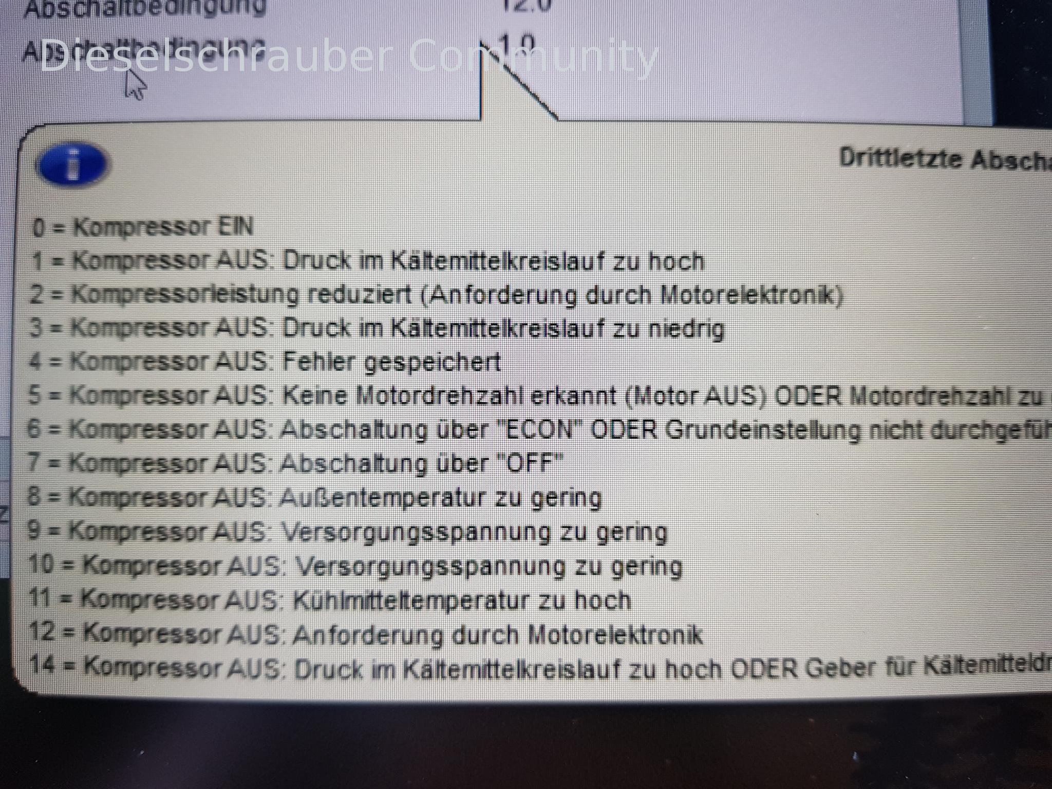

What does VCDS display as the explanation for "deactivation condition 1"?
If the compressor is powered on but not building pressure, it's likely seized. It's probably triggered the clutch. In case of a fault, record a video from the front side using your phone. That usually provides quite a good amount of information.

Post15-09-2020, 18:24    Subject: Air conditioner not cooling during speed fluctuations Quote
Okay, I understand. Please provide the German text you want me to translate into English.
The compressor only has one connection, likely for the control valve N280.
