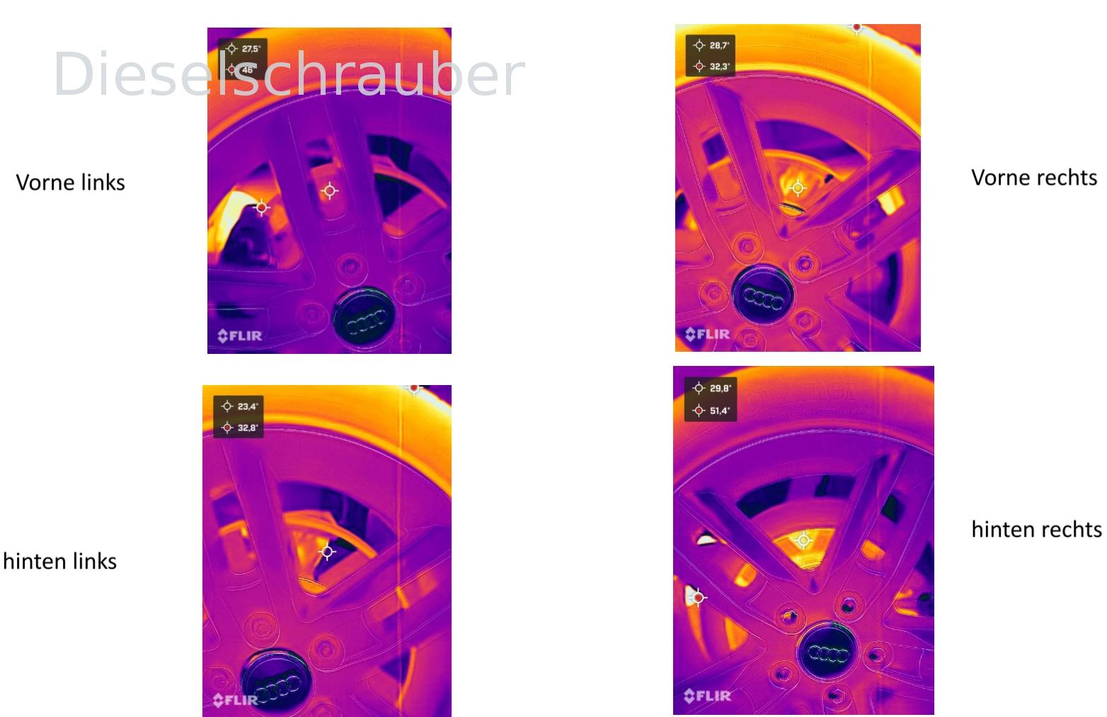

Hi!
Here's a quick check after 15 km on the highway at approximately 130 km/h. No braking was applied from a cold start. Outdoor temperature: 20°C.
Slightly elevated temperature on the right rear. This is also noticeable when the wheel is turned freely. However, the right side hasn't been slowed down as much as the left side (unintentionally).
LG
Brezelmann01
