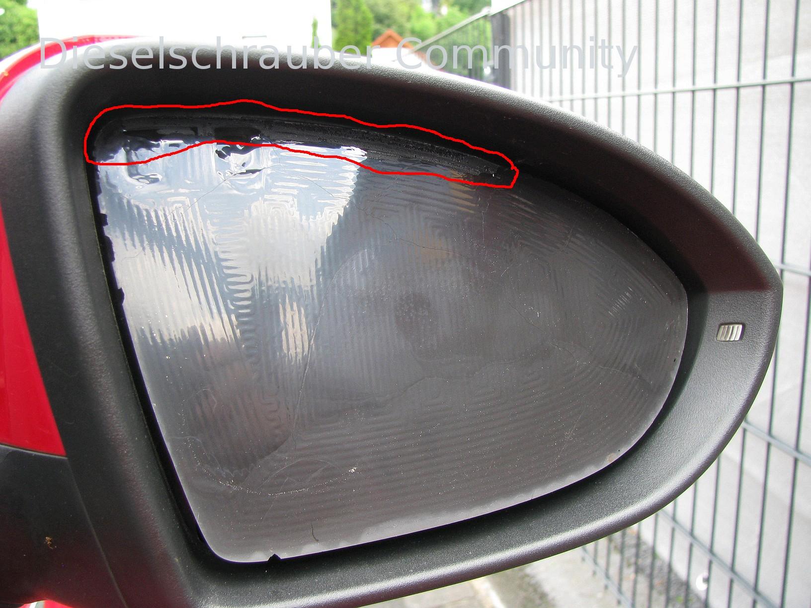

I finally had some time to take care of it. I carefully removed the two mirror glass panels from the heating film, which was still fully adhered to the plastic backing (as you can see in the pictures, there was only a minimal amount of adhesive left on the glass).
Then I removed the plastic backing with the heating films from the mirror housings, cleaned them with isopropyl alcohol, and applied double-sided tape over the entire surface, then trimmed it to shape all around with a utility knife: Tesa Extra Strong laying tape, extra strong adhesive, No. 05686-00018 - suitable for wet rooms and underfloor heating icon_cool.gif - Sticks like crazy icon_eek.gif.
It remains to be seen how long this will last, or whether the mirror heating will be able to handle it icon_cool.gif. "Definitely, nothing is loose anymore, and nothing from the tape seems to be showing through the glass – it's completely covered."
 Spiegelglas Beifahrerseite von der RĂźckseite - rot markiert die restliche Klebefläche (sorry, ist ein wenig unscharf)
 File size:  319.39 KB
 Viewed:  598 times
 "Spiegel" Beifahrerseite
Nur noch die Heizfolie - das Glas habe ich schon abgemacht.
Nur an der rot markierten Fläche war noch aktiver Kleber!
 File size:  504.12 KB
 Viewed:  1219 times
 "Spiegel" Fahrerseite
 File size:  471.77 KB
 Viewed:  2957 times
