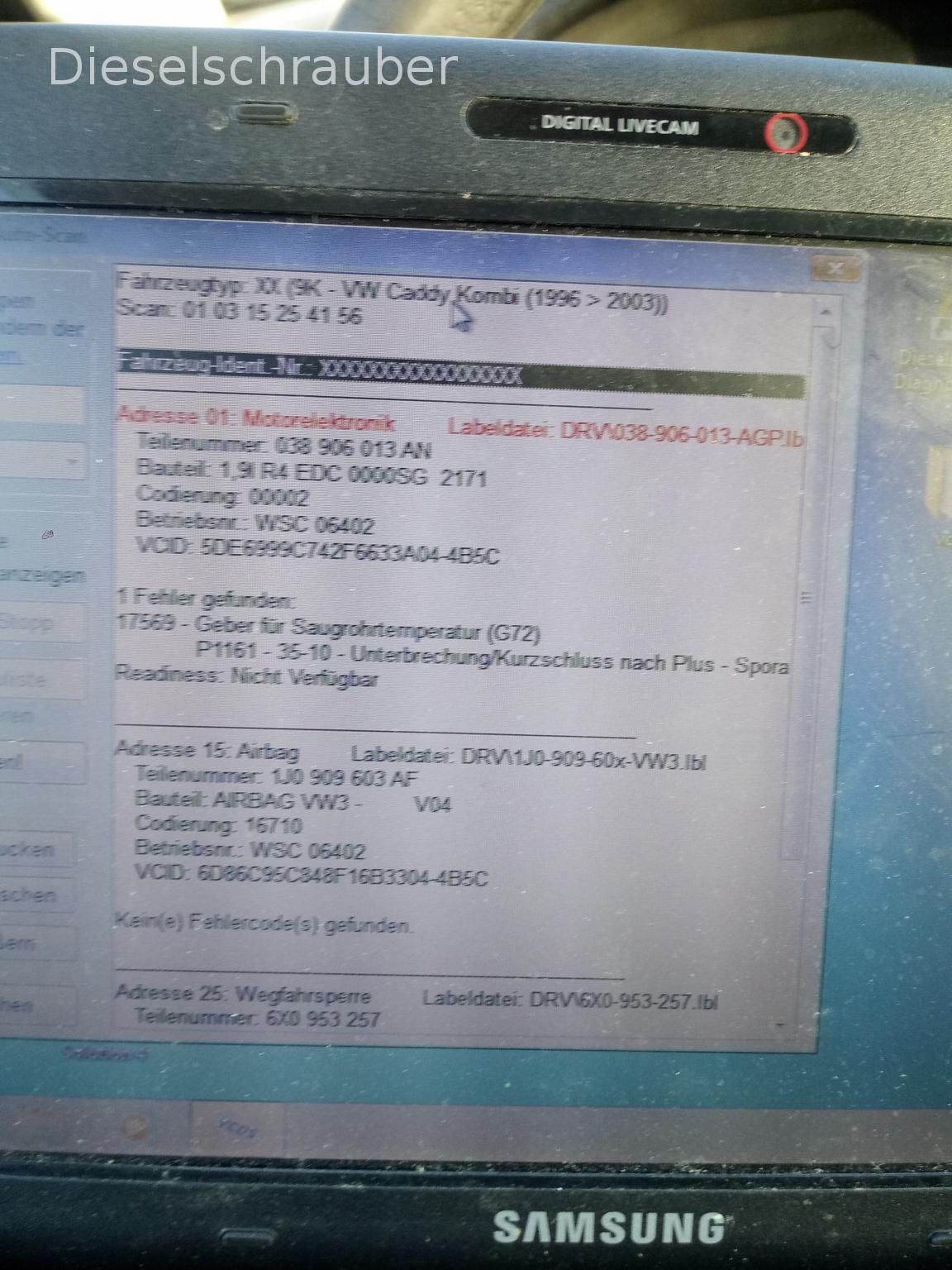

After a few days, it started emitting a very acidic, pungent smell from the exhaust. I thought the valve stem seals might be worn out, so I decided to replace all the gaskets. The intake manifold was full of black, tar-like residue, which seemed strange to me; I suspected someone had been using plant-based oil. I haven't driven the car much because people behind me were honking their horns due to the smell.
I'm at work now and can only attach a photo of the car scan.
There's an error listed, specifically the plug that needs to be disconnected in order for the vehicle to operate. When the plug is connected, there are no errors.
If anything else is needed, I can rescan the document tomorrow morning.

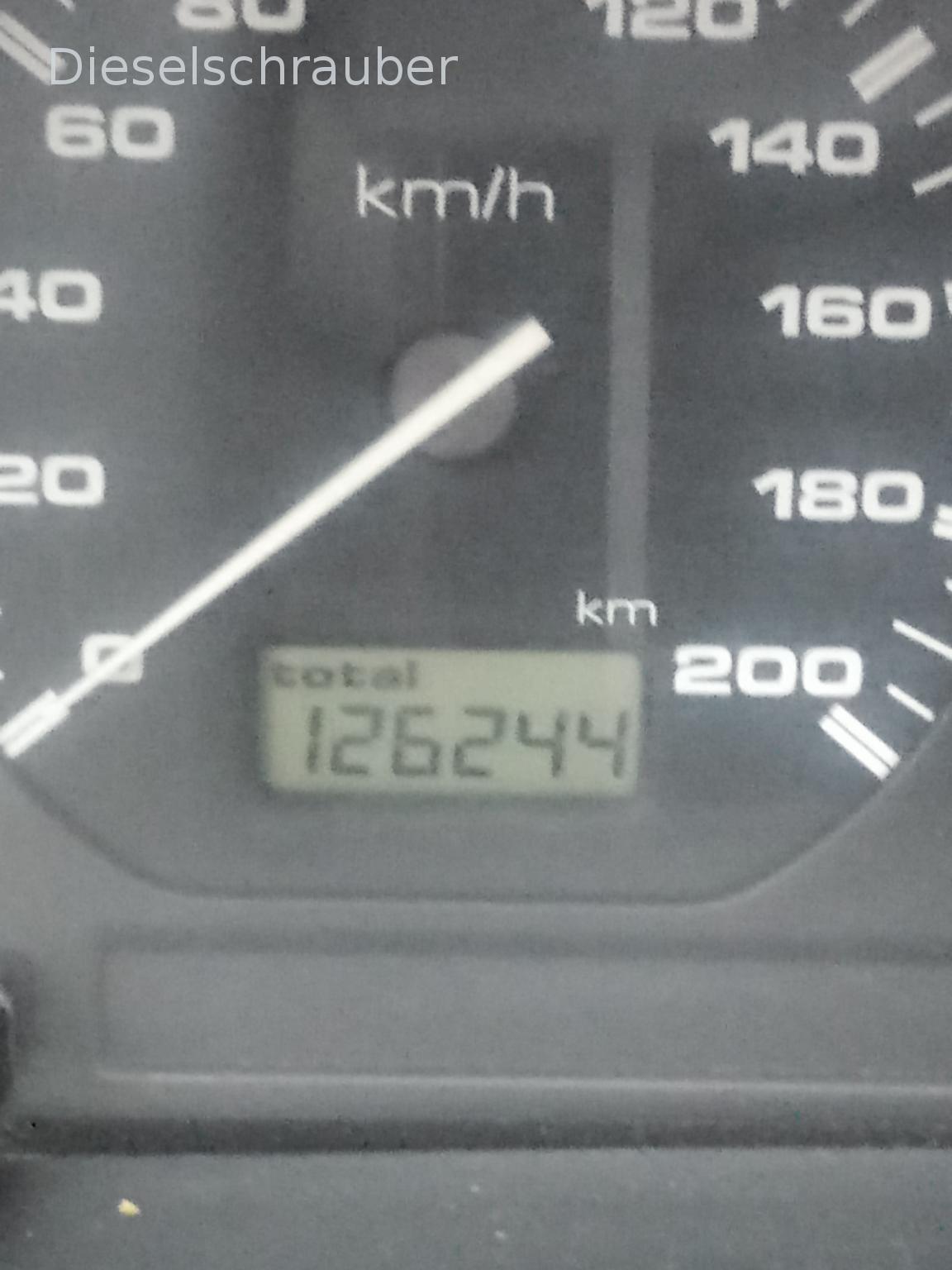

Does the display above the odometer still show "total"?
Not that the car actually has 4,240,000 kilometers on it, and the engine and fuel injection pump are simply worn out.

4,240,000 km? 4,240,000?
That would be icon_smile_thumb_up.gif icon_smile_thumb_up.gif icon_smile_thumb_up.gif icon_smile_thumb_up.gif icon_smile_thumb_up.gif.
Translated on 15-08-2026, 11:36.
3bAFN
Joined: 01/16/2013
Posts: 67
Karma: +33 / -0   Thank you, like it!
Post20-02-2023, 14:59    Subject: Engine Misfire: Grey Smoke Explained Quote
It should naturally be 424,000 km icon_lol.gif.

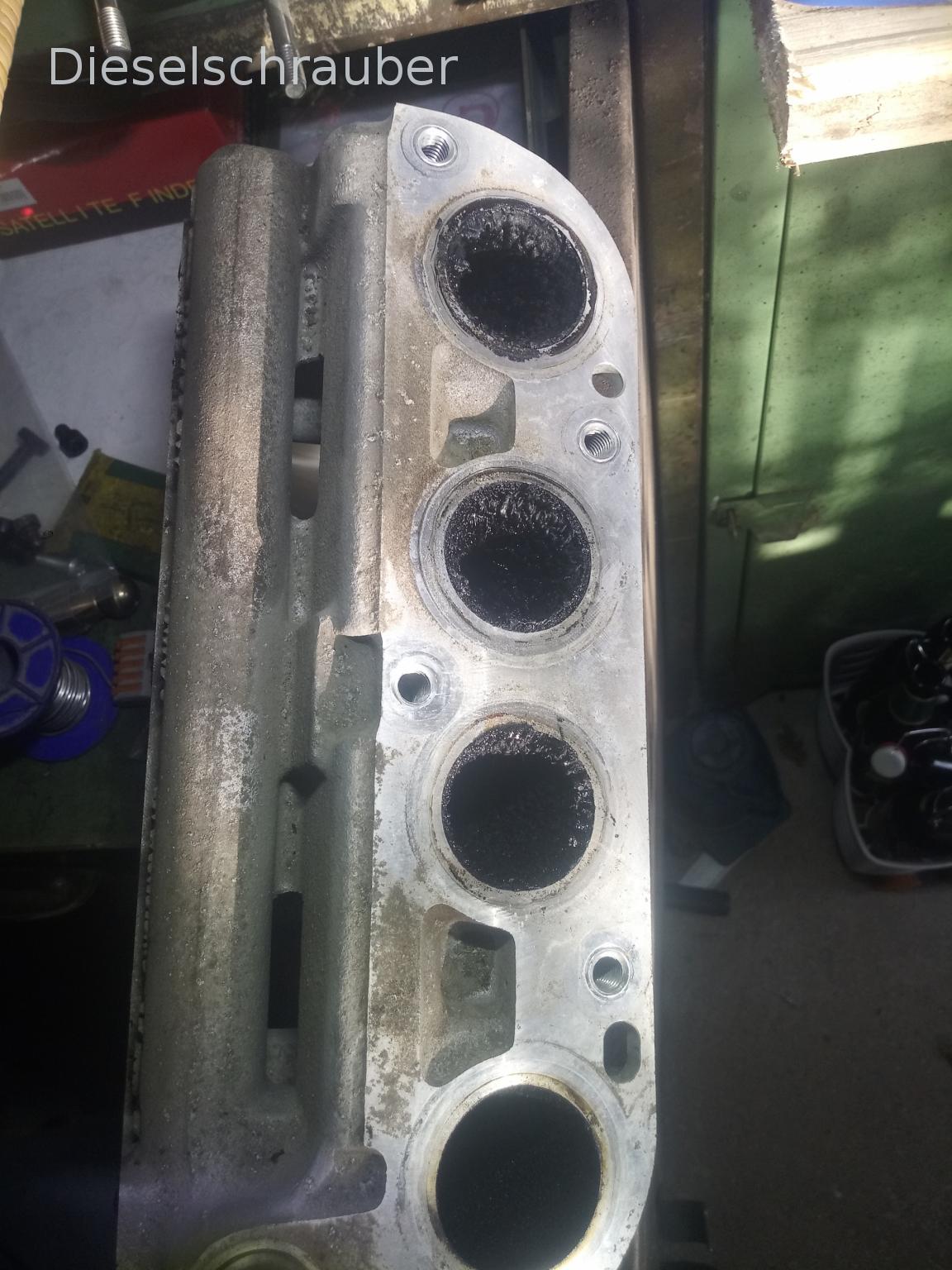

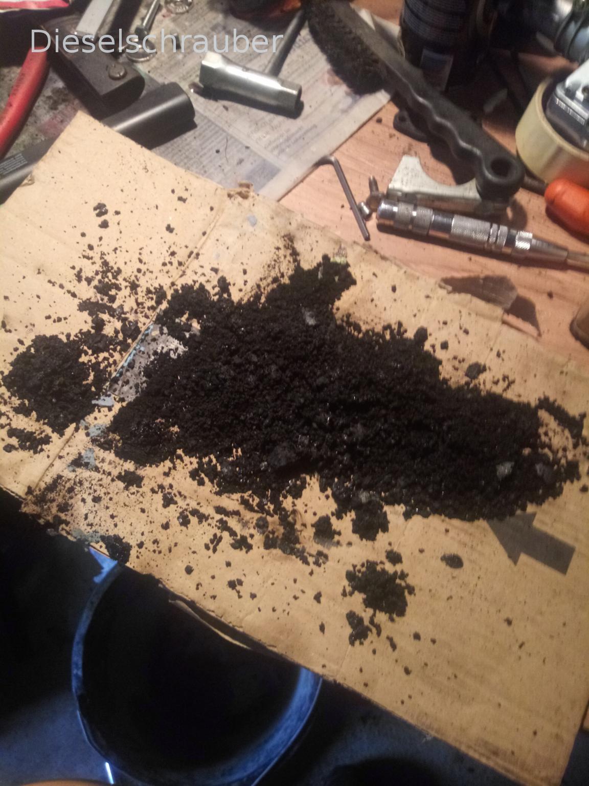

Yes, I cleaned the intake manifold and all those parts myself about four months ago.

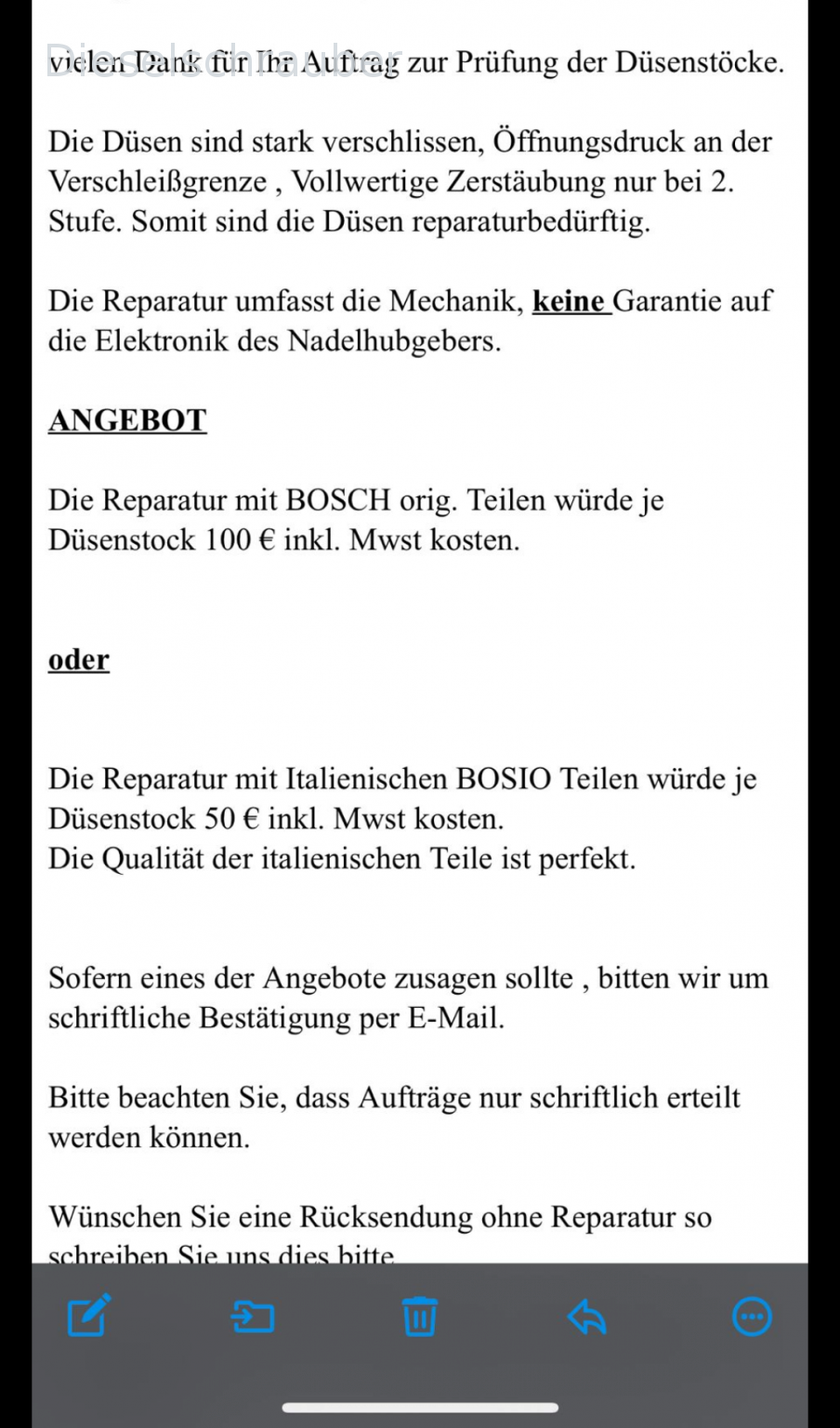

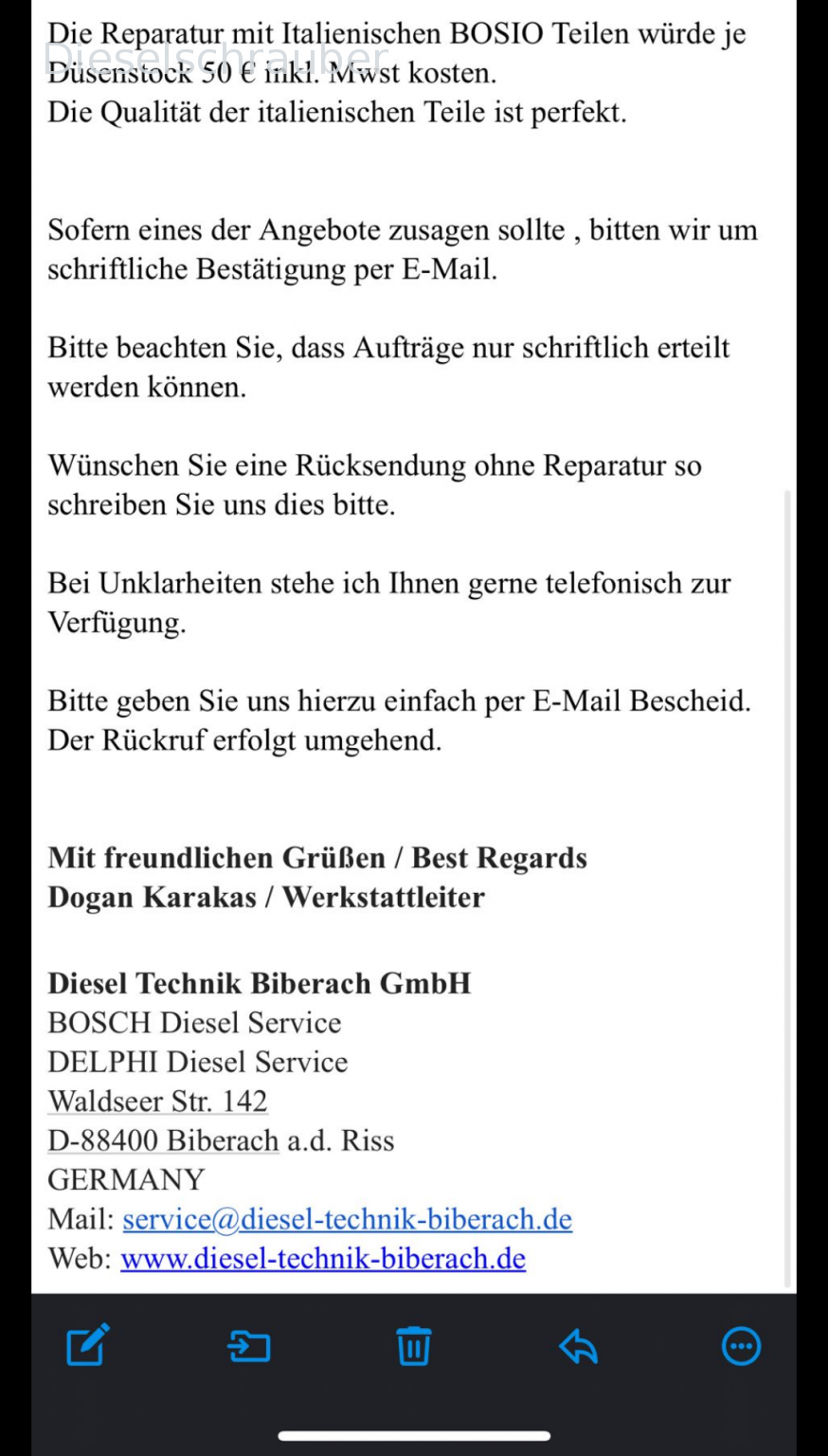

The injectors were sent to Biberach for regeneration. The letter simply stated that they were finished and included the price (approximately €280).

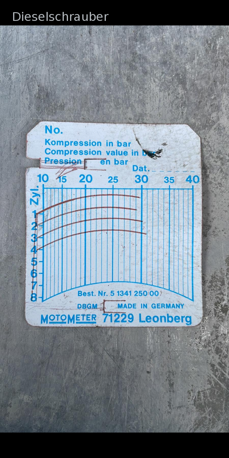

The compression could be more even, but it's still good. Have the channels in the cylinder head been cleaned?

The injectors were sent to Biberach for regeneration; the letter only stated that they were finished and the price (approximately 280 euros).
What exactly does "regeneration" entail in this context, and what should be included in that price?
"Addendum" or "Postscript."
"The injectors are delivered with test reports and can be reinstalled into the vehicle."
