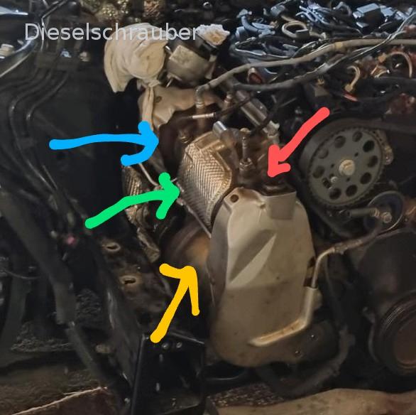

Am I correct in understanding that the first images show the position motor 2 (V339) for exhaust gas recirculation, located on the exhaust gas recirculation cooler? The portion of the recirculated exhaust gas that is controlled by this motor is diverted after the diesel particulate filter (DPF). And does the first injection of urea take place before the DPF?
Could you please tell me exactly what the first four images depict?
My humble suggestion is that the "gunk" might also be coming from the particulate filter.
It's exactly as you described. The first four pictures show the AGR valve in both the removed and installed states.
I've added a picture; the arrows indicate the following.
Red; Urea injection valve.
Yellow; DPF.
Green; AGR cooler.
Blue; EGR valve.
Best regards,
