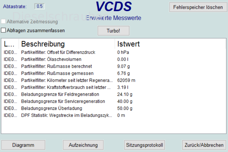

Hi there.
Particulate filter: Offset for differential pressure: 0 hPa.
Particulate filter: Oil ash volume 0.00 l.
best regards

Post10-12-2023, 20:57    Subject: Quote
Let me try to explain things to you.
Differential pressure measurement cannot distinguish between pressure differences caused by ash buildup and pressure differences caused by soot buildup.
The ash loading value is calculated based on the engine's mileage. Therefore, when adapting the system, a mileage value must also be entered.
The soot load is determined once based on fuel consumption (value: calculated soot load) and once based on the differential pressure (value: measured soot load).
If either of the two values exceeds the threshold for field regeneration, the regeneration process is triggered.
Unexpectedly high ash loading is interpreted as soot loading. This leads to excessively frequent regenerations. In the worst case, the ash overload is not recognized because the calculated value looks perfectly fine.
That's exactly what happened with your engine just now.
With a DPF that has been regenerated through flushing, not all of the ash residue is removed.
Translated on 29-09-2026, 20:06.

Post11-12-2023, 14:24    Subject: Quote
Thank you for the response! I don't want to give the impression that I'm just asking for help here, hoping that others will do the work for me. If it seems that way, please accept my apologies.
I had been thinking about this before the postings, even though it may not seem like it. Apparently, unsuccessfully. Therefore, I cannot understand why the value: soot load remains constant during regeneration, when it is calculated from the differential pressure, which, on the other hand, decreases.
Take a snapshot with the static DPF data
. Then, record this snapshot during the regeneration? Or after completion (which, in my opinion, doesn't make sense because all entries related to "since the last regeneration" will be set to 0)? Taking it directly before} (which would be desirable) is not possible because I don't know when the regeneration will start.
Thank you for the tips, best regards.
Edit:
In the attachment, you'll find the static values from earlier. Rainer suggested that I could save the parameters so I wouldn't have to search for them every time. How does that work?
 File size:  150.81 KB
 Viewed:  327 times
Translated on 29-09-2026, 20:13.
Posts: 18118
Post11-12-2023, 20:11    Subject: Quote
Find and save VCDS measurement values.
I'm not sure why the "measured" soot mass remains the same during regeneration, but if I understand correctly...
Apart from that, the ECU cannot measure the soot mass because it lacks a weighing device.
When it comes to both terminology and functionality, a certain degree of skepticism is always warranted, as much of it originates from various sources, some from the ECU itself and some from VCDS.
Incorrect terms or values may occur, although rarely.
If one of the two "soot mass values" decreases during regeneration, that would be acceptable to me.
However, it might actually be the opposite. The fact that it went back is a noteworthy detail.
Regardless of the ECU, the DPF can only contain what actually entered it, and not what the ECU estimates might be present.
Has the oil consumption been checked by you and deemed to be okay? I have no idea if a too-short dipstick for the engine from another vehicle is possible. As you can see, there are many possibilities. Now, let's see if cleaning the DPF stabilizes the situation and makes things okay.
Translated on 29-09-2026, 20:16.
