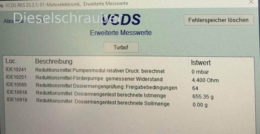

Netgear_99
Joined: 05/03/2024
Posts: 3
Post01-09-2025, 11:23    Subject: Reducer flow not detected Quote
Hello Rainer,
Thank you for your reply. The AutoLog is attached below. I removed the SCR valve and tested it using the dosing test. There was no leakage from the AdBlue hose connected to the valve either. The attached photo shows some of the measured values. How can I verify the correctness of the release condition (specified as 64)?
Best regards, Patrick.

Post01-09-2025, 16:56    Subject: Reducer flow not detected Quote
Thanks, no idea.
Reducing agent, level sensor: Current value: 0 mm.
Suppliers of tank temperature reduction agents:
It's possible that something is blocked, and the engine control unit (ECU) is interpreting that the AdBlue tank is empty?
I can check if the 0mm value is completely full or completely empty.
-> Check the level sensor.

Post01-09-2025, 17:51    Subject: Reducer flow not detected Quote
Unfortunately, I didn't have a Windows-based VCDS with me, and I missed the update... I'm seeing "17" as the value from the AdBlue level sensor, but unfortunately, it's displayed without a unit. Since my tank is quite full, 0mm might actually mean "completely full."

Post06-10-2025, 19:11    Subject: Reducer flow not detected Quote
Here's the solution to the problem. The AdBlue tank was replaced, and immediately afterward, the fill level could be read using VCDS. The subsequent test drive only corrected the range displayed on the instrument cluster.
Why VCDS did not perform the test for fuel quantity (see the post above) without displaying an error message is unclear to me.
I hope these insights can be helpful to someone.
