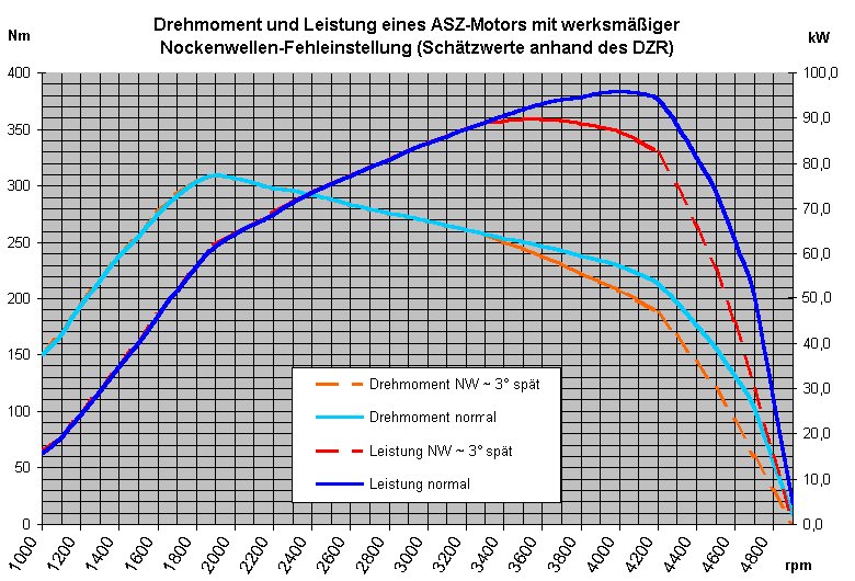

Post09-06-2004, 16:04    Subject: Quote
*dust blower*
Hello again,
I once tried using a dynamometer (DZR) to focus on recovering the approximately 2 horsepower that was missing from the engine at the factory, specifically in the range above 3400 rpm, which roughly corresponds to what my own subjective measurements indicated at the time.
To achieve this, I reduced the torque starting at 3400 rpm, which extended the time during which the engine produced 134 horsepower to match the value obtained at 132 horsepower with normal torque characteristics.
And suddenly, the performance curve looks much worse than the number "2 horsepower" initially suggests...
Interestingly, this aligns remarkably well with the results of a tuning test performed on several 96 kW TDIs.
"The series status is listed as:"
. . . According to the Hopa dynamometer test, our test vehicle only has 121 horsepower instead of 130. Additionally, the torque drops at 3400 rpm.
