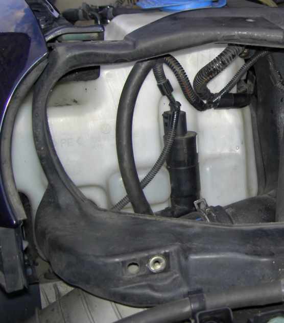

"Does anyone have a picture or exploded diagram of the inner workings and surrounding components of the right front fender of a Golf IV? I think that since the workshop replaced said fender, a rubber lip on the headlight and a plastic part at the top where it meets the windshield are missing (both are present on the left side) - but I'm no longer sure what it looked like..."

Here's a picture of the rubber lip. Unfortunately, I don't have an exploded diagram. However, since the structure is the same on both sides, it shouldn't be a problem to compare the parts. There's a plastic cover for the hood hinge, and on the fender, towards the window, there's another plastic cover clipped to the fender.
The part numbers for the covers are 1J0 819 447E and 448 E. Unfortunately, I no longer remember which one is for the right or left side, but the dealer can tell you.

The fender was replaced by a local workshop, that's why I asked here icon_smile.gif - Thank you both very much, that helps me a lot!

Here's a small tip while you're checking things: There should be two foam blocks in the wheel arch liner, one approximately at mid-height near the door and one centered above the wheel.
