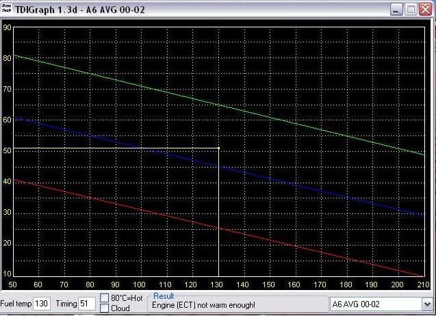

Regarding the log values: The first two full-load measurements were taken in 3rd gear, from 1500 to 4000 RPM, while the last cycle was in 2nd gear, within the same RPM range. The timing check was OK. I've attached a Screenshot. The point fluctuates between the ideal line and the displayed position.
I'm going to temporarily disable the AGR (if I can get the hose off) today and see if anything changes.

The fuel injection timing is perfect. The turbocharger pressure build-up also looks good. The HFM (likely referring to a sensor) isn't the best anymore, but it's still within acceptable limits. Those few small units that you're missing won't be noticed by anyone.
