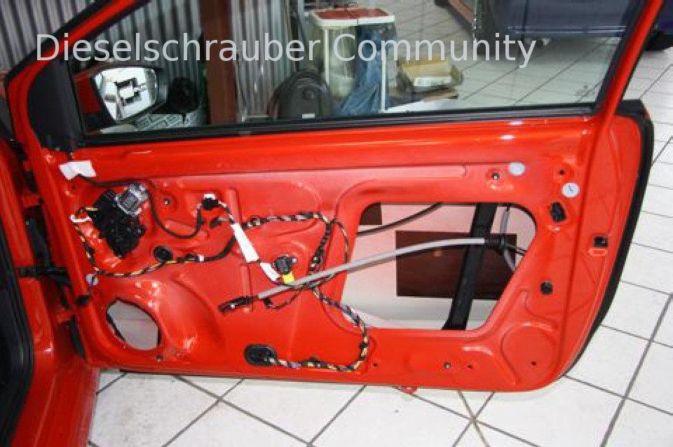

See the original post:
Since the window motor assembly position in my Polo 6R is next to the dashboard (instead of in the front seat knee area), it's no longer a simple "plug and play" conversion to manual window cranks...

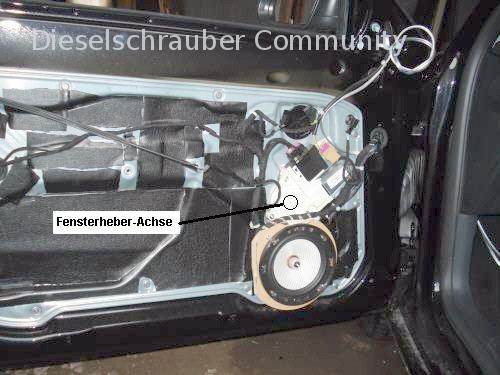

Take a look at where (approximately) the shift linkage axis is located in the red door of the Polo 6R, and compare it to the door of the Ibiza 6L below. I had converted the Ibiza to use linkages, but with the 6R, I don't want to have to cut away the outer ~20cm of the dashboard each time to allow the linkages to engage icon_confused.gif.

Das sehe ich schon, aber das spielt doch keine Rolle wo es bei der el. The version is installed.
The manual FH icon_wink.gif can be designed/made in a way that it's located somewhere else. Of course, this won't be 100% plug-and-play, and holes will have to be drilled, for example. But your electronics tinkering isn't exactly plug-and-play either, is it? }
