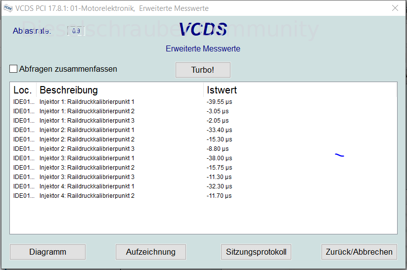

Post12-02-2018, 18:53    Subject: Oil Consumption After Highway Driving Quote
matthiasTDI96 wrote:
The (CHFC) is an EA 189 (which is a CR), correct? Therefore, it should not have a tandem pump or PD elements.
Absolutely correct.
Here are the measurements (hopefully they are correct).

Post12-02-2018, 21:43    Subject: Oil Consumption After Highway Driving Quote
I wouldn't necessarily consider the rail pressure calibration points as an indicator of a fault (my interpretation: they show the time at which specific rail pressures are reached during the injection cycle and are used to correct the injection durations).
The values for the variations in fuel injection amounts at idle would be just as informative, and perhaps also the control times/start times of each individual injection.
If a nozzle is not sealing properly, you can usually tell by looking at the appearance of the nozzle (specifically, the part that needs to be removed) in addition to checking the LL values.

Post13-02-2018, 8:12    Subject: Oil Consumption After Highway Driving Quote
Hello Gregg,
If you compare the calibration values with those of other users (see here: https://community.dieselschrauber.org/en/viewtopic.php?t=28779),), then I would claim that your nozzles are leaking and dripping.
Does the exhaust smoke blue/black? It could also be due to modifications, especially if the fuel rail pressure was increased using a resistor.

Joined: 06/22/2005
Posts: 4622
Karma: +1339 / -0   Thank you, like it!
Post13-02-2018, 9:59    Subject: Oil Consumption After Highway Driving Quote
if you compare the calibration values with those of other users (see here: https://community.dieselschrauber.org/en/viewtopic.php?t=28779),), then I would claim that your nozzles are leaking and dripping.
Please enlighten us about what exactly you are basing this on. To me, the values seem to fall within the range reported for R4 engines in the link provided. I don't think we even have clarity regarding the measurement principle. For example, calibration point 2 sometimes appears before calibration point 1.

Post15-02-2018, 13:37    Subject: Oil Consumption After Highway Driving Quote
Hello Herbert,
I'm afraid I have to agree with you. That was nonsense. I've just realized that.
that the calibration values are used much less for determining the actual quantity limits, but rather to smooth out pressure fluctuations in the system.
There is a doctoral thesis that I am unfortunately not allowed to publish here, which shows that the adjusted pulse duration achieved through calibration only corrects for pressure waves. In other words, it smooths out pressure waves.
This all happens within the range of 0.001 milliseconds.
For those who are interested: You can find information on this topic under the title "Injection Quantity Correction in Common Rail Systems Using Magnetoelastic Pressure Sensors."
According to my research, actuation times (from the control unit) of up to 1.4 ms are considered normal.
Corrections like the one mentioned above, such as an injector time of approximately 0.040 ms, would therefore not be dramatic.
