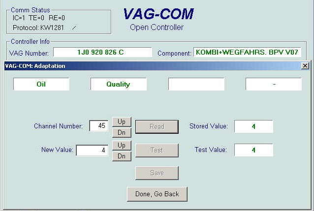

Post28-11-2005, 21:01    Subject: Longlife Oil Change: Benefits & How-To Quote
Besswerwisser wrote:
I'm not aware of an adaptation channel 45 existing for the Golf 4.
You not, but I:
 File size:  48.64 KB
 Viewed:  4519 times

Post29-11-2005, 16:20    Subject: Longlife Oil Change: Benefits & How-To Quote
Bertil wrote:
You don't, but I do :
What is the current coding of your AI?
http://wp1013454.wp025.webpack.hosteurope.de/pics/no_45.png
Translated on 14-08-2026, 2:44.

Post29-11-2005, 17:09    Subject: Longlife Oil Change: Benefits & How-To Quote
Unlike your korrekt! (01112).
Your car is programmed for the US market. There is no "Longlife" oil change interval available there, regardless of what features are retrofitted.
There are actually some combination receivers that no longer have channel 45 (which was eventually changed to MJ04).
No idea why.
The G5 has reconnected with him (1 = fixed interest / 2 = light interest). Don't ask about the meaning.
Translated on 14-08-2026, 2:45.

Post29-11-2005, 17:24    Subject: Longlife Oil Change: Benefits & How-To Quote
Bertil wrote:
Unlike your korrekt! (01112),...
Your car is coded for the US market. There is no "LongLife" oil specification there, regardless of what features are retrofitted.
See above, I've updated the Screenshot again; the country code has no influence on the WIV adaptation channels, neither for this AI/vehicle nor for others. icon_rolleyes.gif
Bertil wrote:
The G5 has him again (1 = fixed interest / 2 = low-level interest). Don't ask about the meaning.
Because there are no more coding options available, and the WIV guidelines have finally been implemented correctly. icon_wink.gif
P.S.: But ultimately, none of this solves the original poster's problems... he really needs to post the relevant data so that people can help him.

http://wp1013454.wp025.webpack.hosteurope.de/pics/with_45.png
Bertil wrote:
There are actually some combinations that no longer have channel 45 (eventually MJ04).
No idea why.
VDO combination instruments do not have channel 45, while Bosch/Motometer combination instruments do.

Post29-11-2005, 22:18    Subject: Longlife Oil Change: Benefits & How-To Quote
Therefore, we are both right.
I know that. I didn't claim that there isn't a channel 45 in general... icon_smile.gif
@awissus001Viewing profile: awissus001
Instead of searching, check the service booklet for the code "QG1". If it's not listed there, you don't need to look any further because your car doesn't have long-life oil specifications.
