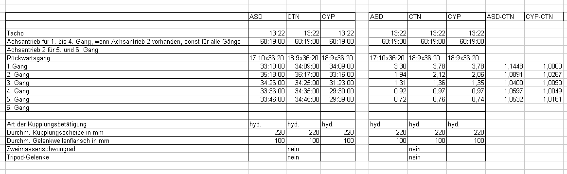

Since my CYP gearbox is defective, I'm considering installing the ASD gearbox from a 90hp TDI engine into my AFN engine. The ASD gearbox has a longer gear ratio than my CYP gearbox, and it would likely also improve the top speed. What do you think about such a conversion?

Is ASD longer than CYP?
Really?
If you have the data from the GKB.html file that I mentioned, try consulting other sources as well.
Generally, GKB.html is my go-to resource, but no resource is perfect, and I've already found some errors in it.
I can hardly imagine... Oh crap, AFN in the Vari has the CYP, which could very well be shorter than the ASD (1Z in the standard G3).
Then I'll get an ASD icon_smile.gif too.
which only has a 4-speed gearbox, because the 1st gear in the CTN is an off-road gear, but not really intended for the road icon_confused.gif ... so short, as it is.
Translated on 01-10-2026, 21:32.

@dieselmartinViewing profile: dieselmartin,
"Yes, the ASD (automatic slip differential) is consistently longer in terms of gear ratios than the CYP. Before I got my Variant, I had a Limousine with the 90PS TDI engine, and I found the gear ratios to be great. The 1Z engine pulled strongly in all gears. So, the disappointment was significant when I drove my Variant. I kept thinking something was wrong with the car when starting in first gear because the first gear is so incredibly short. This choice of gearbox is really incomprehensible to me, especially since the CYP was also used in the AFN Limousine (GTI TDI)."
Translated on 01-10-2026, 21:34.

Okay, I compared ASD-CTN-CYP to our table http://www.dieselschrauber.de/GKB.html.
The CYP is almost the same as a CTN (sometimes 1-2% longer).
The ASD is already doing quite a bit more.
You're saying that AFN has CYP in Limo and Vari?
What is the maximum speed (Vmax) that the AFN achieves?
My thoughts on this:
To the best of my knowledge, the newer TDI models are designed such that the maximum power output also corresponds to the maximum speed.
Furthermore, I assume that the 1Z and AFN engines have the same maximum power output at the same engine speed.
If the AFN is now significantly faster than the 1Z (which I believe), the 1Z will not be able to reach its maximum power output in 5th gear.
This, in turn, means that if you have a more powerful 1Z engine, you will definitely have a higher top speed (which is not usually the case, as the peak power is not typically shifted on the RPM scale).
With a strong first gear, a longer overall gear ratio becomes worthwhile again.
1Z Variant, top speed: 175 km/h.
Let's say the top speed is 193 km/h.
So, a strong 1Z can already achieve 193, even with the same CTN as the CYP.
If he then gets another ASD (5%) longer, something really good should happen icon_twisted.gif, like 202 or so.
Understandable, comprehensible?
