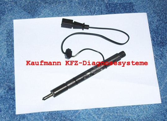

Hello everyone,
unfortunately, I recently realized that I apparently couldn't see things quite correctly. icon_question.gif
It started when I ordered an OBD2 interface from the shop and started poking around in the error memory.
The error memory for the engine informed me that the cable of the throttle position sensor was broken or that the B+ line was shorted to ground.
After I lifted the rocker cover of my car for the first time since buying it,
I thought that my more or less modest technical knowledge should be enough to
find the throttle position sensor (TPS). It wasn't a problem with my old 1z Audi.
However, with this engine, I was unable to find it. I couldn't believe it...
A look in the workshop manual showed me that cylinder No. 3 normally houses the NHG.
Since I am sure that I have found the injectors, because the piping came from the VEP, I wonder where this rascal is.
The thought occurs to me that this one was removed by one of the previous owners. Could I be right? If so, what does the connector look like? Where is it normally located?
I would be very grateful for a short tip, photo, or a hint.
I am very confused. Therefore, I hope for a quick response.
Thank you very much.
Greetings from sunny Baden
Marco

Okay, the nozzles run directly through the cylinder head cover (which you have already found icon_biggrin.gif). The NHG (Nitrogen Humidification Generator) is located on the right bank, facing forward. If you stand in front of your car on the left side, it's the middle nozzle. Under the cylinder head cover, right next to this nozzle, there is a recess in the cylinder head (on the intake side). The cable from the NHG has a half-moon shaped seal that seals this recess. Follow this cable until you find the plug.
Unfortunately, I can't explain it any better, but it should work now...

Post28-02-2006, 11:13    Subject: Missing needle lift sensor on AKN 2.5 TDI Quote
Well... how was it back then with the TDI engine and the gasoline transmission? icon_lol.gif
 File size:  42.7 KB
 Viewed:  15212 times
