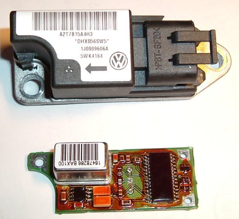

Hi, I've made a little more progress.
I received the defective sensors from the customer. They are sensors from Temic (MRSA Sidebag). Inside, there are two ICs among other components, but these ICs have custom markings.
A 28-pin Motorola IC with the following inscription:
MRSA VW V3.0W
0F82B
CTCTAK9642
The second one is an SO8, the markings of which I cannot identify under the layer of paint. A picture of the sensors is attached.
Is anyone in the forum who can tell me more about the sensors? Feel free to contact me via PM or email (Dieselschrauber's username at gmx.de).
As I said, all I want to do is disconnect the sensors without getting an error message. The side airbags have already been removed, so the sensors are unnecessary anyway.
Thank you and best regards.
Guste.

Posts: 18135
Post18-07-2006, 8:51    Subject: Passenger Front Airbag Deployed. Quote
I'd say something digital is coming out of it. Connect an oscilloscope/logic analyzer.
Translated on 15-09-2026, 16:24.
Ross-Tech-Support
Joined: 05/30/2005
Posts: 646
Post18-07-2006, 13:22    Subject: Passenger Front Airbag Deployed. Quote
Rainer K. wrote:
I would say that something digital is coming out of it.
Correct, a data transfer takes place, during which, for example, the sensor's ID/version is transmitted to the control unit.
Translated on 15-09-2026, 16:25.
Joined: 07/27/2004
Posts: 2406
Post18-07-2006, 13:41    Subject: Passenger Front Airbag Deployed. Quote
Oh, so my fears about the 1-wire bus, including the power supply, have been confirmed (the sensor only has GND plus one additional wire that has to carry the power supply, data, and crash signal, so it's probably a modified Dallas 1-wire).
I didn't think the crash sensor would operate using a digital signal. Surely, it should transmit the impact information analogously, or the bus must have a very high speed to keep the delay until the trigger reaches a reasonable level.
Thanks, Sebastian, for the information. Now I know that I can't emulate it so simply.
It would be interesting to see if I could trick the triggered sensor into thinking it never triggered. I could then install the formerly triggered sensors in my car (which doesn't have side airbags anyway) and give the ones that haven't been triggered to the seat buyer. However, that would probably require quite detailed information about the sensor.
Best regards,
Guste.

Ross-Tech-Support
Joined: 05/30/2005
Posts: 646
Post18-07-2006, 15:08    Subject: Passenger Front Airbag Deployed. Quote
I may need to qualify that statement somewhat, as newer airbag systems do that, but I can't say whether that applies to your older "VW2/3" model.
