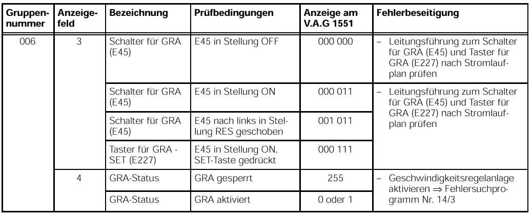

I assume that the GRA is successfully enabled in the STG.
What does the last field in block 006 say?
Does the letter "G" appear on the initial login screen when you access MSTG?

T3Tobi
Joined: 05/19/2005 Posts: 8 Karma: +0 / -1
07-09-2006, 13:14 Subject: Cruise control not working (1Z) |
Quote |
Yes, it's enabled; for me, the value is 0 (a value of 255 or 225 would indicate that it's disabled).

bindpe Blaumann
Joined: 08/25/2006 Posts: 203 Karma: +5 / -2 Location: ingolstadt
07-09-2006, 18:50 Subject: Cruise control not working (1Z) |
Quote |
Hello T3Tobi.
255 indicates that the GRA (presumably a system or service) is blocked.
