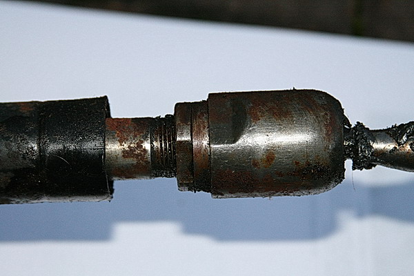

Especially for Rainer... Quickly went to the warehouse, took a steering gear rack from the shelf and took pictures icon_wink.gif.
It's actually the simplest thing in the world. icon_wink.gif Don't you have something like that on your shelves? icon_mrgreen.gif
It should be clearly visible in the picture.

Post10-12-2006, 17:27    Subject: Tie Rod for VW Golf 2 Quote
It's actually the simplest thing in the world. icon_wink.gif Don't you have something like that on your shelves??? icon_mrgreen.gif
You can also clearly see the lock nut icon_wink.gif.

Thank you for the tips! After I icon_cool.gif bit off the grease and pushed the collar all the way back, there was suddenly a lock nut icon_question.gif.
