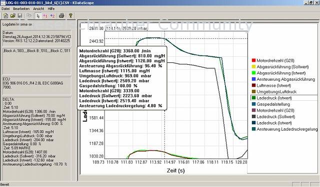

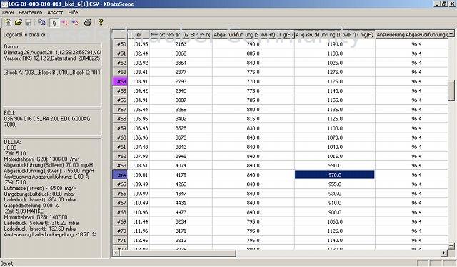

What is KDataScope good for?
KDataScope is a program for viewing recorded VCDS, KOBD2Check, or GS-911 log files, allowing you to quickly and easily overview and analyze the recorded data.
The KDataScope program is an easy-to-use alternative to VAGScope, which has the following advantages:
- Quickly locate interesting data points using the variable zoom function.
- Automatic scaling of measurement curves.
- Measurement values as a tooltip for the cursor position in the log.
- Delta cursor.
- Create 3D views (maps) from measurement curves.
Without conversion clutter, without pointless clicking. Nothing needs to be converted or awkwardly configured, nothing needs to be awkwardly imported into spreadsheets: Double-click the log file, and view it!
Whether as measurement curves with and without zoom, as tabular numerical values, or for chip tuners to generate/identify 3D characteristic maps.
Do you want to test KDataScope for free? Download the KDataScope demo version!
"Suggestions for improvement are welcome."
The current KDataScope version from Kaufmann Automotive is included in the diesel tuning VCDS distribution and in the RKS+CAN (KOBD2Check OBD2 tool, KCANMonitor CAN sniffer), but can also be purchased separately.

 CSV Dateien von VCDS oder KOBD2Check ansehen, Tabellenansicht.
 File size:  62.61 KB
 Viewed:  4465 times
 CSV Dateien von VCDS oder KOBD2Check ansehen, Messwertkurven.
 File size:  65.16 KB
 Viewed:  4286 times

Thank you for the tips! Zoom is already available; you can create a rectangle with the left mouse button, and the view will zoom into that area (click in the upper left corner and drag to the lower right while holding down the left mouse button).
In the opposite direction (from the bottom right to the top left in the diagram), it zooms back out.
You can change the x/y axis scaling by clicking on the endpoint value.
Translated on 22-09-2026, 1:42.
