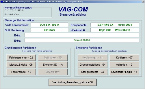

Ross-Tech-Support
Joined: 05/30/2005
Posts: 646
Post13-07-2007, 14:46    Subject: Tire Pressure Monitoring System (TPMS) Coding Quote
It's not reading anything other than the ECU part number; we already have the coding information. However, it would be helpful to have the vehicle data carrier or its option codes so we can identify things like the brakes, etc.
Translated on 22-09-2026, 12:44.

Joined: 03/13/2003
Posts: 10121
Location: in der Werkstatt
Post13-07-2007, 15:25    Subject: Tire Pressure Monitoring System (TPMS) Coding Quote
Here's the ABS:
 File size:  43.34 KB
 Viewed:  14264 times
Translated on 22-09-2026, 12:45.
