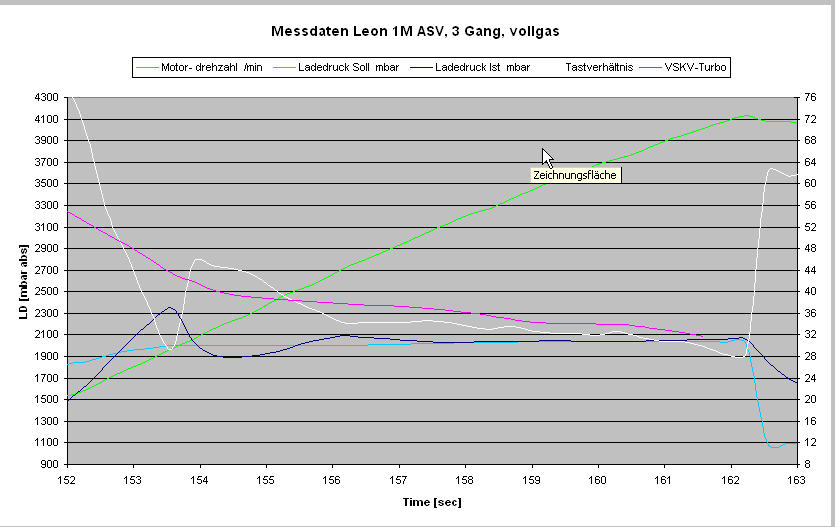

I would like to post my logs here as well, but I can't get the data off my laptop. It still has Windows 95 without USB, and while it has a floppy disk drive, my home PC doesn't. So, I need to figure out some way to connect them before I can post any measurements.

I have now reached the point where only natural wear and tear is considered a possibility,
How should the wear manifest itself? Increased play in the connecting rod? As far as I know, these are oil pressure compensated, so the actual play shouldn't change...
Or are you suggesting that the valve timing gear (VTG) is causing a delay, so that the impeller blades only respond to the pressure from the can after a certain amount of travel? This, too, could increase the over-travel - unless some gas forces are constantly pushing the impellers in a specific rotational direction during operation, thereby reducing the actual interaction between the blades and the can membrane to zero...?
Perhaps someone could disassemble their aging VTG loader and post the maximum play allowed on the control lever before the buckets start moving.

Since my partner's ALH Ibiza, despite having a very smooth-operating variable turbo geometry (VTG) system (as confirmed by a nozzle test), sometimes delivers excessive boost (up to >0.3 bar according to the logs), I decided to try addressing the issue from a software perspective.
I compared the specifications of the pre-tax KF (presumably a component or system) with the logged TV data across the entire operating speed range, as shown in the attached document.
When the systematic error is acceptably small or zero, the white line of the logged TV signal can be considered an approximate representation of the actual TV power requirement when LD is equal to the setpoint.
And lo, the pre-tax KF (purple line) aims everywhere at an LD above the setpoint, thereby intentionally causing overshoots at first, which are then brought down towards the setpoint during the course of a control intervention.
Jochen's posts, with their deliberately exaggerated settings for a lively engine character, have at least been confirmed on our Ibiza - however, I can't accurately estimate to what extent the log data is already skewed due to the mileage (currently ~82,000 km) compared to a new car.
When the weather and my time allow, I will gradually increase the length of the VTG rod. This will shift the TV requirement for LD (Ist = Soll) upwards in the diagram (towards the purple line), and the overshoots should decrease (and the response behavior will become more sluggish, I know icon_wink.gif).
To be continued...

Jochen_145
Guest
Post25-11-2007, 16:28    Subject: ALH Load Disconnect Control System Quote
Hello Ulf,
I once created a comparable MBW11 log in the middle of last year, similar to the one you created.
The behavior is fundamentally the same. However, due to the larger amount of ASV (standard software), the duty cycle in the VSKF is significantly lower than in the AHL.
Basically, based on your log, I wouldn't see any signs of aging.
I know directly from application specialists that the 'overshoot' is a 'stem element.' That's why I've always passed that information on.
I find what the person from Bavaria said above to be interesting:
The overshoots at engine speeds below 3250 RPM are not critical for the ATL, as the volumetric flow rate is relatively low. Overshoots only become critical at engine speeds above 3500 RPM, therefore, you should definitely check the following:
This also confirms my assertion that the load on the charger is dependent on the current flow and, therefore, overshoots in the low RPM range are perfectly acceptable.
Unfortunately, this also means that you and Rainer have invested a lot of work, which is partially useless.
But, well, the timing of the VSKF at high speeds remains an important point that must not be forgotten. Therefore, your work is not entirely in vain.
You need to imagine that the pre-tax settings in the software must be calibrated to be so robust (in the sense of a minimally required boost pressure build-up dynamics) that even when combining several unfavorable conditions (low air pressure, high temperature, etc.), a certain step response must always be achievable when there is a sudden demand for power.
The pre-control is therefore designed for the 'worst case' scenario, and the controller only needs to compensate for the difference.
Hmm, I see things a bit differently:
ULF has entered the values for the property tax identification field in the VS system.
All correction factors have not yet been taken into account. Therefore, a 'worst-case' calibration of the property tax characteristic curve is not necessary. These correction factors will handle it.
The VS (Valve Setting) is only active when the actual value (Ist_Wert) deviates sufficiently (in my case, at least 70 hPa) from the setpoint value (Soll_Wert). Therefore, there should be no combination of feedforward control and feedback control.
At least, that's how I've always understood it so far.
Best regards, Jochen.
 File size:  75.42 KB
 Viewed:  3494 times
