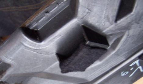

Post06-02-2008, 23:49    Subject: Knistern under Defrost-Ausströmer beim Passat 3C Quote
Poor quality, but maybe something meaningful can be found?
 3C

Post07-02-2008, 10:54    Subject: Knistern under Defrost-Ausströmer beim Passat 3C Quote
Thank you very much.
(Very similar to me: Climatronic, latte macchiato on cloth, manual transmission icon_wink.gif )
Unfortunately, the exact "problem area" is not very clear.
Do you have any more pictures?

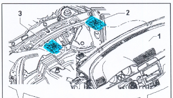

Post07-02-2008, 11:14    Subject: Knistern under Defrost-Ausströmer beim Passat 3C Quote
Here is a wanted photo of the currently suspected individual (number 2):

Post07-02-2008, 14:11    Subject: Knistern under Defrost-Ausströmer beim Passat 3C Quote
Unfortunately, nothing more found, sorry.

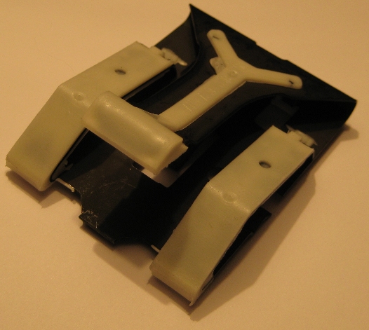

Post13-02-2008, 22:27    Subject: Knistern under Defrost-Ausströmer beim Passat 3C Quote

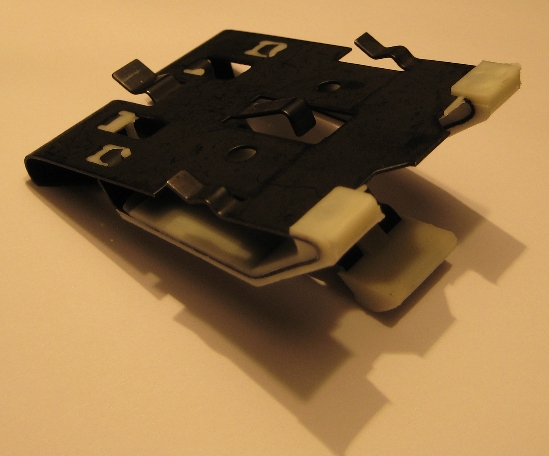

Who knows how these brackets are installed?
So, which claws reach where in?

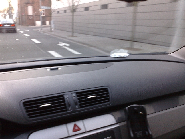

Post18-02-2008, 10:29    Subject: Knistern under Defrost-Ausströmer beim Passat 3C Quote
This thing is driving me crazy.
Now I've managed to wedge a piece of material between the disc and the control panel, and the rattling has stopped.
Now, with strong ground irregularities, it "knacks" to the LEFT! (but only much, much less often and slightly quieter). Nevertheless, you can sometimes simulate it by hitting the gear lever.

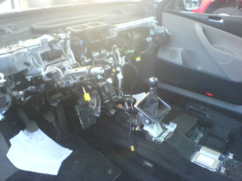

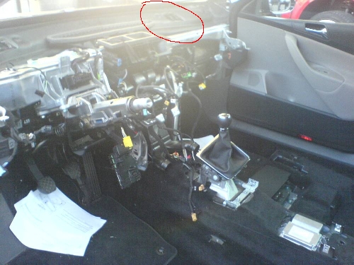

Post18-02-2008, 17:50    Subject: Knistern under Defrost-Ausströmer beim Passat 3C Quote
Okay.
Now I know what "it" looks like "down there".
So, es kann eigentlich nur die Klammer in der Karosse sein, oder?
