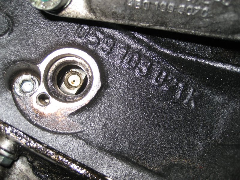

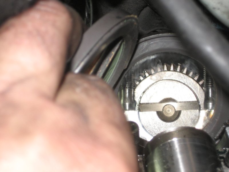

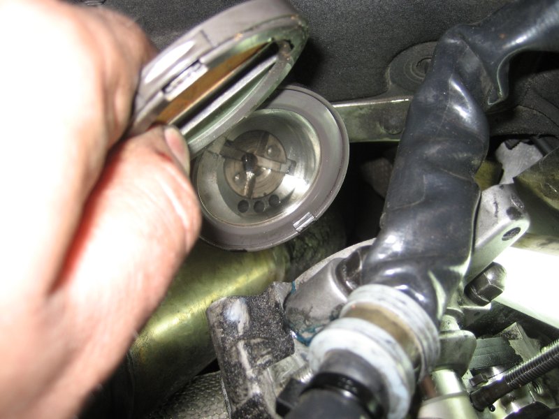

datsun
Guest
Post21-05-2008, 12:54    Subject: V6 TDI: Engine won't start after camshaft replacement? Quote
Thanks for your help.
This morning, when I started it, the engine was rotating exactly 350 degrees. Although I was sure it was more than 180 degrees yesterday (okay, that could be due to the throttle).
- The camshaft cannot be installed upside down because the teeth would then be facing the wrong direction.
- Currently, all the pistons are moving smoothly because they have likely never experienced any pressure buildup.
This morning, I:
- Everything has been disassembled, and the engine can be turned over.
- I installed the two main camshafts and the timing belt, and then I was able to turn the engine over.
- Then, I installed the three camshafts (skipping the first cylinder), and again, it only reached 350 degrees.
- Then remove that notch again. > Is the problem still the same?
Here's what it looks like when everything is set to 'OT' (see the pictures).
Could it be that one or more valves are misaligned and sometimes get stuck in the open position?
During the initial assembly, I strangely could only rotate it 10 degrees. After that, I reassembled everything. And then I encountered my current problem.

Post21-05-2008, 14:54    Subject: V6 TDI: Engine won't start after camshaft replacement? Quote
If you are absolutely certain that the timing is correct, then the only possibilities are that you either swapped the camshafts or didn't position the camshaft at Top Dead Center (TDC) during reassembly. This means that after removing the old camshaft, you installed the new one into the head and then tightened the bearing caps to guide the camshaft. If the lobe is misaligned at this point, you might be pushing the valve down at the exact moment when the piston is at TDC. You must pay attention to the alignment of the slot in the camshaft lobe with the alignment tool when installing it. Conclusion: the valve is bent. I rule out the possibility that you were trying to turn the engine over while the gear was engaged.
Do you notice any compression on the cylinders when you turn over the engine now?
