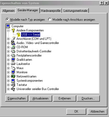

Post02-07-2008, 15:11    Subject: USB Drivers for HEX-COM+CAN (W98) Broken:-( Quote
Rainer K. wrote:
You need to either remove the USB-Serial driver in Device Manager
. Hmm, and which one exactly should I delete (see attachment)? None of them show any recognizable indication of Ross-Tech or similar in their properties.
BTW: The device manager on my home PC (also running Windows 98SE) shows the exact same drivers as the one you clicked on, and the Hex-Com CAN interface has never been plugged into it.
If you want to continue using the USB serial device, you must specify the driver directory as the location where the archive was extracted.
or use the Ross-Tech Direct driver with the files mentioned above.
Is that the RT-USB.dll file that was mentioned?
But how do I manually bind it under W98SE?

Posts: 18135
Post02-07-2008, 15:34    Subject: USB Drivers for HEX-COM+CAN (W98) Broken:-( Quote
Hi Ulf,
You will only see the diagnostic cable in the Device Manager if it is also connected.
Is this the aforementioned RT-USB.dll file?
Yes.
Plug in the cable, then right-click on the device icon in Device Manager, select "Properties," and choose the driver.
The items in your picture are "normal" and are part of PC hardware.
Translated on 09-09-2026, 16:50.

Post02-07-2008, 16:25    Subject: USB Drivers for HEX-COM+CAN (W98) Broken:-( Quote
EDIT
Rainer K. wrote:
In the Device Manager, you only see the diagnostic cable if it is also plugged in.
This works for other USB components, but it doesn't work (anymore) with the Hex-CAN: the Device Manager remains unchanged, regardless of whether the ignition is on or off.
I've temporarily installed the 8050 software on my home PC as well: at least this way, the Hex-CAN is displayed as a yellow question mark -> attachment.
Plug in the cable, then right-click on the device icon in Device Manager, select Properties, and choose the driver.
If that doesn't work: After correctly specifying the installation directory (on the home PC), you still get the message "no driver for the device could be found."
In the Lappi device manager, I can no longer find the (plugged-in) Hex-CAN device icon_evil.gif.
And now? Did I damage the interface by abruptly shutting down the laptop (and if so, why did it survive multiple times before)?
But as I said: something is still alive in there, because when you plug it in, the driver search starts immediately icon_eek.gif.
 So sieht es direkt nach der erstmaligen 8050-Installation auf meinem Heim-PC aus. Im Lappi kriege nicht mal das gelbe "?" zu sehen.
 File size:  11.99 KB
 Viewed:  4208 times
Translated on 09-09-2026, 16:52.
Posts: 18135
Post02-07-2008, 17:38    Subject: USB Drivers for HEX-COM+CAN (W98) Broken:-( Quote
*g*
The yellow question mark indicates the HEX-USB+CAN. Please also open the list of USB devices at the bottom.
It's best to remove the serial port setting at the top and then install the correct driver by right-clicking, going to "Properties," and selecting "Install another driver." Before doing this, select the device you want to modify by left-clicking on it.
I meant connecting the diagnostic cable to the PC, not to the car.
Translated on 09-09-2026, 16:54.

Post02-07-2008, 18:40    Subject: USB Drivers for HEX-COM+CAN (W98) Broken:-( Quote
Rainer K. wrote:
Bitte auch mal unten bei den USB Geräten aufklappen . . . Mit 'anstecken' meinte ich das Diagnosekabel am PC anstecken, nicht am Auto.
Und genau dabei tut sich nix, wenn ich das Hex-CAN ans Lappi stĂśpsele: ich sehe nur die 4 normalen Treiber wie oben im 1. Adepicted.
To install the correct driver, right-click on the device, go to Properties, and then select "Install another driver." Before doing this, select the device you want to modify by left-clicking on it.
If I cannot do this for the reasons mentioned above: The Hex-CAN device does not appear anywhere in the laptop's Device Manager.
Sorry that the dialogue got so long; I hope I managed to convey the message.

Posts: 18135
Post02-07-2008, 19:00    Subject: USB Drivers for HEX-COM+CAN (W98) Broken:-( Quote
Hi Ulf,
Call me; I'll send you my number via private message.
[Edit] It appears that the diagnostic cable is faulty. [/Edit]
